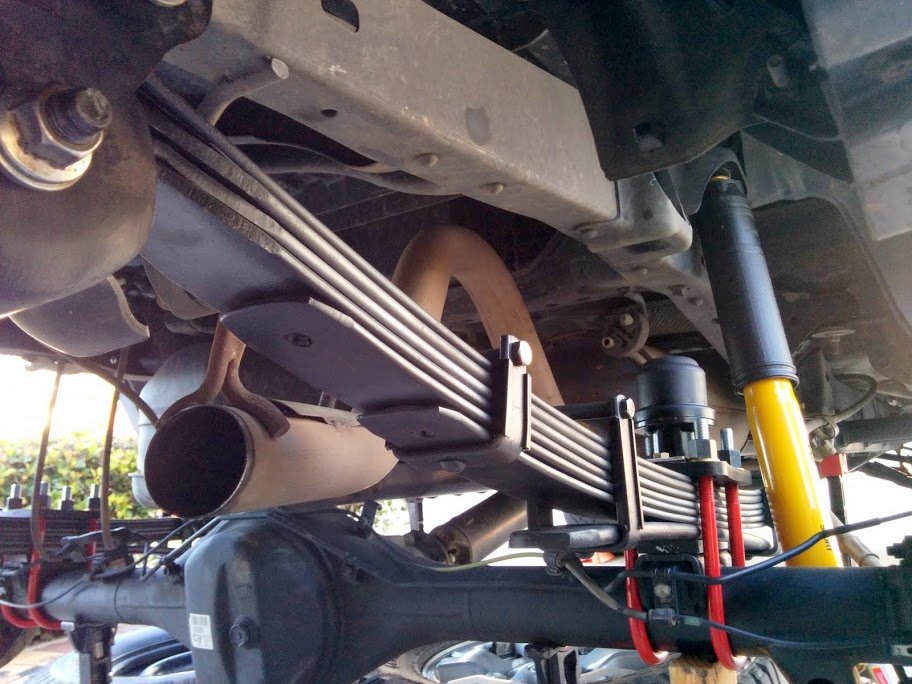

    Thanks Brock. Thanks for chiming in. I don't want bumpstop nightmares. lol
    I'm gonna have to be careful with my setup. I assembled my own leaf pack. So I think no matter what, I'm gonna have to do the disconnect shock, measure droop and compression bit.
    This is an old pic from my install day. Dakar leaf pack with D29XL AAL, but overload removed and a 3* axle shim.

    . Yeah....... I tested them a long ass time ago per Marco and Sonny suggested. I had tons of droop, and the truck used this droop up off-road and drove like a freaking caddy over bumps on road too.
    Problem was I woulda bottomed out the shock wayyyyyyyy before I got close to the stops..... Like a good 2"!
    The uptravel was shit with my..... Tsb pack, icon progressive pack, minus overload. I'd seriously have to weld a strike pad on the frame about two inches tall.
    But the ride was cush...... Till I did bottom out one day it sucked balls and was just a lil ditch.
    Truth be told, the stock dampers are too short for a stock truck even.... I'm surprised more ppl don't get the top out "clunk" bone stock.
    Throw in the tsb pack, and its totally fubar.... Marco even agreed back in the day when he was at dsm

    But if you relocated the shock tower you could avoid bottoming out and not have to get big ass bumpstops

    Who's u-bolt flip 'kit' is that? I need some new ubolts - I think I will be visiting Deaver but at $20 a pop...

    That's the all-pro with timbrens, expensive stuff

    Correction. Crom's picture appears to have All-Pro U-Bolt Flip Kit with Wheelers SuperBumps.
    TheTacoma and Crom like this.

    Those are All-Pro and I painted them red. They're made with 9/16" rod. They're stout and I like them a lot. Yeah the bumps are Wheelers super bumps. I hated to pay so much for bump stops, but they really are worth it.
