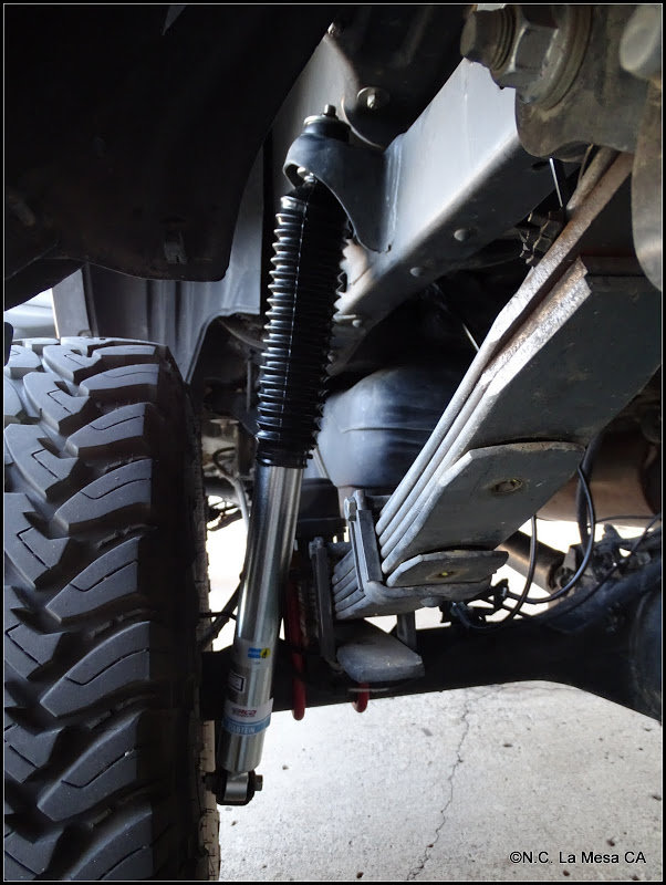

    After winning the war with extended brake lines, I put in some 5100 B110 yesterday. I gained 3" of wheel travel.
    Rear end feels better already just driving around town.

    I'm cross posting this from my build thread. Just went through the full exercise yesterday.
    New Silver Bilstein RCD/BE5-B110-T5
    • Monotube, High Pressure gas shock
    • Extended Length: 27.28"
    • Collapsed Length: 16.34"
    What do these extended and collapsed lengths really mean? The devil is in the details and I could not find them so I broke out a tape measure and started measuring.
    I disconnected the shock, to let it fully expand and put a tape measure on it.
    It is exactly 27.28" as measured from the center of the shock eye mount to just under the lower frame bushing washer. This is critical information for me.
    A different view of the same picture above.
    Then for fun (not really fun, shock is hard to compress), I measured the collapsed profile. That's my foot holding the piston rod in while I measured.
    It's true it will go to 16.34" as measured from eye to lower frame bushing washer.
    Next I reinstalled the shock into it's home on the frame and torqued everything to spec.
    Next I carefully measured the length of the shock at static ride height as pictured above and got 21.75"
    Then I proceeded to measure my Wheeler's Super Bumps.
    Now putting all the critical information together.
    It is unknown how much the super bump will actually compress under dynamic applications like a hard impact. The bump stop is polyurethane and it is dynamic, it's not a hard rubber stop like the Toyota Factory one. So I'll have to make an educated guess. I'm going to say that the super bump can compress all the way down to 1" tall. So looking at the pic above, that would mean up-travel of 5". Let's make that number negative 5".
    Now lets do the math.
    21.75" Shock length at ride height.
    -5.00" Five inches max up-travel (my best guess)
    _________
    16.75" Compressed shock length.
    One more math operation to arrive at the margin of safety.
    -16.34" MAX COLLAPSED LENGTH AS MEASURED AND ACCORDING TO MANUFACTURE SPECS
    _________
    0.41" Margin of safety.
    That's cutting it close. I may add a 1/4" or 3/8" bump spacer just to be on the safe side.
