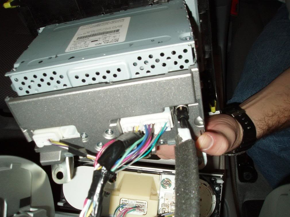

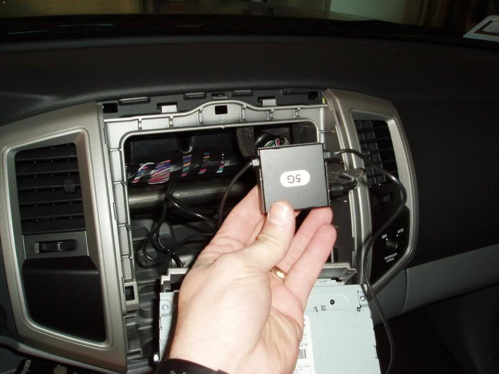

    2) Here's a photo of behind the OEM stereo:

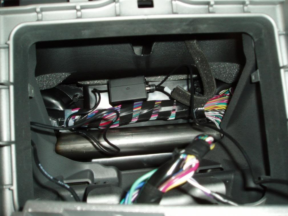

    I attached the relay to the antenna socket and re-attached the antenna cable to the relay.
    I tucked the relay between the electrical harness and the top of the head body.

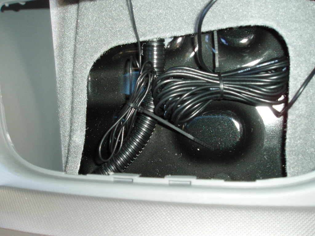

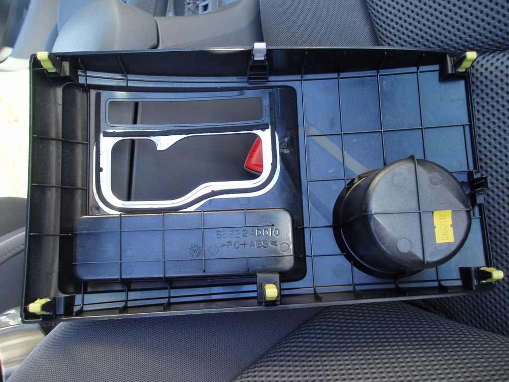

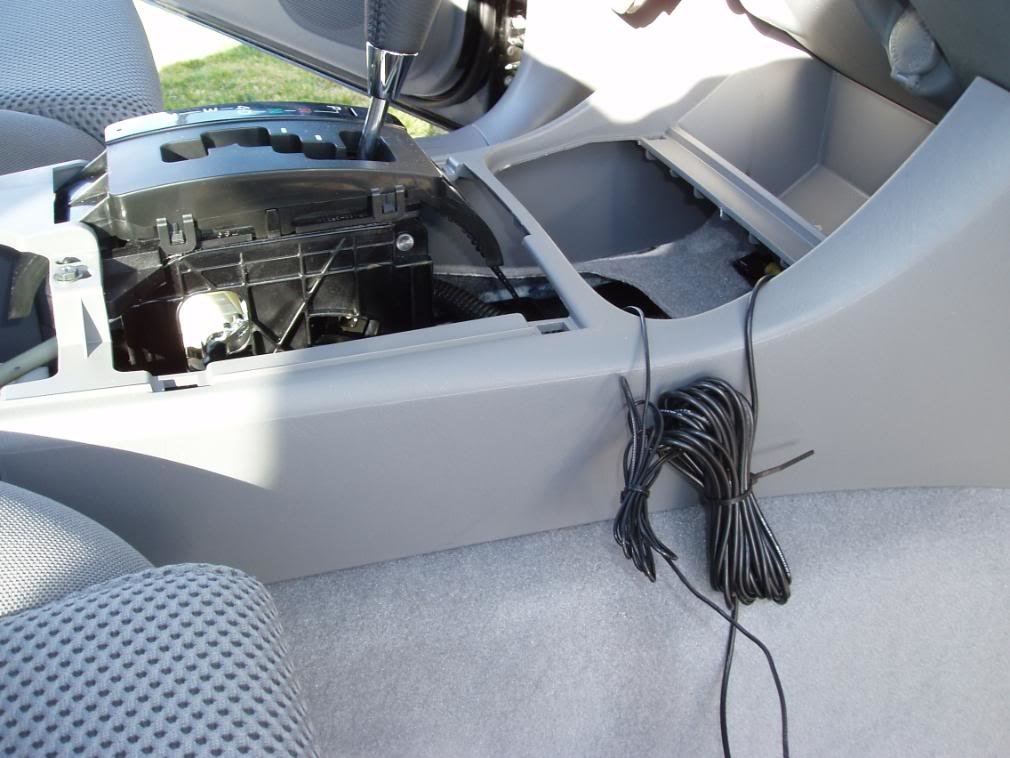

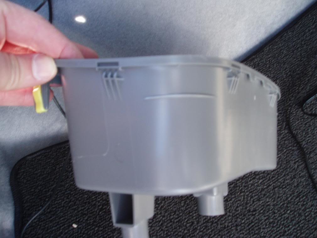

    4) I pulled off the shift cover (same friction clips), zip-tied the rolled up excess cable/wire

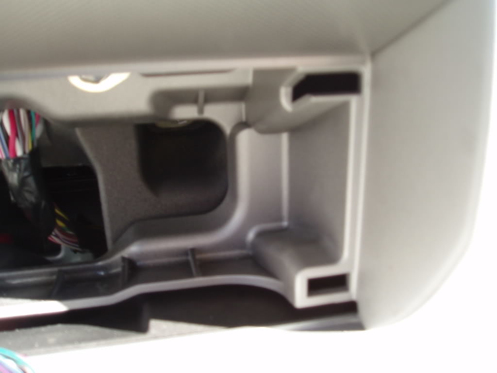

    5) I tucked the excess cable/wire under the cup hold. The cup hold has molded-in clips that need to have their tabs depressed to remove. The only way to easily access these is from the removed shift cover.

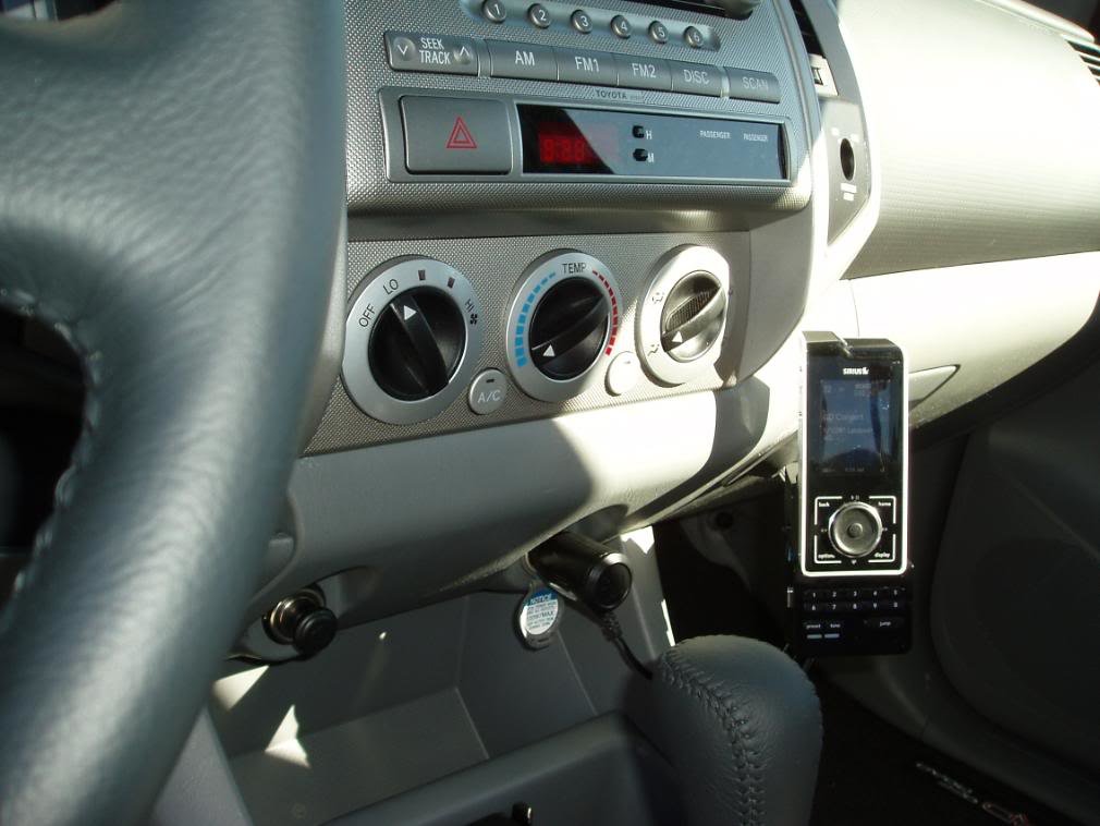

    6) Final Install.
    The power/FM/antenna wires are exposed from under the shift console side to the Stiletto. Hiding these in a cleaner install is my next project. There's no real clean location to pull these from/through. I'm thinking about cutting a small hole to run these through.
    Does anyone have any experience or advise on this?
    I'm happy with the overall install. I like the Stiletto car dock and how it can be adjusted for optimum viewing. The relay works really well. While the Stiletto is powered up, it "blocks" ALL FM reception and redirects the FM modulator signal to the tuned frequency. I'm in Southern California, where EVERY frequency is used and most stations are pumpuing out enough wattage to blead over into the adjacent frequencies. I can tune my Stiletto to the strongest local FM station and the relay will totally block the signall for static free, CD quality sound from my Stiletto.
    Success!

    1) The relay:

    3) Shot of the underside of the shift cover:
    4) A shot of the excess wire under the cup holder:
