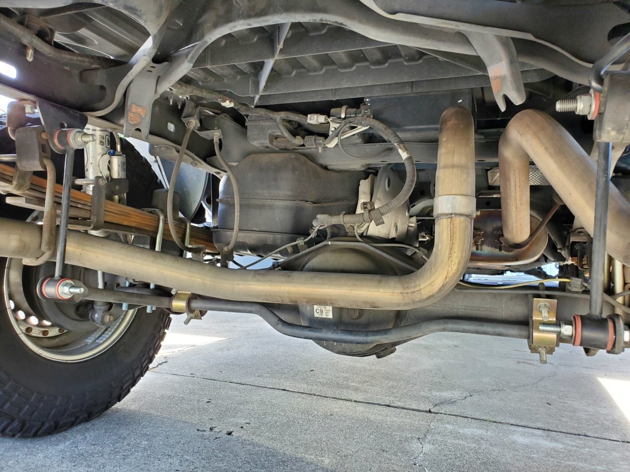

    Hey Eddie. How do you like this setup?
    I'm not sure why I haven't considered doing something like this until now. I had the TRD rear bar on my dropped 08 Tundra and it made a massive difference in how that pig handled. My 4x4 Taco isn't lowered, but, I'd imagine that would still benefit from something like this in the turns. I do worry a bit about low traction situations (rain) tho. Is the truck tail happy now?
    I see that you may not be able to answer me on this since you've done a dual exhaust setup. What about the exhaust? Do you think the end links would contact the TRD catback ?
    There's a local guy that has a Hellwig kit up for sale. He's only asking $200. Hmmm. I do like the idea of using an OE bar tho. Gonna cost me a bit more to go that route tho. That, and I will still need to powder coat it and the end links red too. Coz racetruck.
