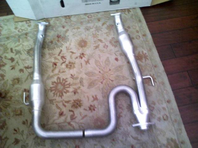

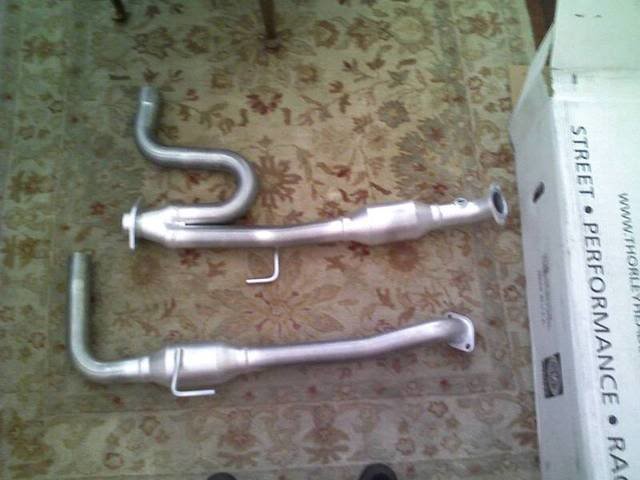

    heres pics of it before installation
    PIC-0120_77f49d36316f907d44cc421178fd62e34a56743e.jpg">PIC-0120_77f49d36316f907d44cc421178fd62e34a56743e.jpg
    PIC-0119_e9b0c40892f00eba25e09a12f2e028f3005776ee.jpg">PIC-0119_e9b0c40892f00eba25e09a12f2e028f3005776ee.jpg
