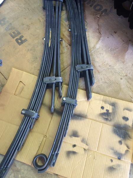

    So, I pulled the trigger a few weeks ago on the new OME Dakar part number leaf springs. I haven't seen anything about the new part number on here yet, so I though I would share a few of my experiences with the leafs and the install...the new OME part number is EL095R :thumbsup:
    I ordered mine from LowRange (https://www.lowrangeoffroad.com/catalogsearch/result/?q=el095). Since I couldn't find the new part number on TW anywhere, I called ARB USA HQs and to get the new part number for the ones with the isolators on each leaf end and also between each support leaf in the center of the pack (but I noticed there aren't isolators between the overloads). He told me it's the same as the old part number (CS047R IIRC), just with the isolators. Then I searched all of the usual Dakar vendors and LowRange was the only one at the time that showed them on their website--so I went with them. They we're drop shipped direct from ARB to the house earlier this week.
    The first thing I noticed was that the paint was really flaking off the brackets that keep the leafs aligned...not a show stopper, but a little disappointed. There was no packaging on them, so I'm not sure if it was bad paint on the smooth metal or if they were just tossed around in shipping. I'll just shoot them with a little self etching primer and paint sometime down the road :rolleyes:.
    After devoting every free minute of my already busy life to reading a gajillion TW posts on the old part number (thanks for all of the leg work @OZ-T ), I just KNEW that I'd end up at 24"+ center of hub to fender if I went with the full pack (DCSB 4x4 with a Leer Camper and a Bed Slide so probably 200-250ish lbs in back). I really wanted to be around 1" of rake since I'm running 885s upfront with an ARB bumper (no winch) that settled in around 22.25 to 22.5 in the front. I loved the plush ride of my old Skyjackers, but after going to 885s, I wanted to go a little more in back (it was level with the Skyjackers).
    With the awesome help of my son @Unner :militarypress:we pulled the top overload expecting to be around 23.5" in back. We also installed the complete Energy Suspension bushing kit (both leaf eyes and the shackle). The shackle bushings were a pain to get out!!! I knew they were the two half bushings that insert from either side and working the metal flange seemed like the best way to get them out. I know a lot of people beat the rubber part out and then cut them, but I just had to try it differently. I did the first one with a 4lb mini sledge and chisel (combined with a lot of brute force and ignorance :D) and eventually it started moving and got it to pop out. Then my son said an air hammer would work great if we had one...then it struck me that we did have one in the air tool kit I bought years ago. :anonymous: . We stuck a chisel tip in it and it worked AWESOME! They came right out.
    Also, I always hated how the poly bushing kits give you those tiny tubes of special lube and it's only enough to do 1/2 of the job, so I ordered a tub (not tube) of the Energy Suspension lube for about $11 and was able to slather it on thick...well worth it! So after a couple hours of work and getting everything back together, we lowered it off the jack stands but hadn't driven it yet. I was torquing down the one leaf and my son grabbed the tape measure. It was actually sitting at 22.5 in the back before any settling!!! What the....:censored: My son has a crap-ton of off-road wrenching experience since he has a very capable 01 4Runner he built himself, but I did verify his measurements were correct :facepalm:. Yep, my new model Dakars with the top overload removed netted me exactly a WHOPPING QUARTER INCH!!!
    Since we already had everything already there, we did a partial disassembly on the truck, split the packs, reinstalled the overloads and center pins, reassembled, and put it back on the ground. Grabbed the tape measure and it's now at 23.5 in back...exactly where I wanted to be, but I never thought I would be there with the full Dakar pack. I honestly don't get it, but I'm happy with how they ride and that I did end up at my desired height with full load capacity.

    Were there + , - or 0 makings in the leafs and if so what were they ?
    And I believe the stock load refers to a pack that does not have the optional d29xl Dakar AAL

    Thanks Oz...makes sense about stock load. They're both + which is even more odd that they seem to be so low.
    I noticed that when it was on the ground without the top overload, that the regular springs were closed to touching the ends of the smaller overload. Weird that it gained back a full inch by putting the top overload back in...I didn't think it would change more than the thickness of the OL leaf.

    As I posted in the above thread....and I agree with the above, it seems like you got what amounts to the CS047R pack with the 3rd leaf removed.
    I just got a set of CS047R Dakars plus the d29xl aal from a local (good) dealership. The Dakars were the updated version with yellow puck style isolators on all leafs, no front OEM style bushing and also had the centre isolators. The d29xl was drilled and had isolators installed before I put them into the pack so I'm now running 6 leafs with 2 overloads. Honestly my Dakar pack looks nicer than ARB/OME's new product number Dakars.....glad I got the old style.
    Here is a crappy iPhone pic from after I finished installing the d29xl aal.

    When i look at the pictures of the springs you received, i count 4 main leaf springs, with 2 overload springs which make sense since they sent you the "standard load". The "heavy load" comes with 5 main leaf springs, and 2 overload springs which handles 300lbs (660kg) of constant load and will net 15mm higher ride height. The "heavy load" is what the older part number Dakars are set up as.
