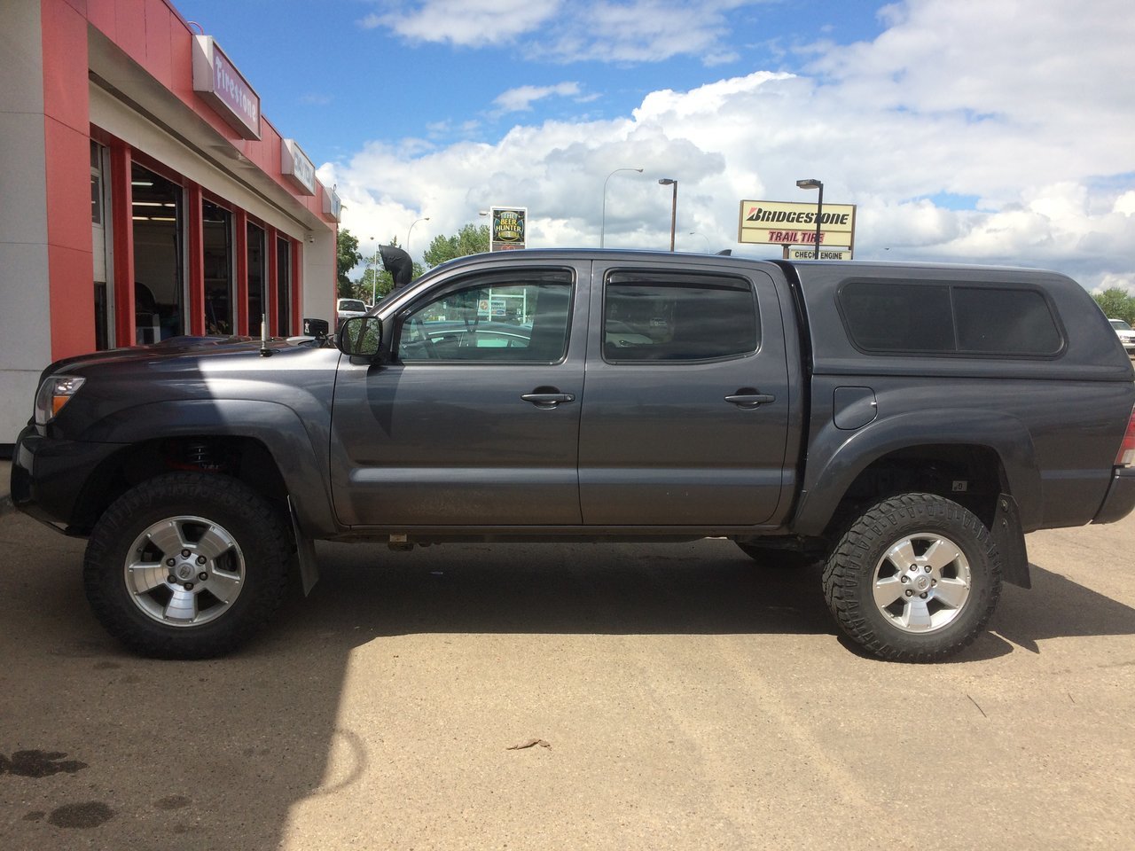

    Before
    After

    I was editing the post....after pic is there now.

    Thanks but it's not done yet. Damn these things take time and money to get set up. Full bumpers, winch, skids and sliders in a month.

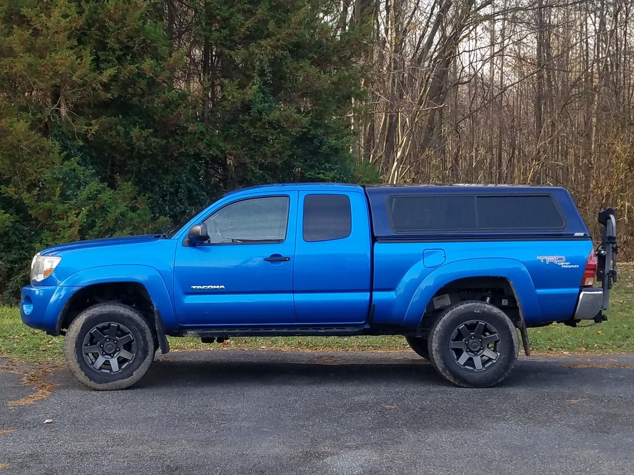

    20171112_150549.jpg I installed my EL095R springs. The ride is superior to stock IMHO. However, I have basic A.R.E. cap, Toyota rubber bed mat, and prefer to leave my Yakima hitch mounted bike rack on all the time. The truck seems to be right at level. The front has Billstein 5100s with stock springs on the highest lift setting. Fantastic ride!
    Update: About 3/4 inch higher at rear wheels than the front. Axel shims are installed, as well.
