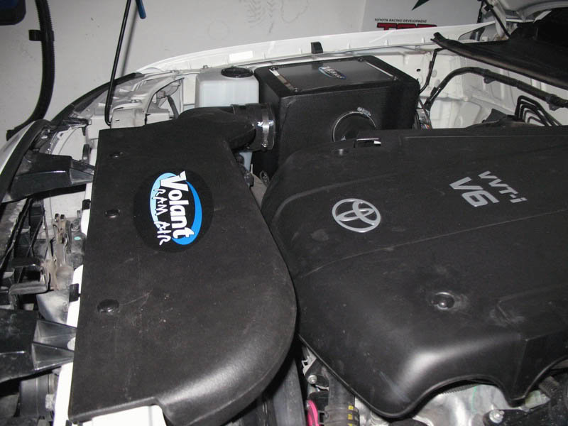

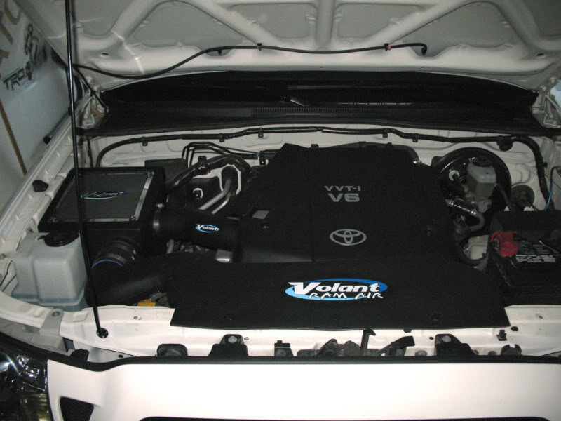

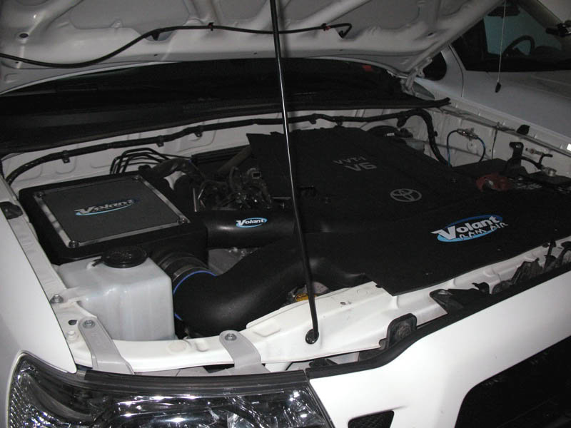

    I got the Volant intake installed the other night, that I bought from Joe B.
    it is pretty sweet
    love the sound it adds and the "seat of the pants" dyno is pleasantly surprized

    So that thing grabs air from the front of the truck?

    the throttle response is soooo much better.
    as in first post, the "seat of the pants" dyno thinks there is more there.
    on my scan gauge, it went from reading an intake air temp of 15 to 20 deg above actual outside temp, to 0 to 5 deg above actual outside temp.
    the night i installed it, i got an air temp of 33deg (it was 33 deg outside).
    because i can't keep my foot out of it, my mileage has dropped.
    it should, by definition, be running richer now. lower intake temp means denser air, thus more fuel pumped in by computer.
    i understand the running rich thing, but i have yet to see any hesitation problems or WOT issues. (just performs and sounds bad ass!).
    I also expect some sort of loss of MPG because of it running more rich
    I guess it would take another add-on, of sorts, to tune it??

    yes, right above radiator and a/c coil

    what kind of filter do these come with? paper, gauze, foam? thanks

    ^ just like the cone K&N (gauze)

    you can put just about any filter you want with a 3" flange and that will fit in box

    ^^ I was wondering about that. Thanks sockmonkey! One could probably get a foam XDI filter in there.
