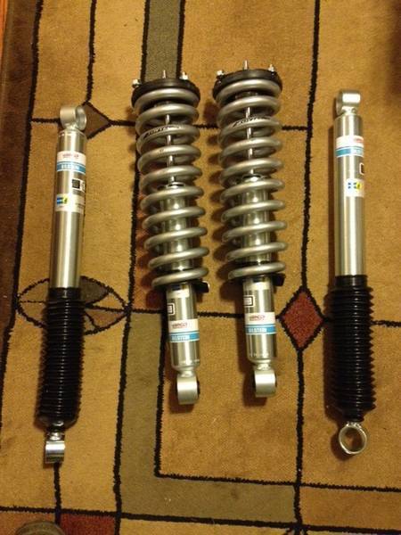

    I just got off the phone with Wheelers Off Road (extremely helpful btw) and I've settled on this set up: I'd like to think I'm pretty mechanically inclined but I'd like to find someone who has experience doing this to help me out. My thought is to find someone with all the tools and garage space to help me out on a weekend and I'll throw them a few bucks. Or if there is a reputable shop that's not going to charge me an arm and a leg?

    I know I said OME kit in the original post but I settled on a complete Toytec lift with Bilstein 5100s all the way around and Dakar leaf pack in the back. It also came with a diff drop so that will be a learning experience for me.

    Here's everything that came with my lift. I think the BPV-K at the bottom of the first page is what you're referring to. Thanks for the heads up.

    Took us a little longer than expected. Naturally since the coil spring assembly was already together, the fronts went extremely smooth.
    Ran into some issues with the front leaf spring hanger bolts. They were frozen solid/fused to the insert tube. Eventually had to cut both sides off with a cutoff wheel.
    Was NOT very fun and very time consuming.
    We pushed forward, torqued every single nut and bolt to spec and it turned out steller!
    Hopefully Veg Hed will get some pics up soon.
