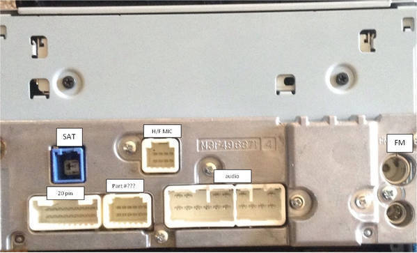

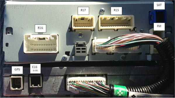

    2012 non-jbl (missing info on plug next to 20pin connector- msg me if you know it)
    2012 jbl

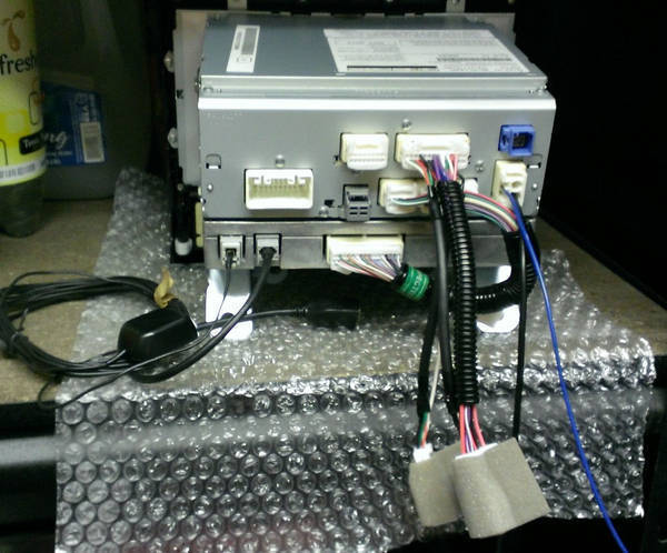

    waiting on correct terminals for the amplifier plugs then i can start the install but here is the back of the jbl unit
    you can see the radio adapter (i will remove the blue power antenna lead) and the usb adapter and the gps antenna along with the scion 20 + 8 pin to 28 pin harness

    plug and play wiring harness is complete
    this end plugs into the headunit r16
    and the non-jbl factory female connectors mate to the new harness male connector (metra kit) - the white wire is 14 gauge power to the amp and i am still trying to see if i can wire it to the factory 'radio 2' 30 amp circuit
    this end plugs into the jbl amplifier and sub (also a ground)
    now onto the test!
