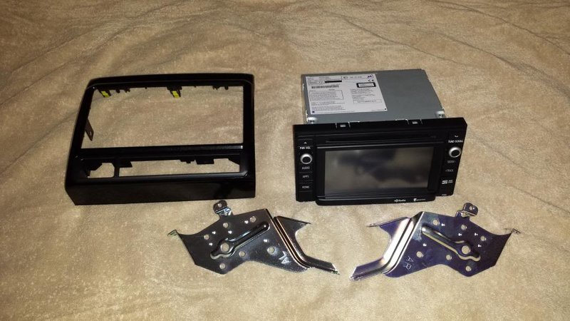

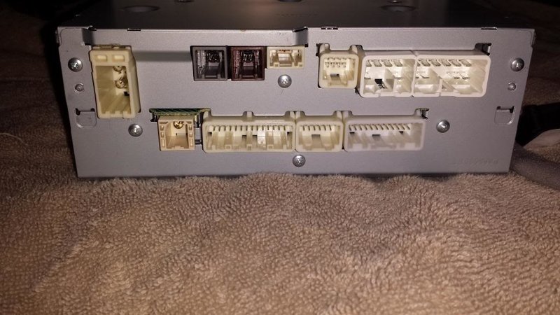

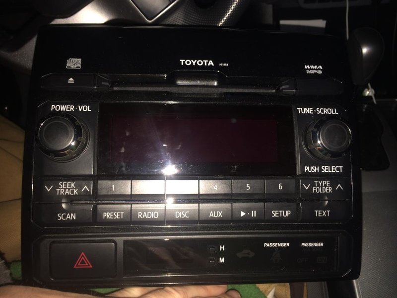

    I have a 2012 Tacoma with a stock radio. Non touchscreen non JBL. Can I get this 2014 navigation unit to work? Everything matches up with the exception of the 2 plugs on the left (blue plug and 20 pin) and antenna? The 2014 unit has a 28 pin? connection that my 20 pin 2012 wont fit. It looks like the blue plug is for the shark fin? It doesn't fit the 2014 unit (too large) but it looks like if I cut away at the plastic I can get it to work. Can I get some kind of adapter? I know they make em for the antenna. Any help would be appreciated. THANKS

    Just get this harness 28 pin harness adapter - PT546-00120-CH
    I have a 2014 nav in my 2012

    Will I need this whole kit PT546-00142 or just the 28 pin harness adapter PT546-00120-CH?

    The only thing I needed for mine was the 28 pin adapter harness and antenna adapter.
