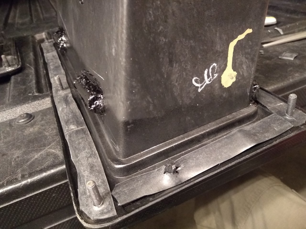

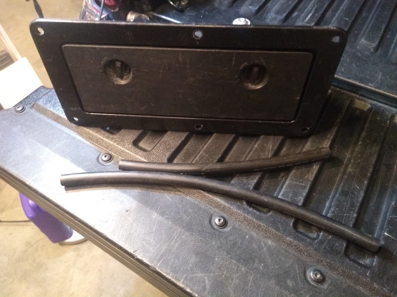

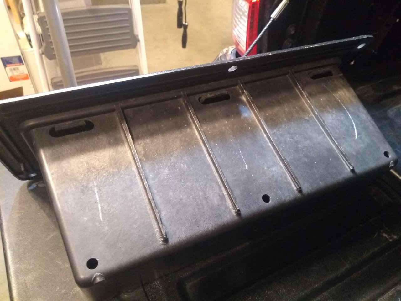

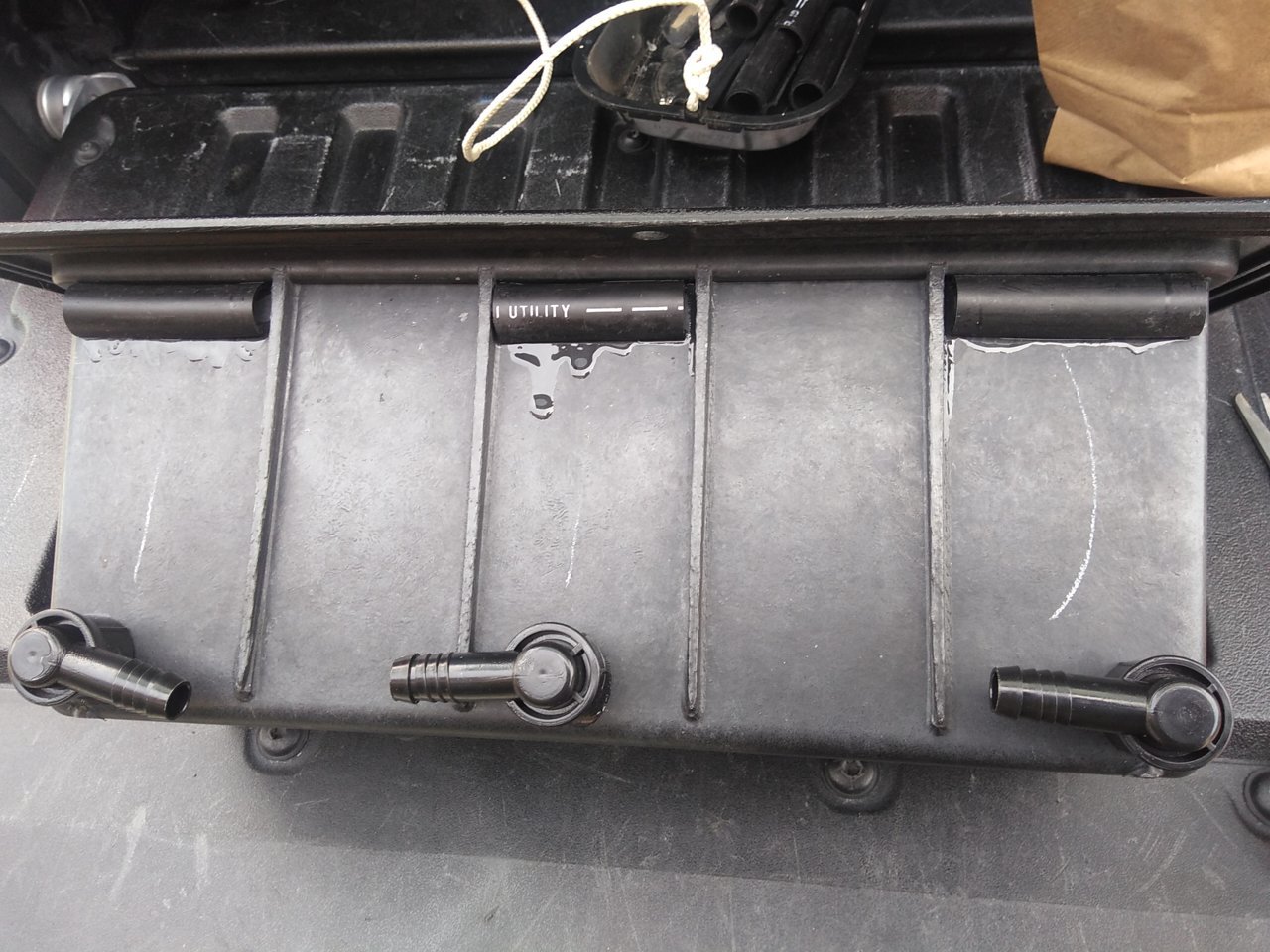

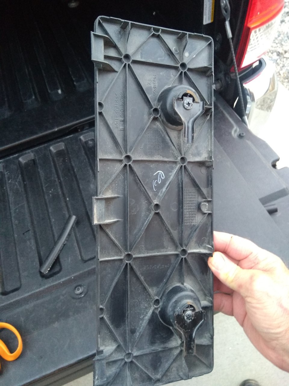

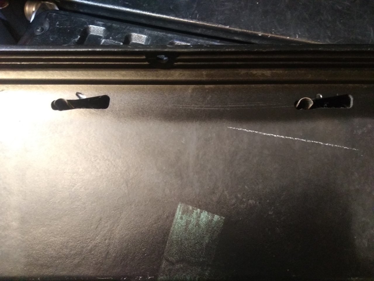

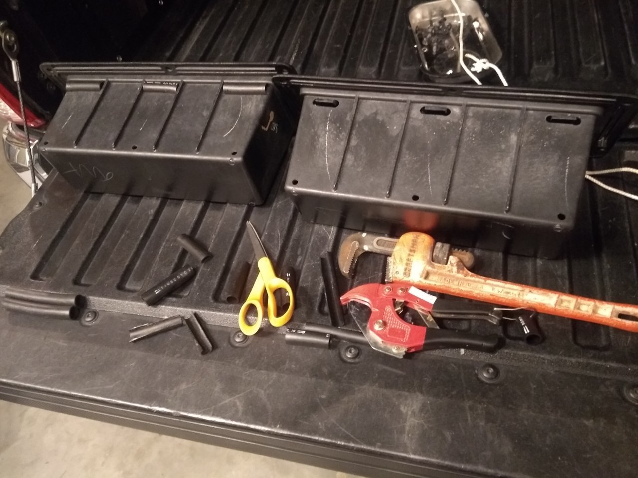

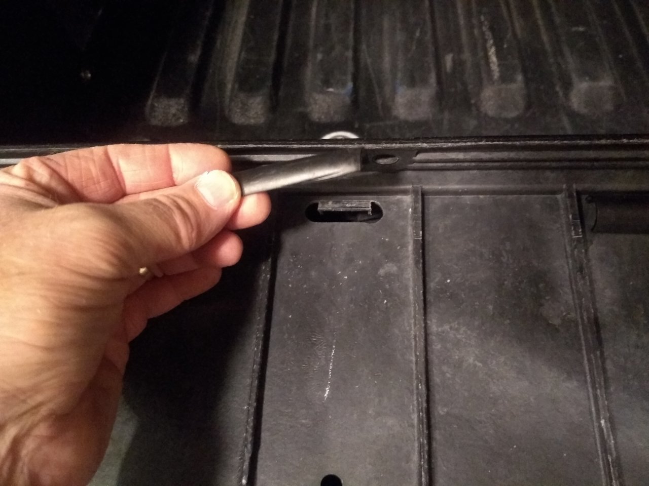

    side storage 1.jpg side storage box 0.jpg side storage 2.jpg side storage box 3.jpg side storage box 4.jpg side storage box 6.jpg side storage box 9.jpg side storage box 10.jpg side storage 1.jpg side storage box 0.jpg side storage 2.jpg side storage box 3.jpg side storage box 4.jpg side storage box 6.jpg side storage box 9.jpg side storage box 10.jpg I have searched to find modifications to the built-in rear storage boxes in certain gen 3 Tacos. I just got this truck in September 2017, and soon after cleaning all the dirt out of them and off-roading just a little bit; they soon filled with dusty dirt again. I had written them off as viable storage for anything I cared about until I discovered a way to keep out that dust and dirt.
    The main problem is the large tab openings and drain ports. They're too big and have no covers or cups around them that help keep dirt out. You can see daylight from the openings and 3 drain holes in the bottoms. So, I covered them using black half-inch black poly pipe pieces that have been cut with scissors lengthwise; long enough to cover the holes with room enough to seal the end holes left behind with caulking. These form a cup for the tabs.
    The six bolts are torx T-30s. Remove them; and pull the boxes and clean them; and use super glue to attach pieces of the pipe over the openings to hold them in place. The ends of the pipe should extend about a half inch or so past the openings. They should be long enough to allow for some caulking to plug the end holes. The cheap poly pipe was 85 cents from a scrap bin at my local plumbing supply.
    The 90° female black pipe ends were 65 cents apiece. I bought 9 of them. 3side storage box 10.jpg side storage box 9.jpg side storage box 6.jpg for the two boxes, and 3 for the drains in the bed. My thought process is that I do not want to block the drains, as water drainage is important; but those simple openings as they are seem to attract dirt and dust like they were. Simply adding a 90° turn to its path, it should reduce the amount of dirt entering the storage boxes. The openings for the tabs are too big, and needed cups around them to protect against dirt and dust. The pipe pieces make the cups for the plastic door tabs. I used some roof cement that I had on hand to use as sealant around the tube tab "cups", but this isn't the perfect choice as it took a long time to harden. Latex or silicone caulking or sealant would probably be ideal and could be smoothed to look nicer. I finished the job by using a bike tire inner tube cut into pieces to make a gasket around the flat edges of the box. I will likely put some vinyl thread protector caps over the ends of the pipe to help protect against any more transference of dirt from the outside world, but they are easily removed to aid in drainage. I glued 3 each 90° elbows to the bottom of the bed over the drains with their openings facing toward the rear. I used the roof cement and some pieces of packing tape to hold them in place to allow them to harden without falling off.
    If there is a better way to help these boxes stay tidy and clean, I'd like to know about it. Feel free to ask questions or comment. I know it looks a bit crappy with the roof cement; but that is all I had on hand, and it was from a tube that had dried, so I cut it open and used a long screw to dip into it and apply it around the edges of the pieces of pipe to seal them and help hold them in place. side storage 1.jpg side storage box 0.jpg side storage 1.jpg side storage box 0.jpg side storage 2.jpg side storage box 6.jpg side storage box 4.jpg
    Caliph420[OP] likes this.
