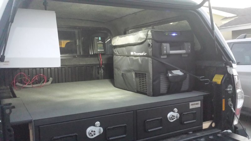

    My 50 Qt ARB fridge/freezer is bolted onto my plywood bed base.
    There's a 2 AWG cable that supplies power from my auxiliary Optima Yellow Top mounted in my engine bay. 12v Power is supplied to the ARB fridge, bedrail mounted ARB twin compressor and a 12v Electric Fan.
    I replaced the cigarette plug on the ARB Fridge with a generic 50A "Anderson" type connector for positive engagement. I didn't want all my perishables ruined in the middle of nowhere because the cigarette plug worked itself loose. Also protected by a 15 AMP in-line ATC fuse.
