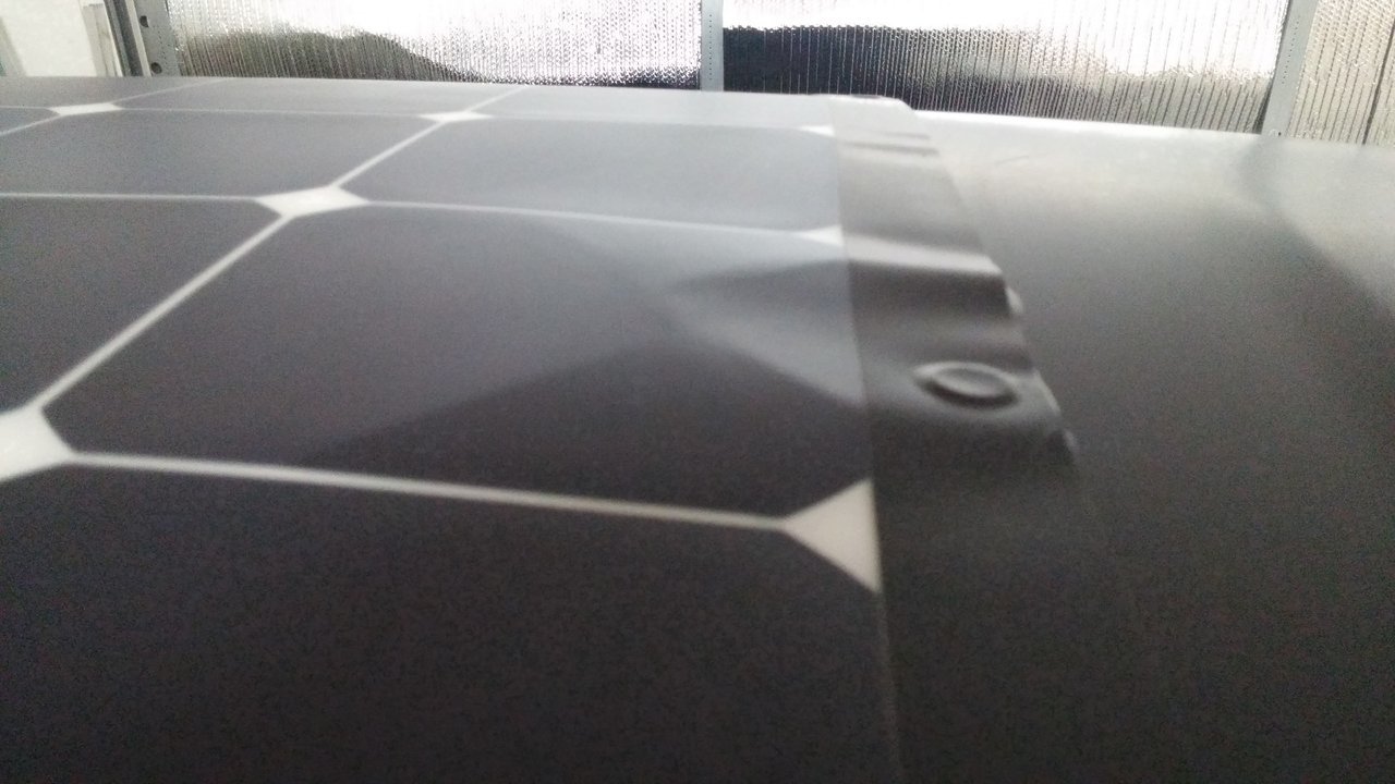

    -Wrapped roof with Matte black due to massive amount of clear coat peeling (horrible/impatient job but better than flaky white clear coat)
    -Double stick taped the panel to roof (used extra matte vinyl to cover the bright white border of the panel)

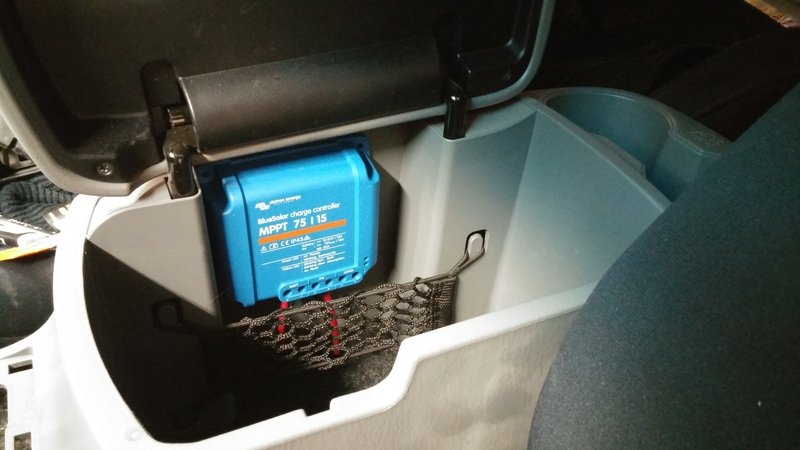

    -Mounted charge controller in console, using existing holes at bottom of console to run wires

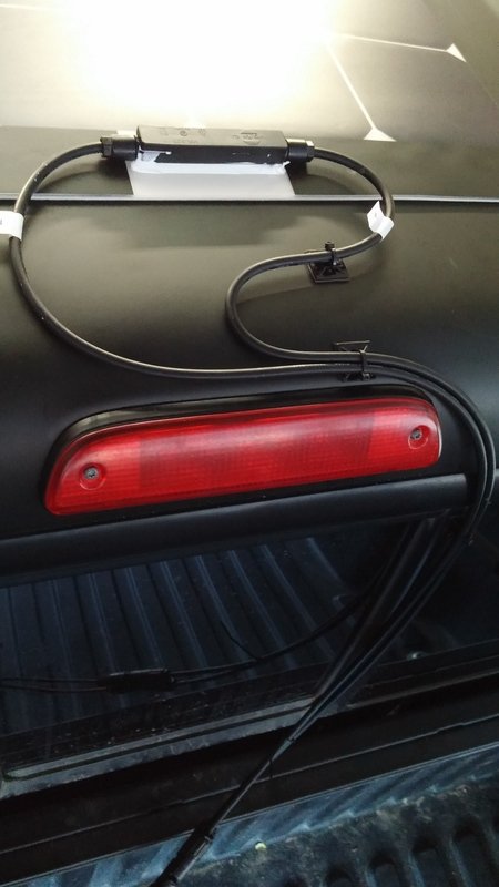

    -Ran wires through firewall to battery and through parking brake grommet to solar panel connected under rear window.

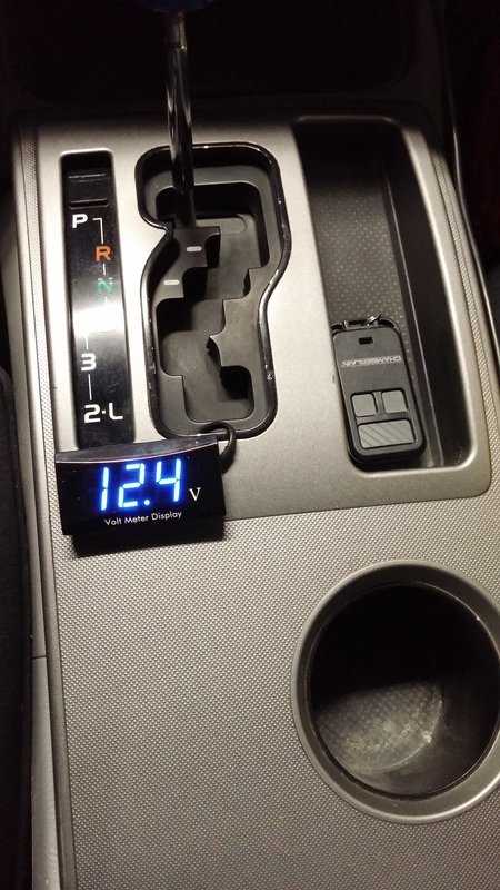

    -Connected a cheap LED volt meter to the output port of the charge controller.

    -Junction box for solar connection
    -Clean up external solar wire routes
    -Add extra cig lighter or USB ports

    First sun exposure, right after pulling out of the garage, battery voltage slowly went up to about 12.9 volts before i left. After a drive to my buddies place, alternator voltage was about 13.7 volts and solar picked up right from there when i turned the truck off. Voltage got to about 14.1 volts in all the suns glory. Later in the day, when the sun was getting pretty low, voltage was still up towards 12.8.
    UPDATE 02/26/2017
    I've had this setup out in the sun multiple times so far. Even in heavy rain, some snow, 80* temp and numerous mud puddles. Due to the forced manual warping of the solar panel to conform to the roof contour, its pulled up a few ripples, taking the wrap with it. Some spots of the tape appear to be separating but the gap is soo small, i would need a very thin feeler gauge to get under it. Looks to be OK for the time being.
    I have noticed that my battery is holding more voltage recently. Pre-Solar, I was usually about 12.3-12.4v after a drive. Now i'll be sitting in my garage at 12.5-12.7v. Outside, i'm anywhere from 12.8-14.1v depending on sun. I can get elevated voltage with cloudy weather and even after sunset. Volt meter was also rewired to read actual battery voltage and not solar output.

    Left the truck outside for a week in the 110+ weather and the tape is still holding. No additional lifting/peeling was found. I did however notice creases formed on a couple of the solar cells that were rippled before. I added a picture below. Performance hasn't changed as far as I can tell. I do think my fridge overheated though. 117 degrees (we tied the record) is probably 180-200 in the truck, plus the heat coming off the compressor. It was showing 70 degrees one day when I checked. Fired the truck up and she kicked back on. Battery voltage kept above 12.4v.

    Solar panel after a week in record breaking temps. Warping was from initial install. Creases appeared recently.
