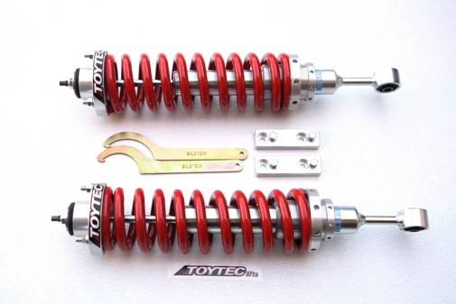

    Ok, now I'm confused... Does this not come already assembled from ToyTec so that I can just remove the stock and replace it with these?
    ToyTec's website also says these are adjustable.
    And from the Tacoma Lift FAQ/Guide:
    Coilover lift kit: $1050.00 Free s/h
    (DR Coilovers) Most common. Others are available such as Sway-A-way, Fabtech, All Pro, and Camburg to name a few?
    These are the high end of the 3" lifts. Extremely easy to install, due to the fact they come already assembled. It is simply a matter of remove and replace. They are also very versatile, in that they are adjustable. Therefore can be adjusted to fit your needs.
    As far as having my tires stick out, this is really what I wanted (minus having to buy new tires). I thought getting the wheel spacers might let me get there...
    Maybe saying "1 to 2 inches" was me not knowing what I was talking about. :) The picture above doesn't really look like 2 inches.

    Those do come pre assembled. Im sure she was meaning spring kits, and spacer kits.

    Thanks! Any thoughts on the other questions?1. Any difference between the preassembled coilovers and the struts/coils purchased separately and assembled myself? ($200 price difference...)
    2. Just an "unbolt the old, bolt on the new" front lift with the assembled coilover strut assembly?
    3. What are spanner wrenches and swaybar relocators?

    Coilovers are generally valved for the spring rate, and the vehicle for wich they are made. They are rebuildable, and adjustable. You just remove the old, and replace with the new. Easy as pie! :)
    Spanner wrench is a tool used to adjust the coilover.
    If you lift the front 3" with the TSB springs, the front will be about 1/2" higher than the rear.

    MyToyTaco
    MyToyTaco ╒╪╕
    Sep 23, 2008
    #9417
    4,385
    Nick
    wenatchee, wa
    09 DCLB 4x4
    It's a pretty easy job. Me and a friend lifted my truck over this past weekend. We installed Toytec coils / 5100s, and rear AAL. Just take your time and double check everything
