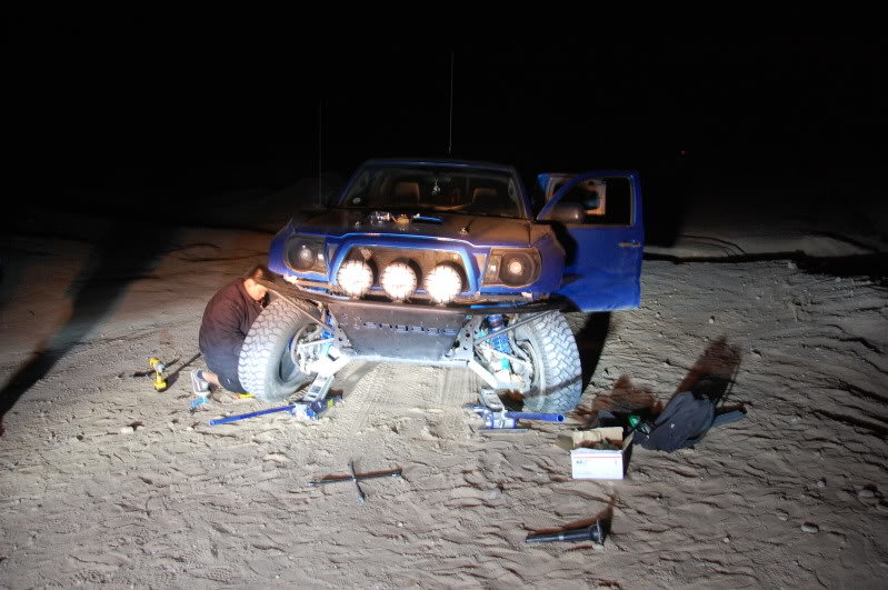

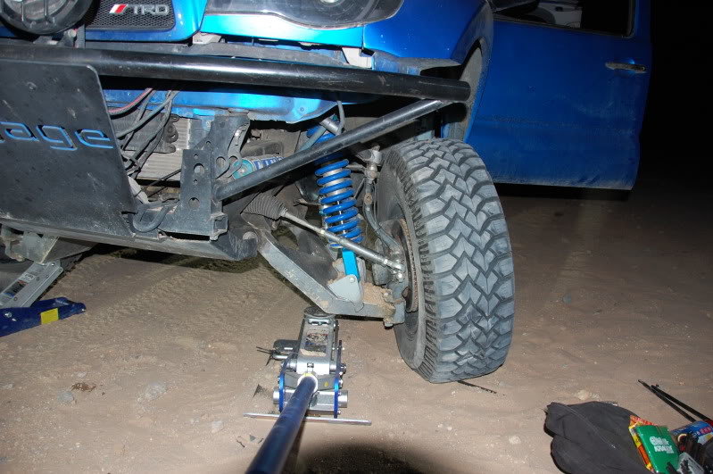

    In the end, it's your truck and your time/money. You can certainly install an LT kit and gusset nothing, people on here do it all the time. Just trying to help you from ending up like this

    Alright thanks, I understand what you are trying to prevent me from experiencing. In the pictures it looks like it was just the spindle that failed no? I have emailed DMZ (where I ordered the lt kit from) and asked Tim if he had some of all the gussets on hand to send my way. Then I saw what Mjp2 had done with his lower Control arm cam tab gussets...
