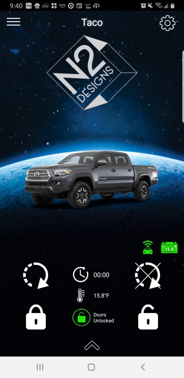

  14. Feb 10, 2021 at 7:41 AM
    #34
    Tacowin1013
    Tacowin1013 Well-Known Member
    Dec 20, 2016
    #205311
    2,629
    2017 OR DCSB 6MT MGM
    Remotely via N2 designs remote starter module app

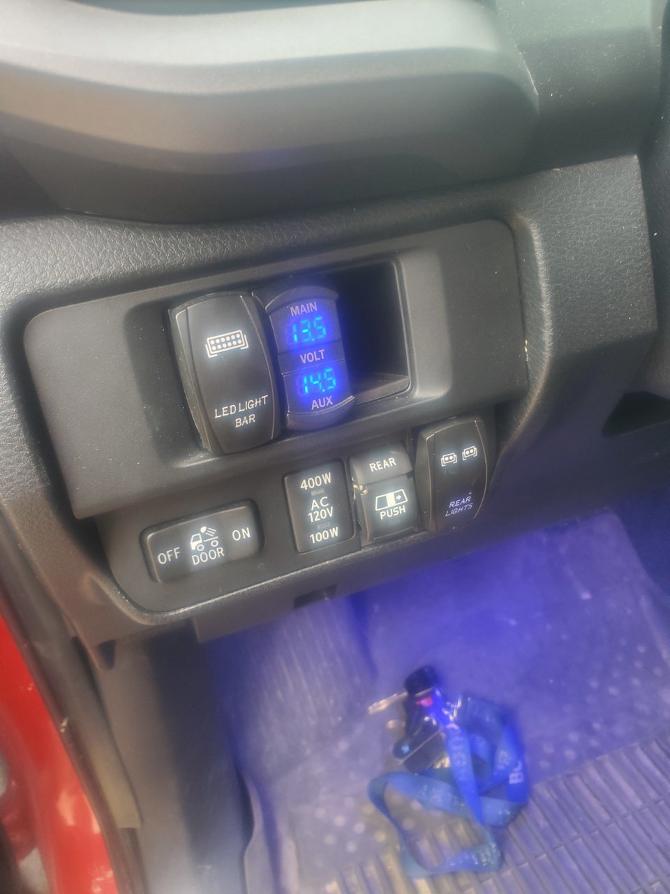

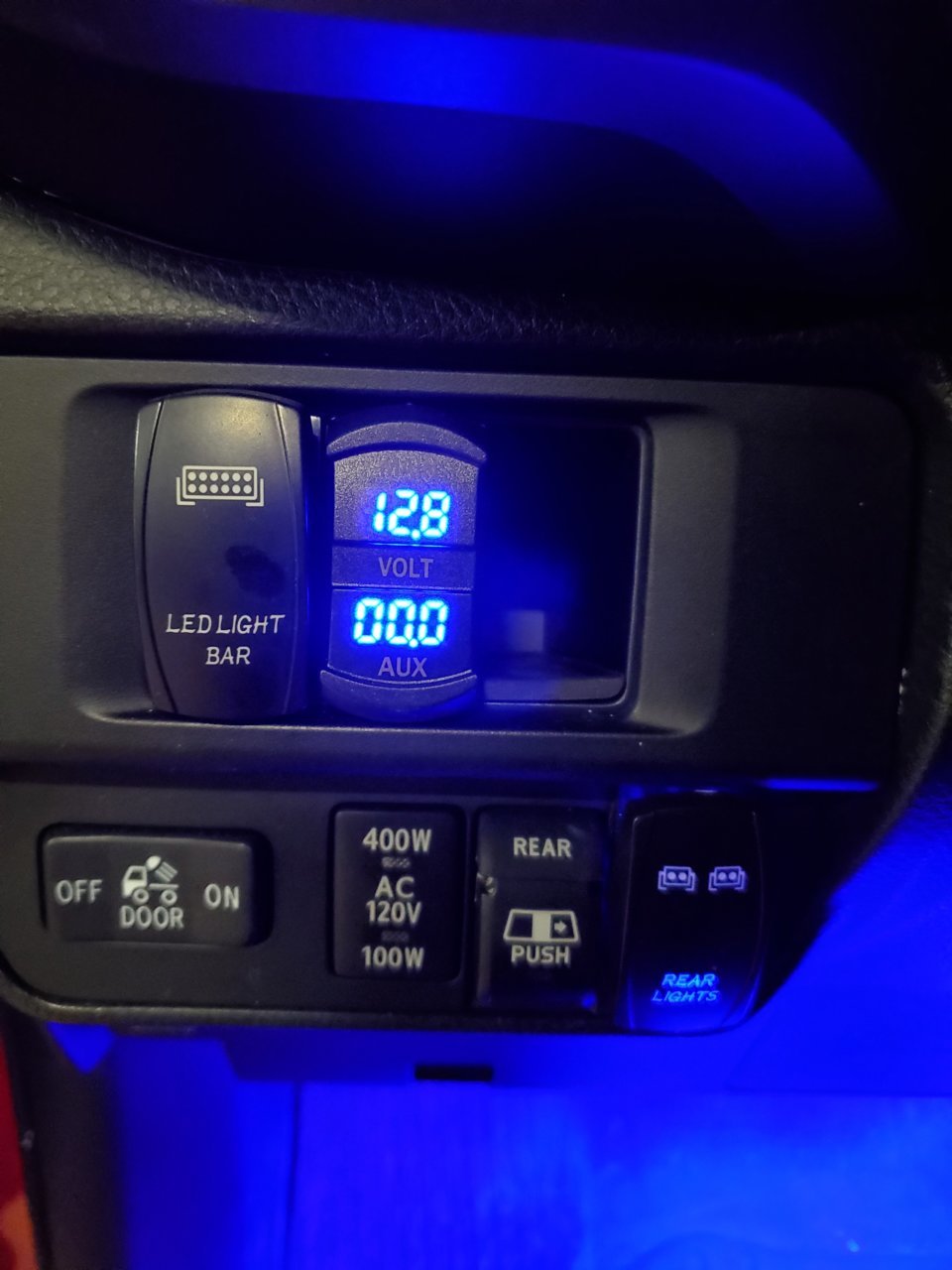

  19. Jan 12, 2023 at 10:44 PM
    #39
    tyepel
    tyepel Well-Known Member
    Feb 3, 2020
    #318119
    65
    British Columbia
    2017ProAT
    33s, HC rear bumper, Sliders, Skids, Dual battery, fridge
    I've got mine for dual batteries just sitting in the little cubby.
    Gigabyte1024 likes this.
