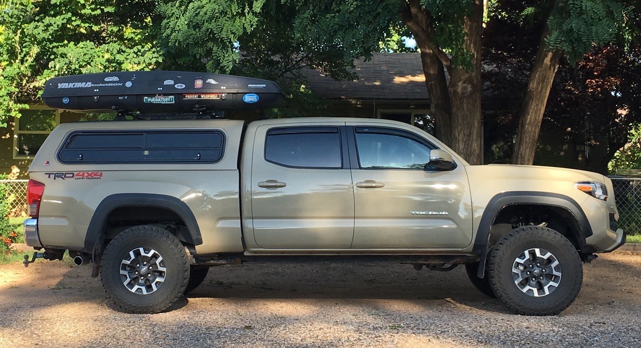

    Do you have any pictures?

    2017 TRD OR DCSB 6MT, Tech, Inferno
    This is the only one I have with it level. I decided to put the overload back in because I ended up towing more than I planned and didn't like the squat. Measurements are key. I'd install it without the overload and go from there based on how your truck settles out.
    Oh...and if you wanna fit 285/70R17 you are going to need UCA's and to max out your alignment cams on the LCA to swing the tire forwards. Otherwise CMC.

    Nice that looks good. Thanks. What tire size did you end up going with? Or did you do UCA's?

    Also.. bro rake. Front end looks high.

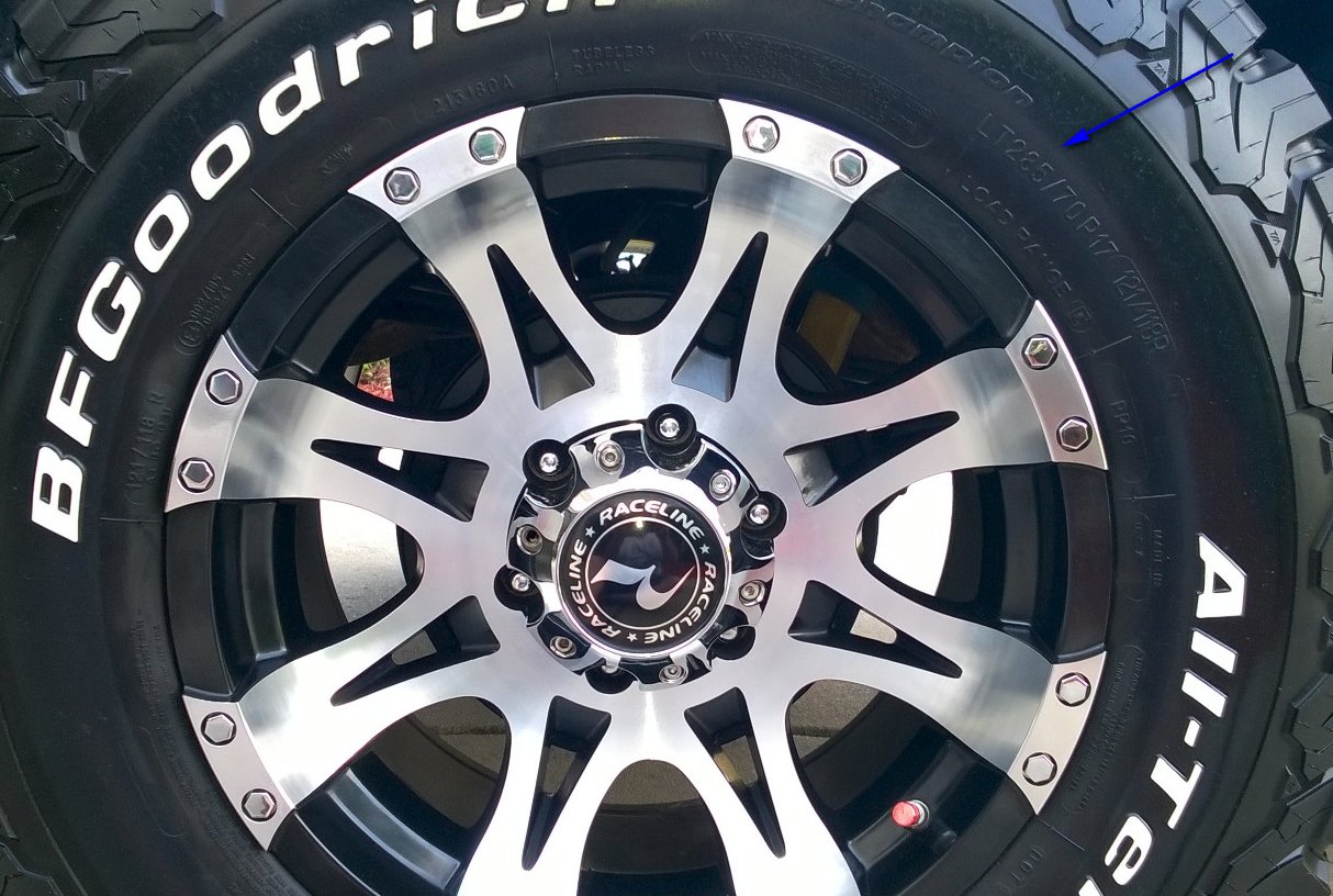

    2020 Army Green TRD PRO - 2023 Genesis GV70
    Stock FOX 275/65/18 At3w 18X9 Fuel Vapor's
  18. Aug 8, 2017 at 6:04 AM
    #38
    harrycary
    harrycary Well-Known Member
    Jul 22, 2017
    #224698
    561
    Harry
    2016 Tacoma TRD Off Road
    It looks like you changed more than your tires (like your rims for example). Perhaps your offset helps.
    Hattr1ck, TRD-ED[QUOTED] and smitty99 like this.
  19. Aug 8, 2017 at 6:09 AM
    #39
    SteenosMT
    SteenosMT [OP] Well-Known Member
    Mar 29, 2016
    #182751
    203
    Justin
    2022 TRD Off Road
    Stock for now.
    It still doesn't justify me spending 1k on the 6112 5160 setup. I'll try this setupnand if it's too harsh I'll consider.
