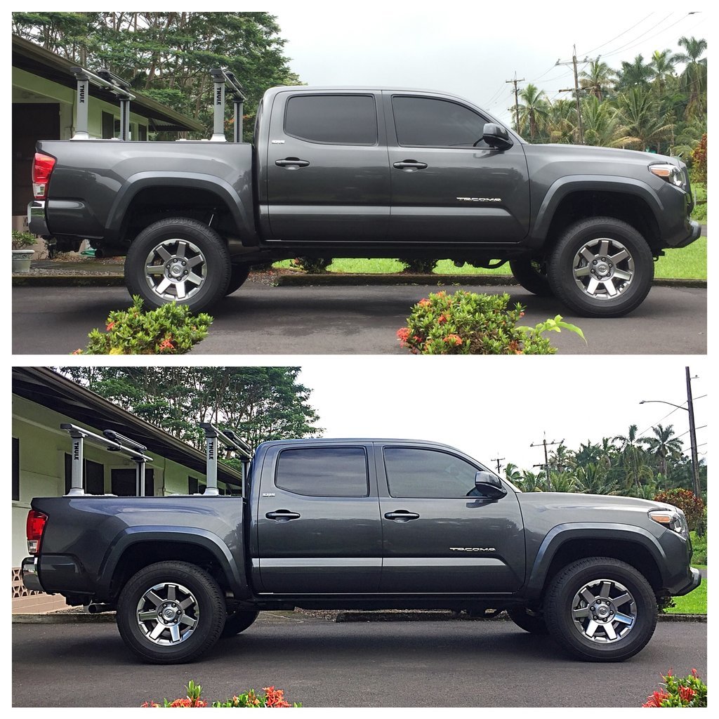

    5100's bottom clip (set at zero 3rd gen shock), OME 888 coil and HS taco lean spacer. Rear Dakar with all leafs, and extended 5100 rear shocks and HS extended brake line kit. Stock UCA's, got alignment in the green. 1.25" spidertraxx wheel spacers, 4Runner trail rims, 275/70/17 (I really wanted 285's but 275's are a happy medium without cutting shit)
    Originally 3.5" lift in the front, about 4.75" rear. Settled nicely to 2.75" front and 3.75" rear
    No rubbing on or offroad with this setup

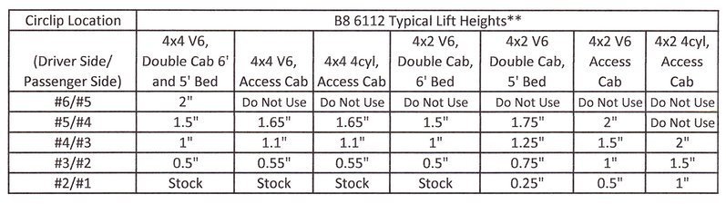

    6112 shocks come with their own coil because the shock is too big around for an 888 coil to fit. You would need to use the spring that comes with the 6112.
    5100 on the left, 6112 on the right.
    Height for the 6112 is adjusted just like the 5100 and factory spring, move the perch with circlip up. The max height you'll see is about 2 inches with the 6112.

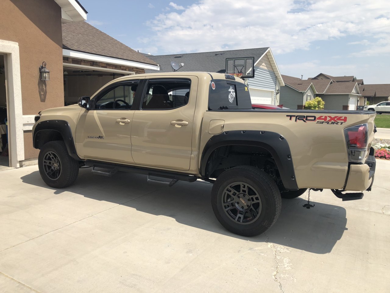

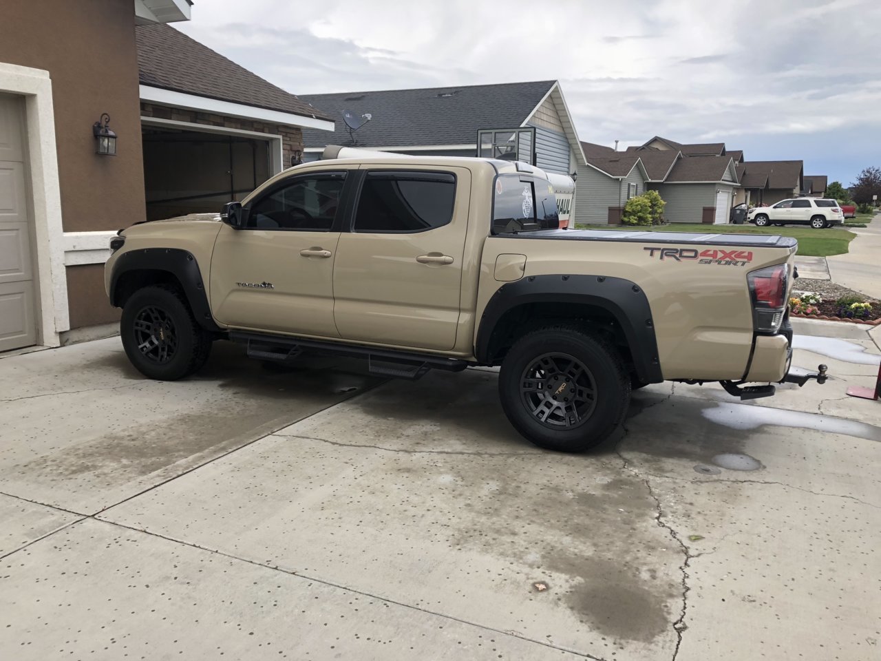

    I just put this exact setup on my truck. Went with 5100's, Dakar HD leaf springs and OME 888's. Ended up with just under 4" of lift in rear and front sits right at 3" lift. To me it drives great still and pulls my almost 4000 lb boat much better. I have the SPC LR UCA's also, just didn't put them in yet. Took about 6 hours by myself in my garage to get it all installed. Only bad thing, wife won't let me get new rubber until they wear.
    After install:
    Before install:
