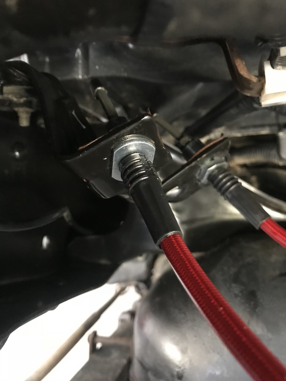

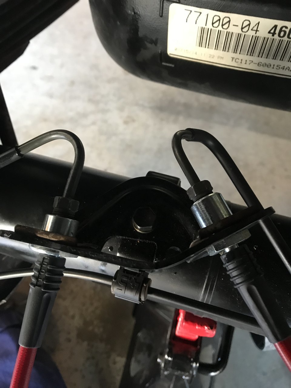

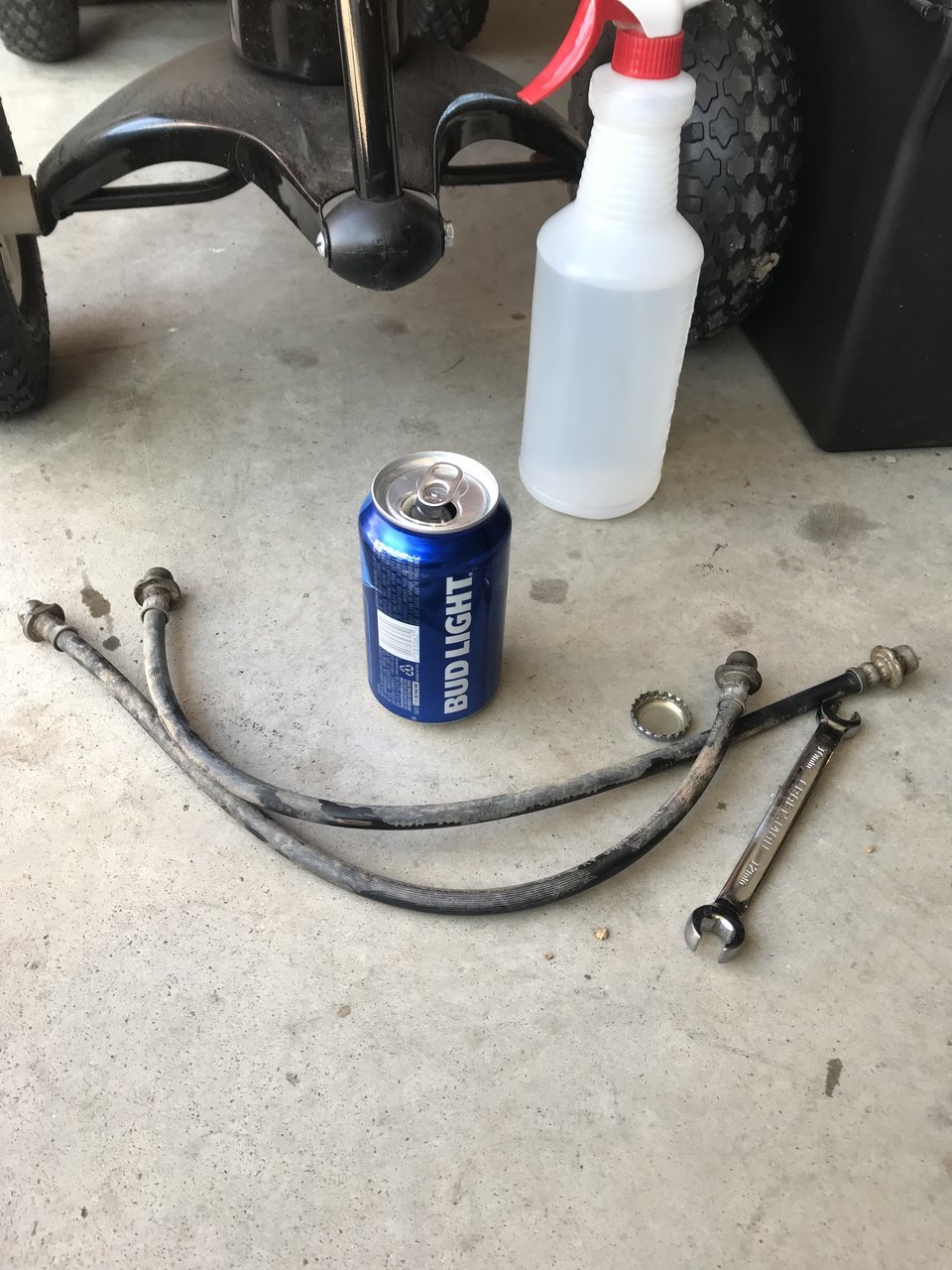

    Finished my +4 extended lines from wheelers yesterday. If you can use a lift it helps with leverage and not having to be so flexible under truck. It is doable without but highly recommended.
    Also grab some rubber nipples for the hardlines Once you pull them out of rubber lines to keep the fluid from running everywhere.
    10 mm Flare nut wrench is your friend.
    Some extra rags for spillage and extra latex gloves.
    Long flathead screwdriver and hammer for the metal clips that hold lines in bracket helps to pop then off.
    Maybe a water bottle or empty milk jug for hoses to drain into.
    Patience and beer helps those flare nuts and the awkward angle of the top brackets sucks. You could possibly bend or flatten the top brackets to aid in the angle of this. Your call.
    Bleeding brakes like the video previously by low range worked great.

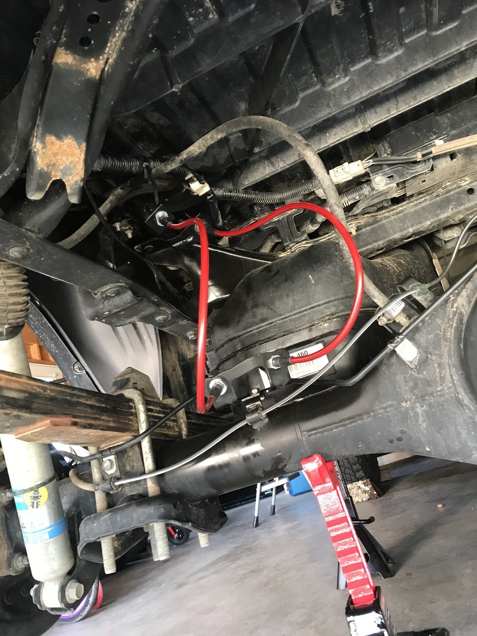

    Just got the same lines in the mail today. Will be installing tomorrow

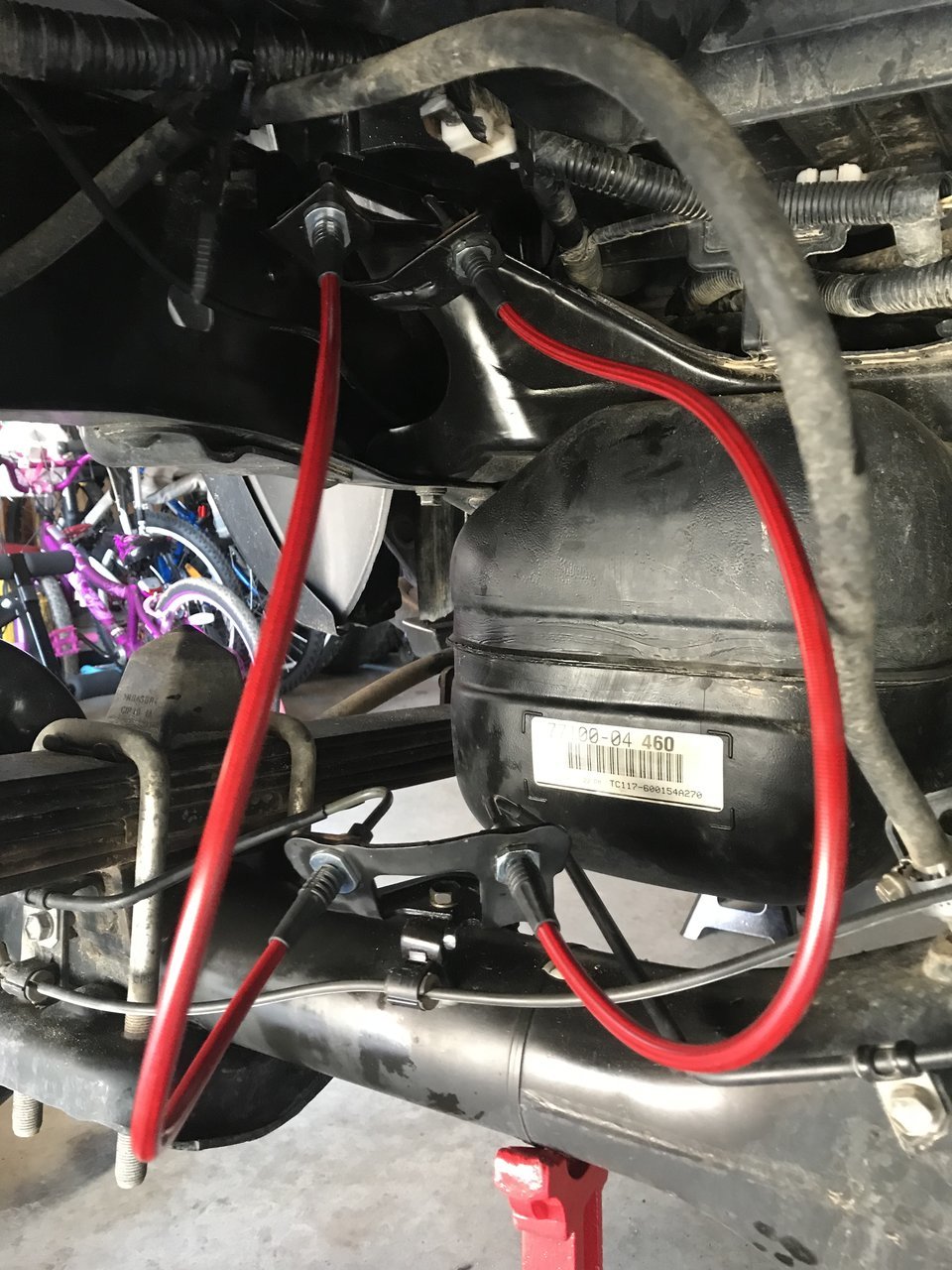

    wow, those are some long lines! I would suggest pulling them up out of the way somehow, so they are less likely to get snagged by a branch or something underneath. In the past I have used soft coil springs clamped to the lines, so they can still be stretched, but at rest are pulled up

    Nope wheelers lines fit fine. They just have to go through top bracket enough to fit brake clip on and bracket back on.
