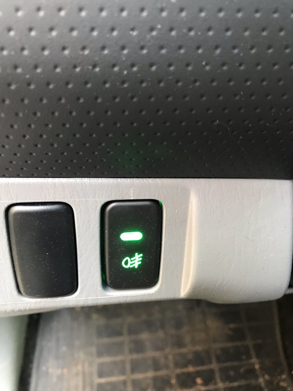

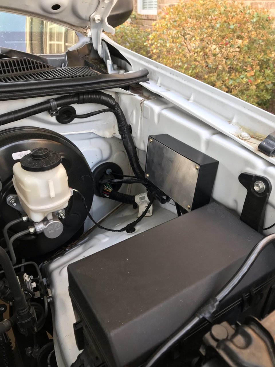

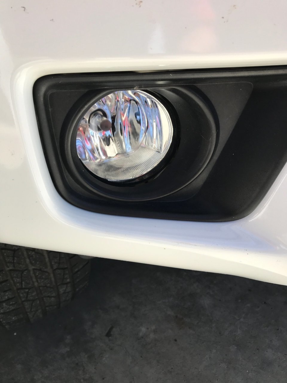

    I put a pair of Spyders on my 13 Tacoma 2.7. They came with the harness and switch. I did put a fuse tap to connect to a power source with ignition on. Probably the hardest part is getting the wires through the firewall. I bought a small box to conceal extra wiring
