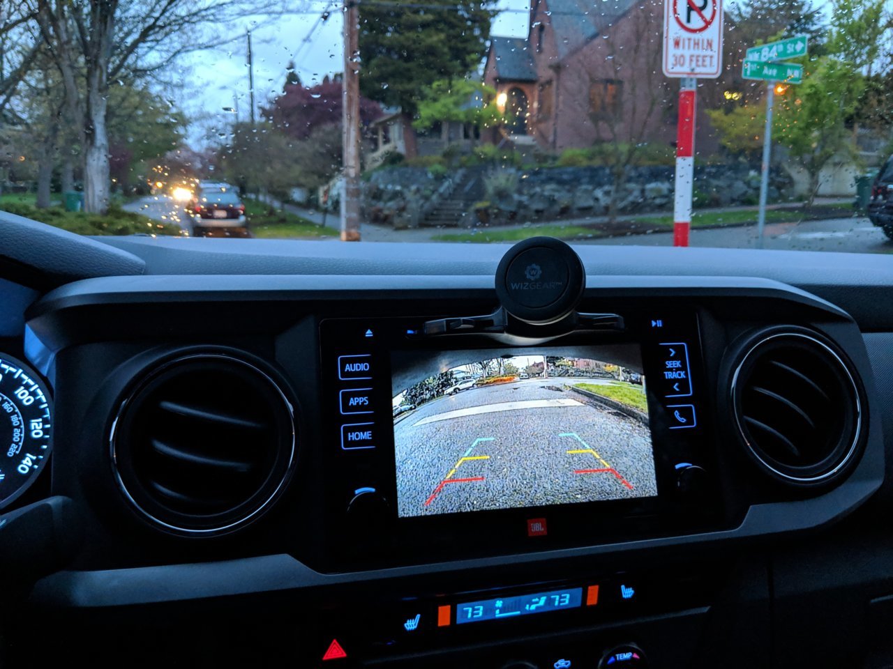

    We’re you able to install it higher on the grill? I’m trying to avoid putting a camera so close to the garnish like a lot of the YouTube videos show...

    No, mine is right beside the garnish. Slightly off center, but it's good enough for parking accurately or getting close enough to a Ford Pinto to aaaaaalmost detonate its gas tank. :rolleyes:
    Before you lock it down, use those shims to tilt it so the red line is 1" from the front bumper.

    There are three holes centered under the bumper. That camera will fit in the middle one. No drilling and the view is ok.

    Got any pictures from this angle?

    Got any pictures from that spot on yours? Sounds like you and Ziggyman might have it mounted in the same spot.

  16. Aug 16, 2019 at 7:15 AM

    I don't need it for parking. I want to use it like you are. Do you have a pic from your setup to compare to others that have posted?
