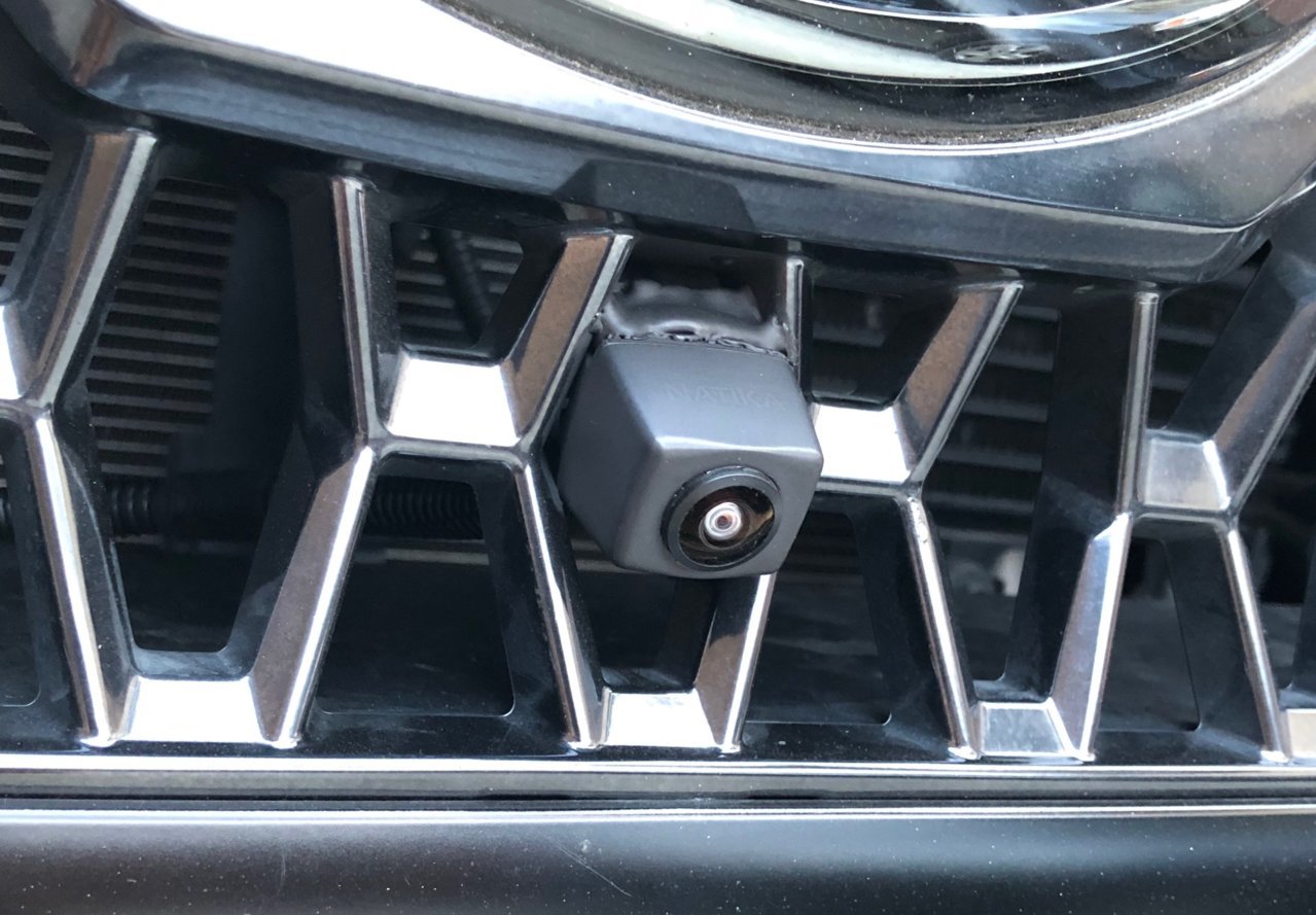

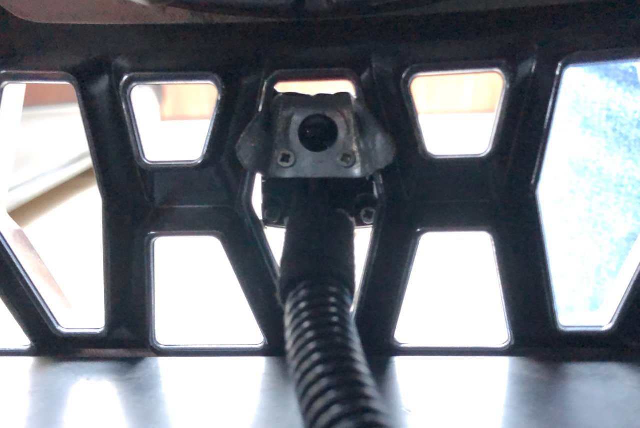

    This is how I mounted my cam. That black stuff on top is some hot glue gun action just to fill in the void.
    Used a piece of metal with holes in it - kinda like the metal plummer tape but just a bit thicker - to secure it from behind using the stock screws the came already had. Ended up very secure and I'm able to see the bumper sides for reference.

    Mine is in the exact same location. Keeps it out of harms way, but low enough to be useful

    So you are aiming your Camera up then to get this view.

    That is the one I installed. Easy and works great without switches. Like being able to select front/rear from the steering wheel. Having the camera showing the leading edge of the bumper in view makes it way more useful to me. Mounted mine center bottom of the grill and used the included angle spacers to give me the view that I wanted before tightening things down. Very easy install.

    It is pointed up, but there is no drilling so you can easily change it.
    I messed with the grill and determined that it was too cumbersome and where I had it worked for my proposes....

    With the Natika you set options - left/right invert, up/down invert, colored guide lines, by snipping different small wire loops. Also includes wedge shaped inserts (like washers) you can stack in combinations to give you the angle you want. Actually matches what you see with the rear OEM camera pretty well. Wouldn’t really know it is an add on.
