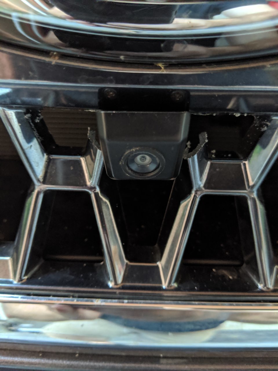

    • The camera was too wide to fit in the Taco '19 Sport cheese grater grill, I had to cut out a tiny bit of grill to get it to fit right below the front emblem where I wanted it. Can't really tell unless you look really closely. Pics...

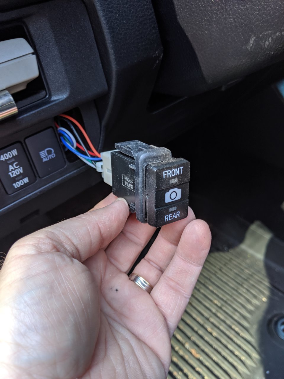

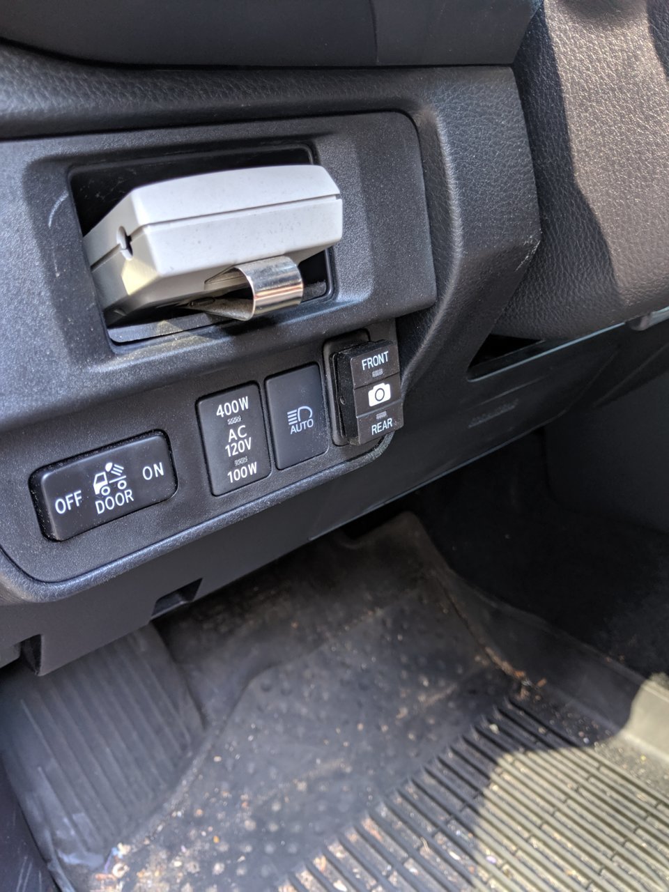

    OK, so here's an update on the front/rear selector switch issue from above. I used the switch free-space filler (just an empty plug filler where a switch would go) as a 'wrapper' around the smaller front/rear camera switch that comes with the Anytime front camera setup.
    For those who might not know (I didn't until I started this project) the set of switches in the Tacoma are different sizes - slightly taller and wider switches are used on the bank of switches on the left side of the console (to the left of the steering wheel), while the switches on the right (under the radio) are slightly shorter and thinner.
    The switch with the Anytime was designed to go in the shorter/thinner set, but I had no free spaces under the radio to I wanted to use the only open switch space which was of the taller/wider variety - the switch didn't fit. So I (painstakingly) cut out the middle of the switch filler, which you can push out from the back, and wrapped the shorter/thinner switch in it... worked great. Pics:
