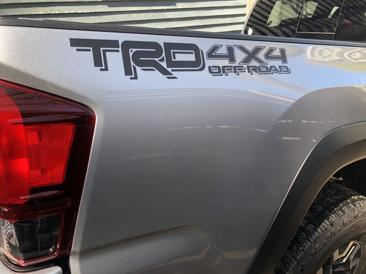

    Twize, gotoman1969 and TRD__Chris like this.

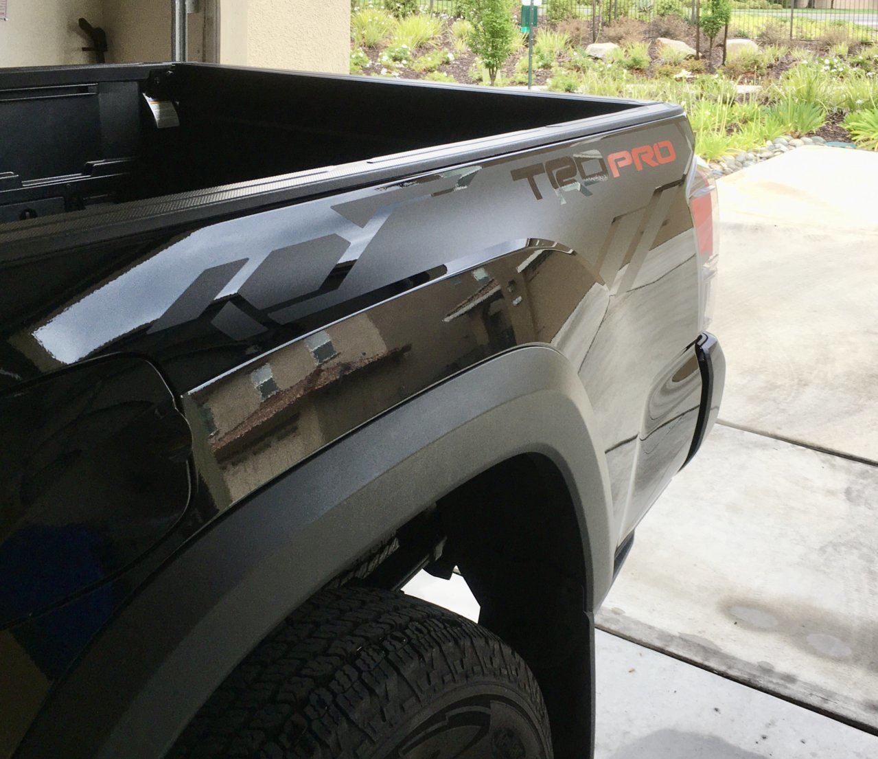

    Yours came out good! I just put mine on today. Just did one side for a trial run. Didn’t wax, used alcohol to remove any residue including wax (per decal co. recommendations).
