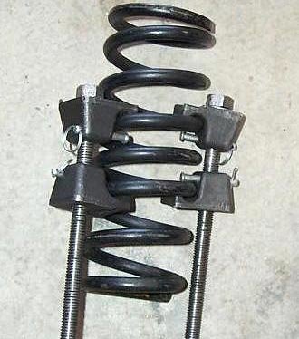

    WOW, you are lucky...I'm not sure what kind of compressor they rented you but I went to autozone and got this
    $50 to rent, 100% refunded upon return. Worked great for me on the 5100's. Some folks said the ones they got from autozone didn't work for them. I had a buddy helping so we were able to compress both sides at the same rate...worked out pretty well. note: the safety pins you see pictured did not fit around my springs, went ahead without them...scared the whole time but seemed pretty secure. Put the eye of the shock in a vice if you have access...makes working verticle much easier. If you don't feel comfortable with any of this save your limbs and possibly your life and pay a shop to switch them out, it's not worth your skin.

    this = DEATH....do not position your body in-line with the shock and spring under compression.

    Man - glad to hear that you weren't hurt worse! I bought a pair of compressors from OReillys when I was doing my lift and started getting nervous when the bolts started to bend. And I think it was just like the ones I would have rented from them. Glad I didn't keep going!
    I ended up taking them to an auto shop to get compressed and the guy said it was REALLY hard to get them together. Said it was a bullet waiting to go off.

    I removed the strut first then tried to use the spring compressor to reinstall.
    I may have placed them too far apart.
    The compressor is like the one you used.

    Be safe man...those things are dangerous as you found out. It's not just the springs you have to look out for, if those compressors slip off together you got a missle flying around.

    Did you unbolt the bottom A-arm from the spindle? Thats what I had to do to put in my Eibach springs. I used a spring compressor from O'Reillys, but also chained the spring to the frame so it wouldnt rocket off. It went really smoothly..
