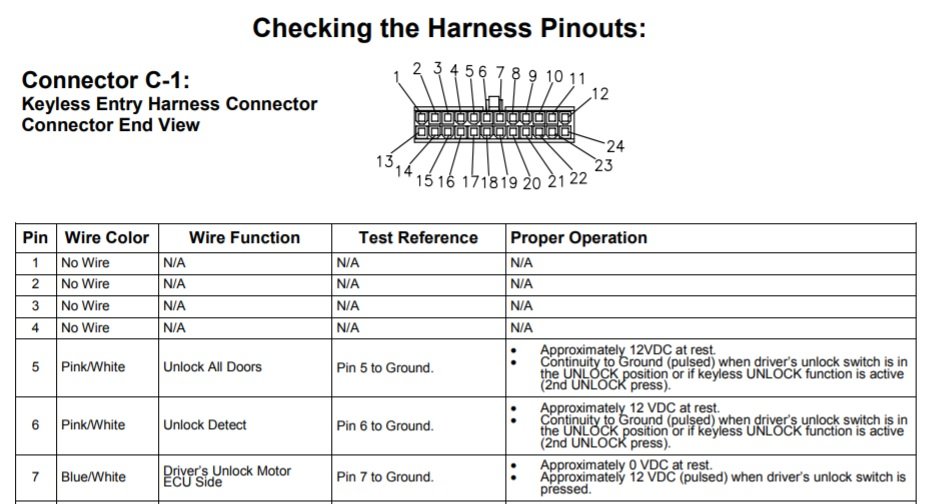

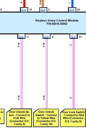

    You might have a poor tap connection. Look at your installation instructions, this table and figure might help. Pins 5 & 6 on your keyless entry module connector C-1 go to the connector IC2 wires to 4 & 10 you T-Tapped to, these should be what unlock the passanger doors after two clicks of the unlock button. If you have a voltmeter you can do the tests shown in the table, note that the operation is momentary (on DC voltage scale, voltage should drop from 12V+ toward 0V momentarily when the key fob unlock is pressed twice as measured from t each connector pin to ground):
    Zekemo[QUOTED] and bbahunter like this.

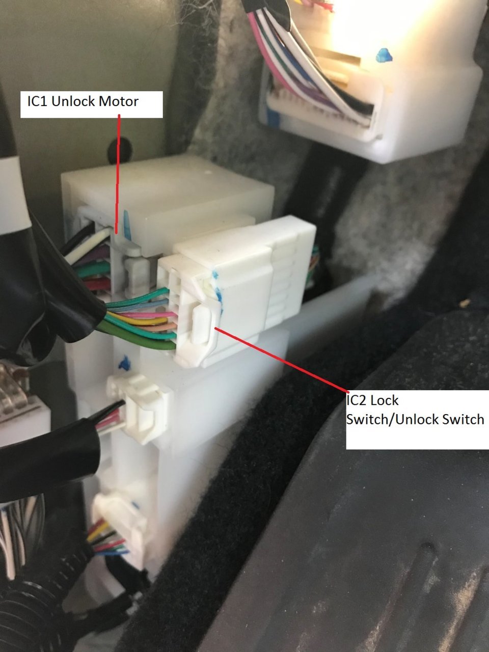

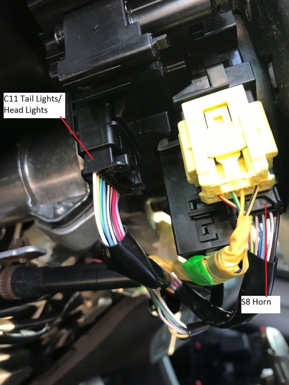

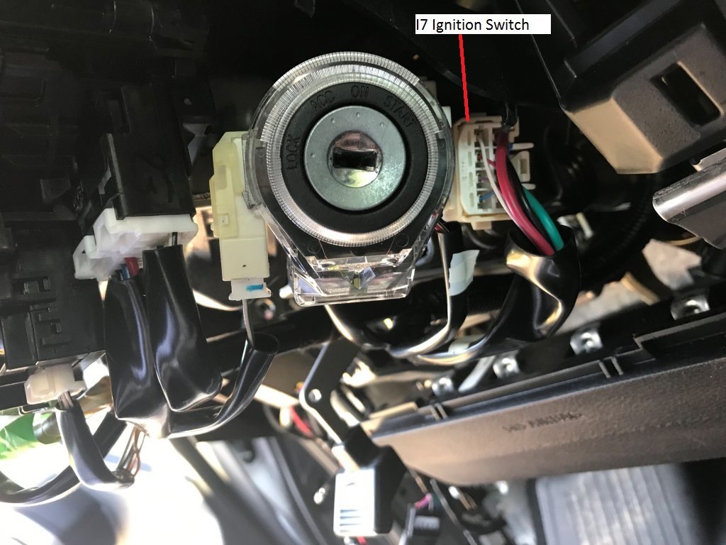

    That wraps it up. Below are a few pictures showing the connector ID's before disconnecting. Oh, and if you reference the instructions for connector wire colors, note that as stated the connector images in the instructions are as viewed from the connector side, not the wire side.
