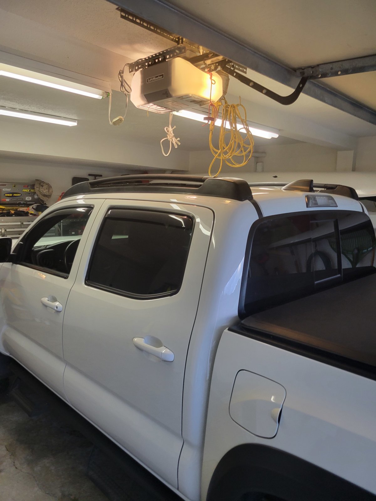

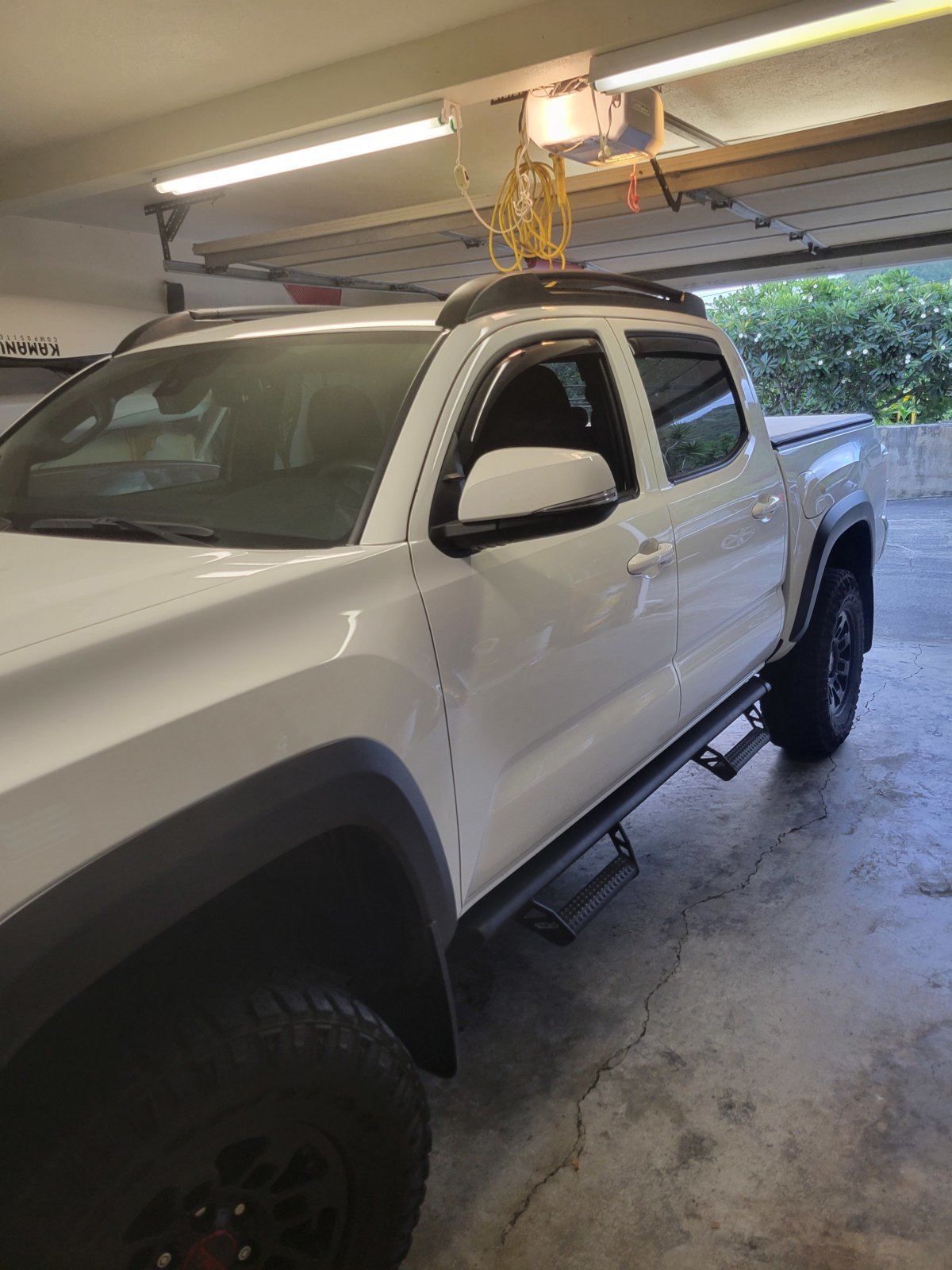

    Picked up a used OEM rack and installed today. I used these threads for the PRO tips.for the install. Went pretty smooth, less than 1 hr but 2 of the small screws gave me a hard time, think previous owner/installer cross threaded them but I got it eventually.
    People either love em or hate it. For my needs this is a good solution, don't need or want a full overland rack.
    I like that it changed the looks a bit too. Easily reversible if need.

    Looks good, I like mine for the looks and the simplicity of it.
