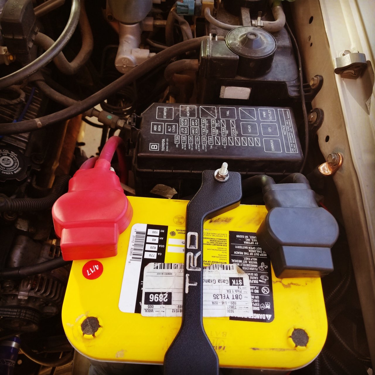

    You need to get one ofIMG_20180905_004615_261.jpg the fancy aluminum bars. Mine doesn't move and I've put it trough it paces.

    This would be nice if it works! Mine "was good" until I hit the autocross in it... link?
    All those black scratches aren't left behind from it sliding around are they?!! ;)

    Looks like a nice option to keep in mind, thanks guys!
    Though I think if I built a custom bracket just for the Optima I would want lose the plastic spacer to keep the weight a bit lower with less shitty plastic stuff holding it together.

    2Runner[OP] and Das it mang like this.

    I think there from the old tie down. Ill look at the new battery.

    This is exactly where my brain was going after looking at this a bit. :thumbsup:
    First I thought I would lose the plastic spacer and then modify the oem arm, or fabricating a custom arm. Then I started thinking for my efforts it would probably make more sense to relocate the battery just like you are suggesting here.
    Hence why I decided to just make it work for now while researching the relocation for another day!
