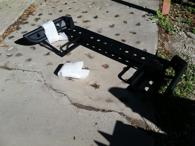

    Here is the powdercoated bumper and swingout assembly:

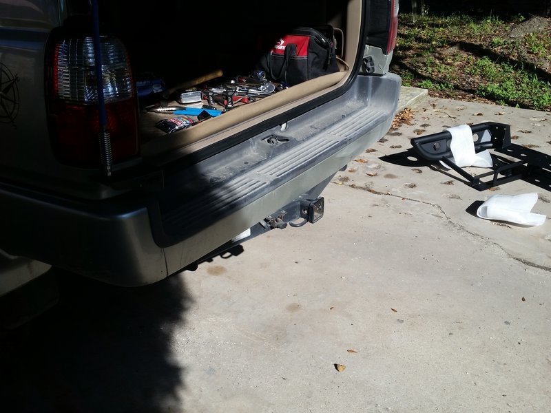

    First step is to obviously remove the rear bumper and hitch:

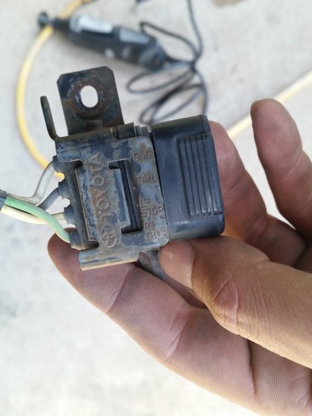

    Since the hitch is the first thing to go, I made sure the trailer wiring harness bracket was disconnected from the hitch:

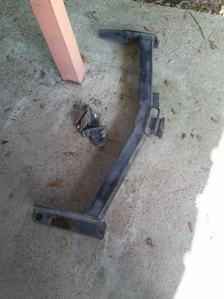

    The hitch receiver is held in place to the frame with a total of 8 bolts - 4 on each side:
    Removing the eight bolts will drop the hitch receiver:

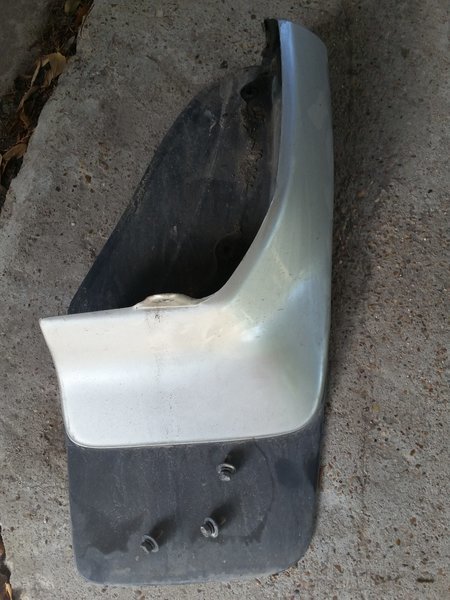

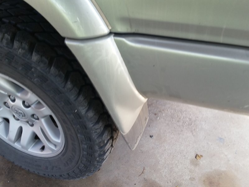

    Next remove the mudflaps, there are about 3 screws that hold the mudflaps onto the 4runner. They are located against the wheel well:
    Removing the mudflaps will reveal a bolt, take it out:

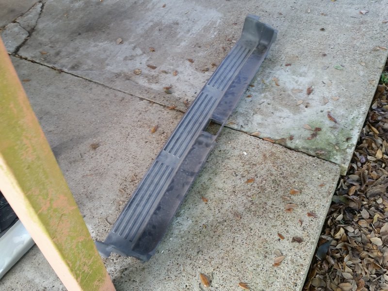

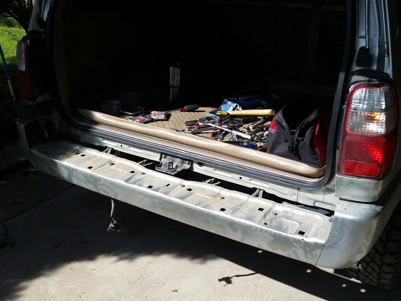

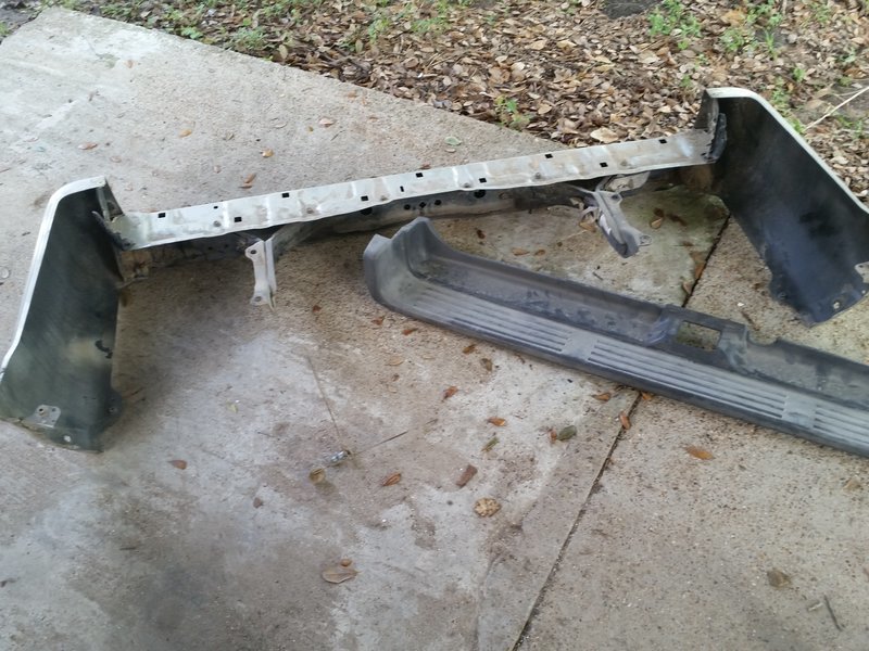

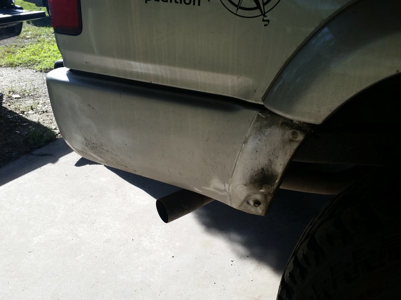

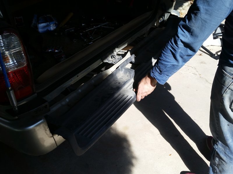

    Once that bolt is off, remove the bumper cover. These are held firmly in place with tabs, crawl underneath the vehicle and push the tabs out with a flathead, pliers, etc.

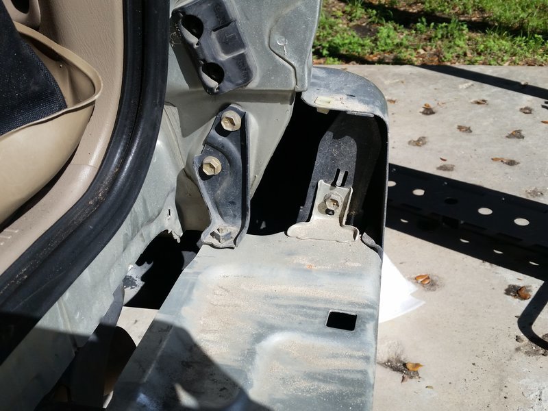

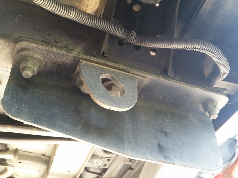

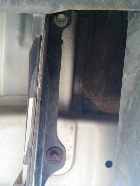

    Once that black bumper cover is gone, it will reveal a black bracket with two bolts, remove the top two bolts on EACH side of the bumper:
    The bumper is now being held in place by four bolts underneath the vehicle, two on each side on this bracket:

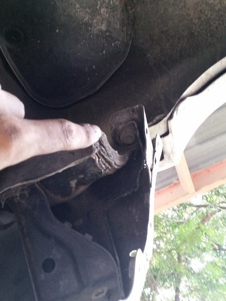

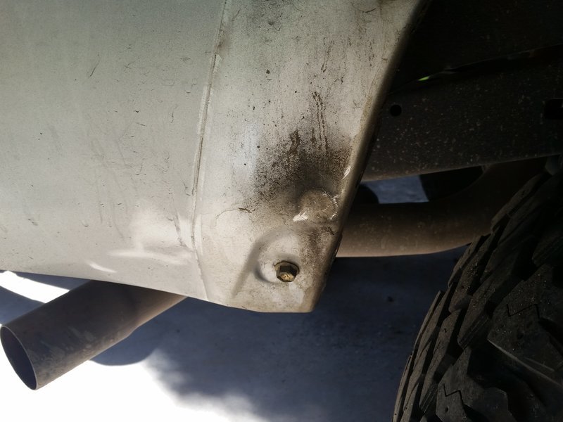

    Oooops.. found two more bolts - The bolts are located where the bumper ends at the mudflap - notice the fuel filler neck cover - One on each side - These are a little hidden.

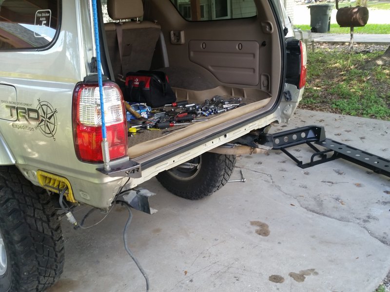

    The bumper should now come off:

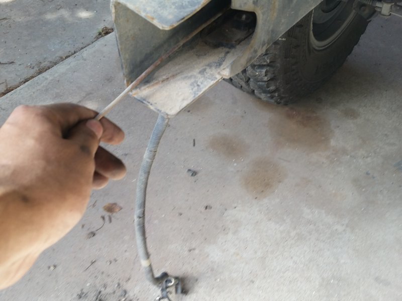

    Inside of the frame rails, a long rod with a bolt welded on it will be seen, pull them out:

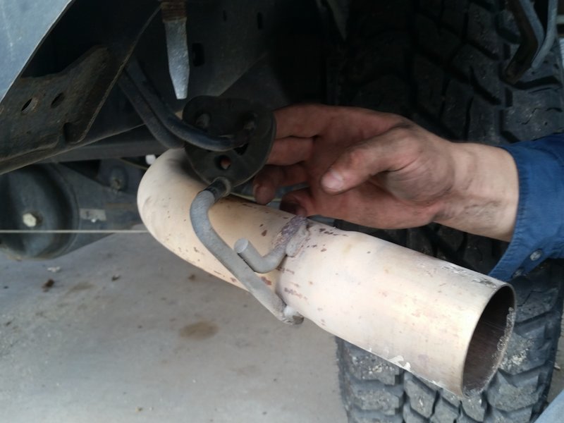

    In order to get the bumper in, the rubber grommet that holds the exhaust tail piece must be removed:

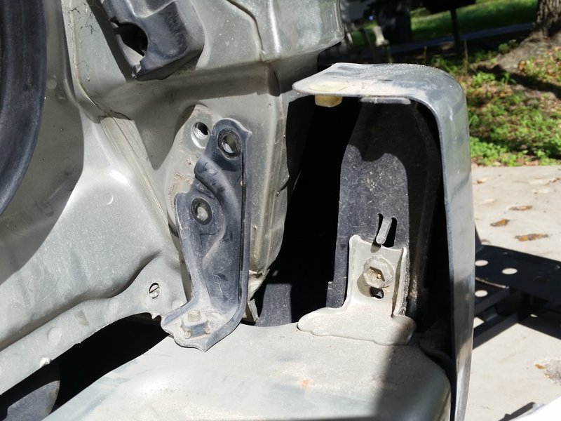

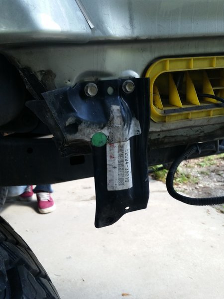

    When the bumper was removed, this black bracket was revealed - one on each side. Remove this also:

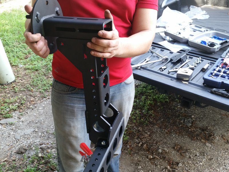

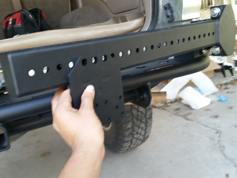

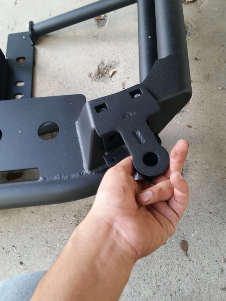

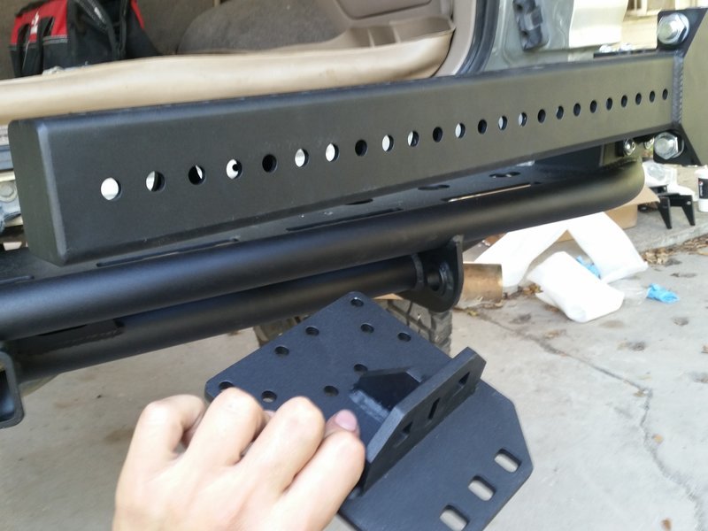

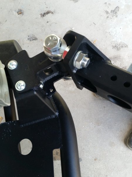

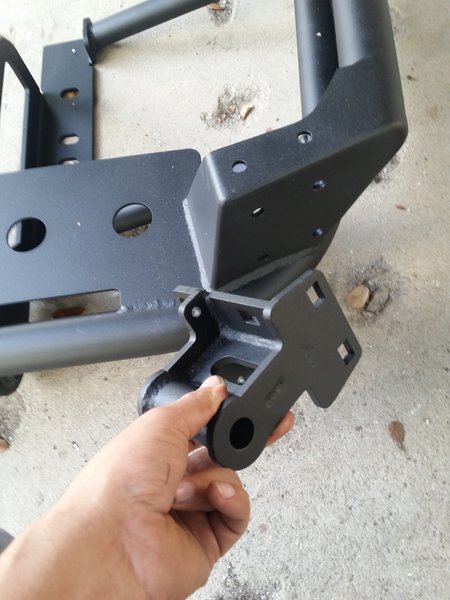

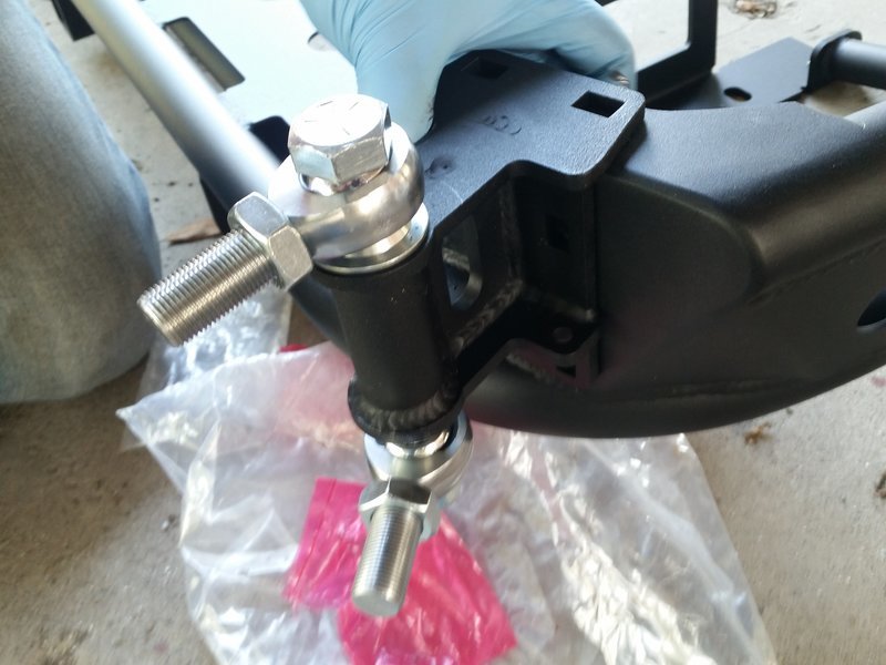

    This is the hinge bracket where the swingout attaches to. Make sure this gets installed FIRST before installing. When the bumper is purchased, Savage only drills pilot holes for the hinge bracket. Drill them out BEFORE getting the bumper powdercoated or painted.

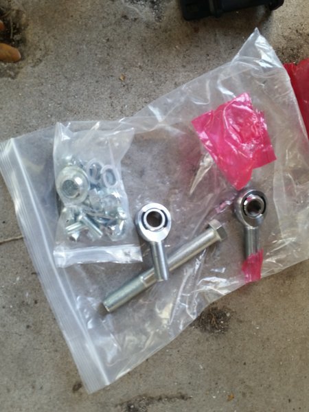

    Hinge hardware:
    Assemble and bolt on like this:

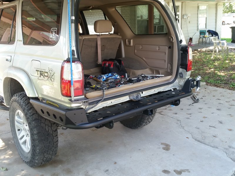

    Install bumper:

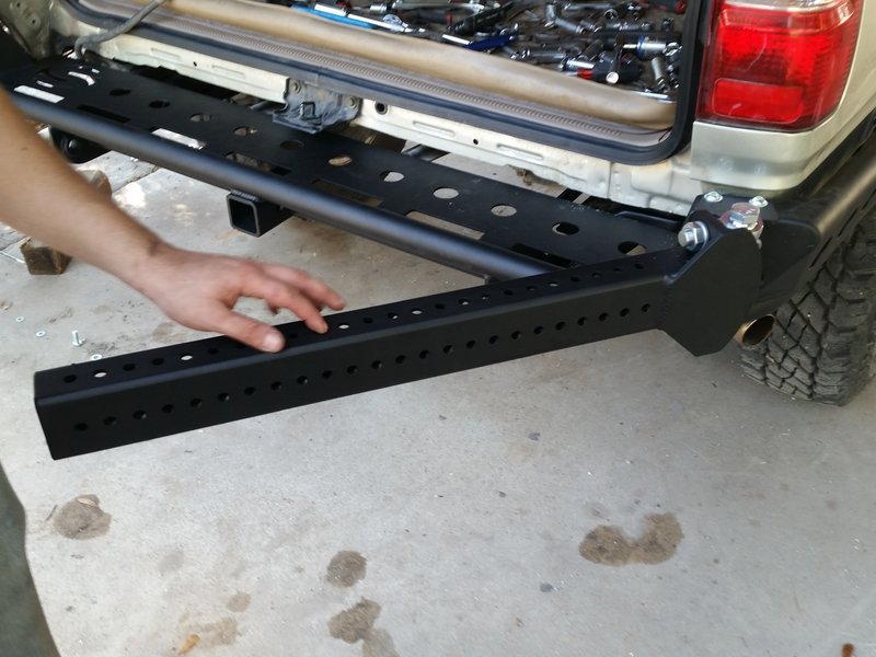

    Picture of hinge for the swingout:

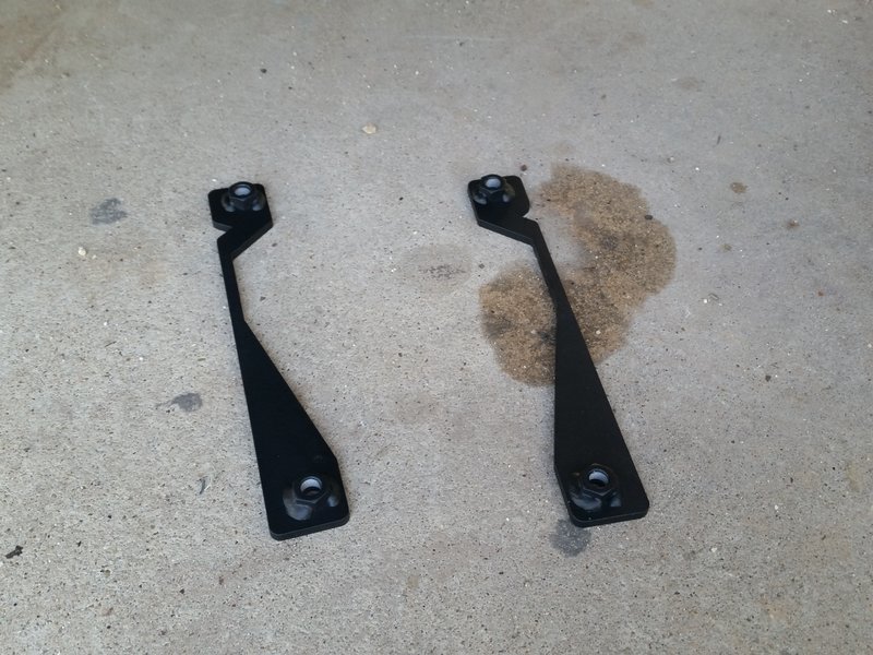

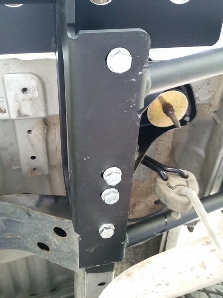

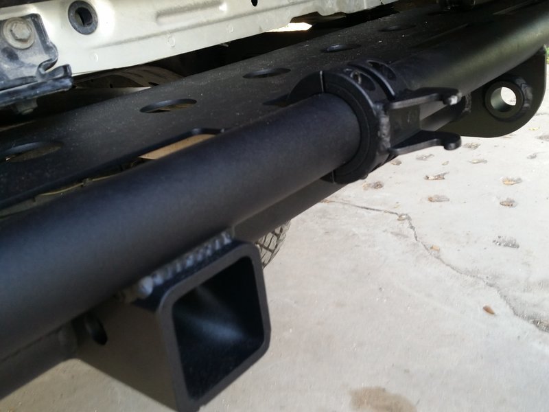

    Only FOUR bolts were used to set the bumper. In the bumper kit, these two brackets were included:
    These go into the frame rail:
    The first and last bolt now threads into that bracket:

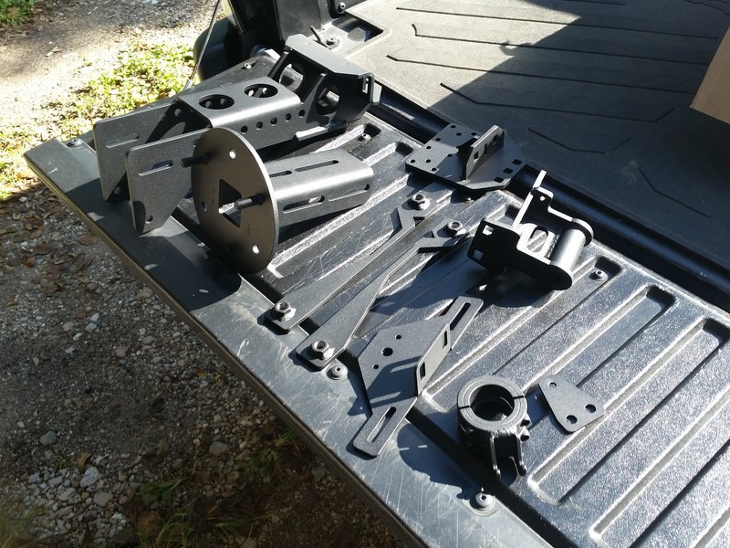

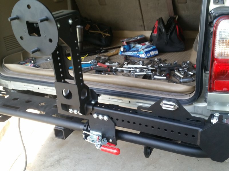

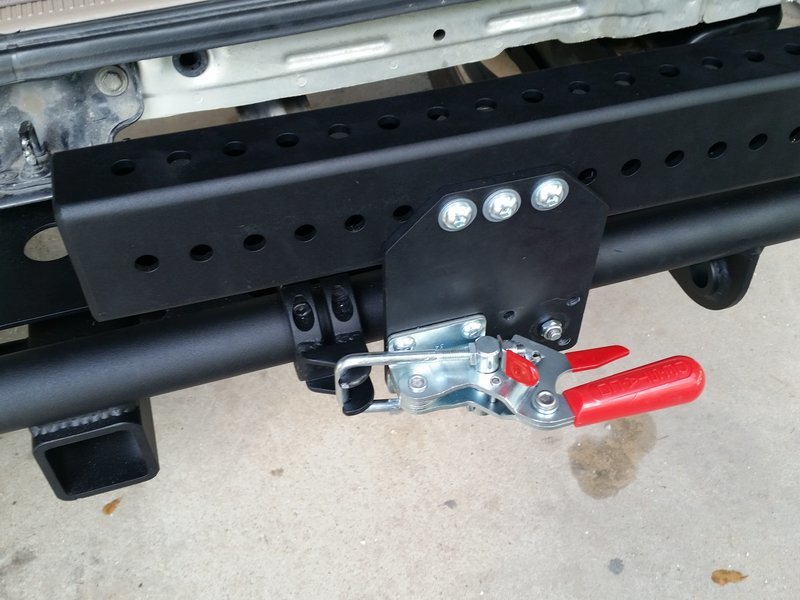

    This plate is used to install the locking lever:
    Install the "anchor" for the locking lever:
    Install the locking lever:

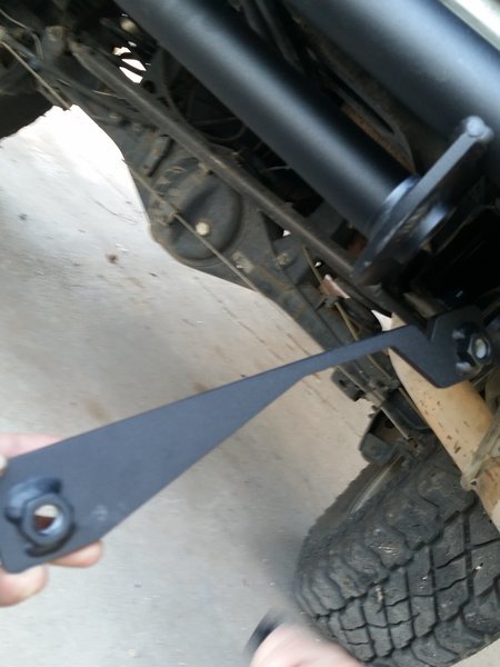

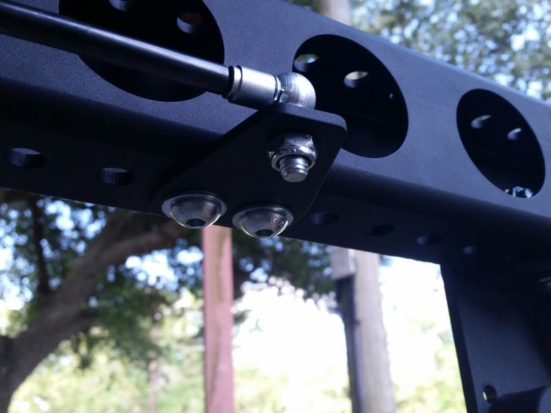

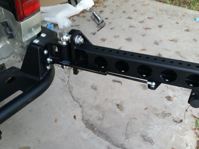

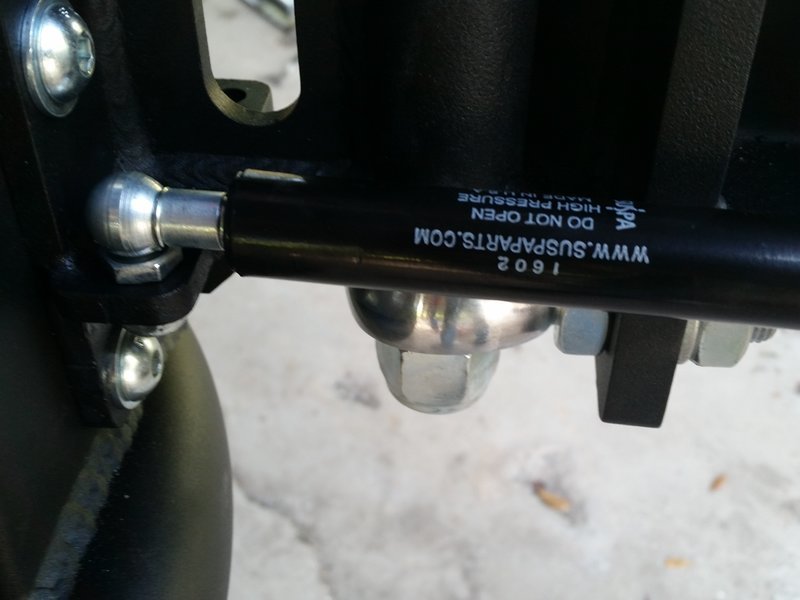

    Now the gas strut is installed:
    Strut bracket that is attached to the arm:

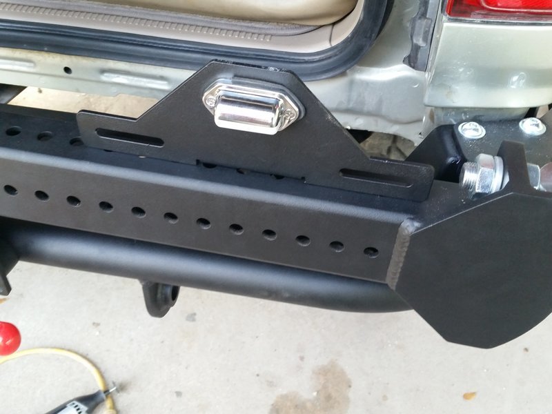

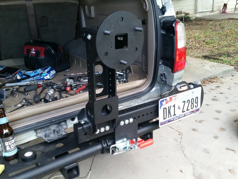

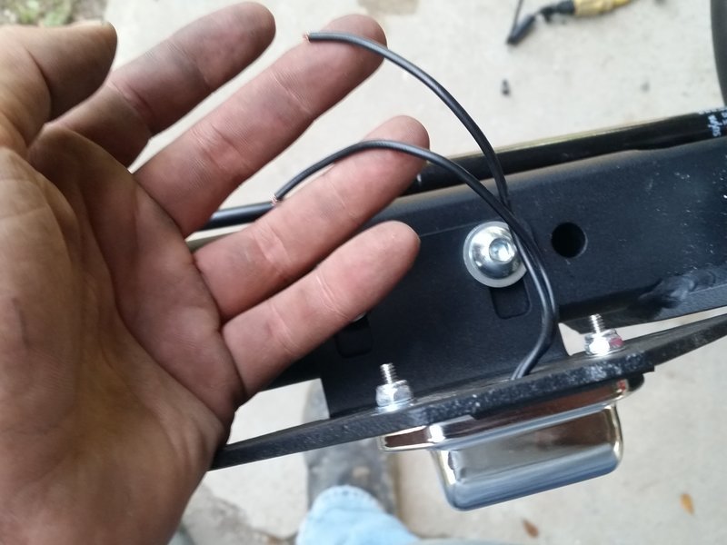

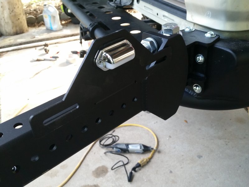

    Next, the license plate bracket is installed.

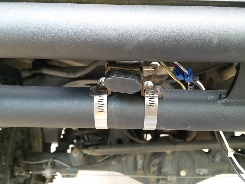

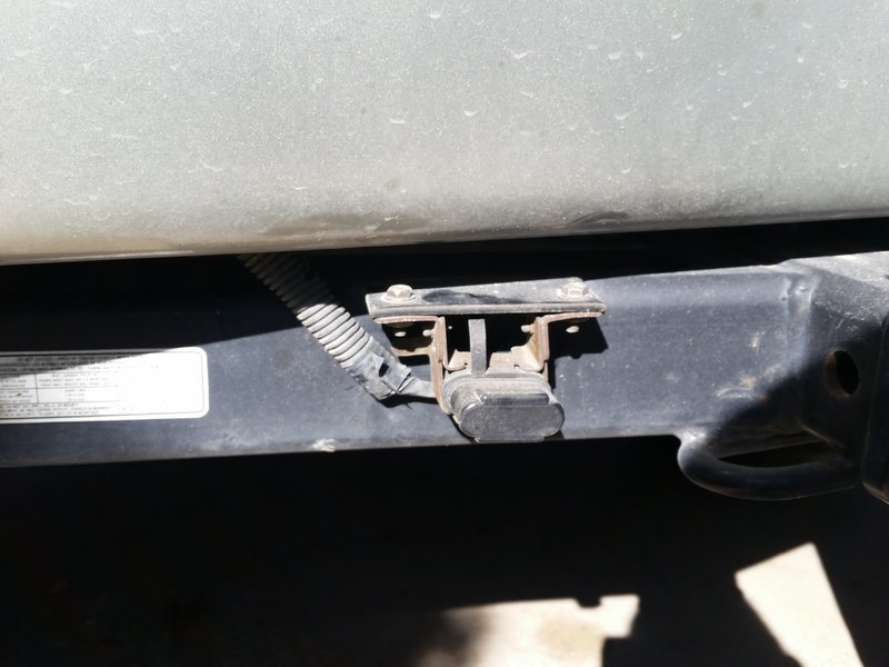

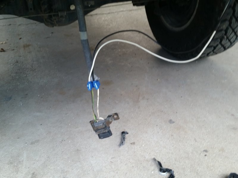

    Hmm.. time to run some wiring:
    I decided to tap into the trailer wiring, good thing they were labeled. I tapped into "Tail" and "Ground", black and white:
    Run wiring and attached using quick splices - I made sure it was well wrapped in electrical tape:
    Clamped it to the rear tube of the bumper, where it is hidden. No, I don't mind the hose clamps. It cant be seen unless you are looking for it.

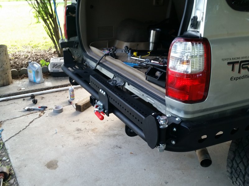

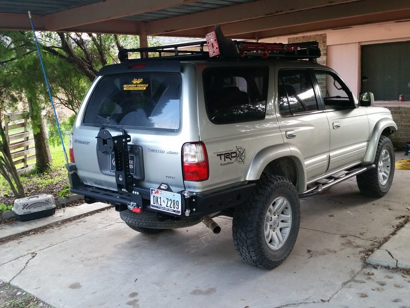

    Now complete:

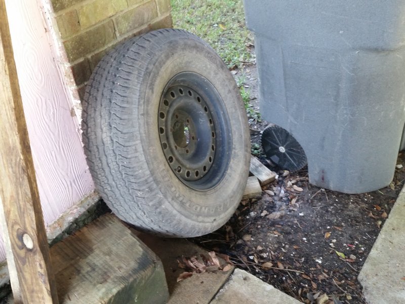

    Now I have to afford a new spare and wheel. :bananadead:
