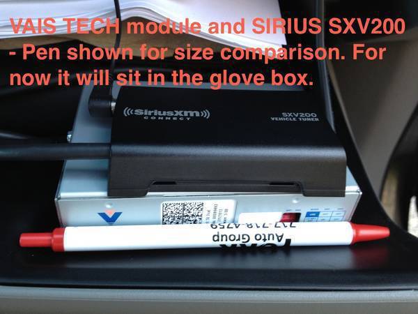

    For now I will leave the hardware in the glovebox until I decide on how/where to mount it. Antenna will go out the back of the cab onto the roof.
    VAIS Tech module and Sirius Adapter

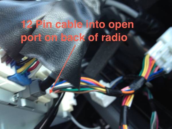

    Cable to back of radio - went to open port bottom row - 12 pin.

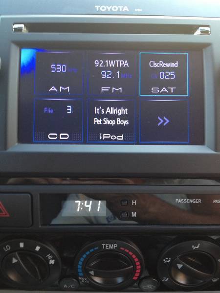

    Display showing new source

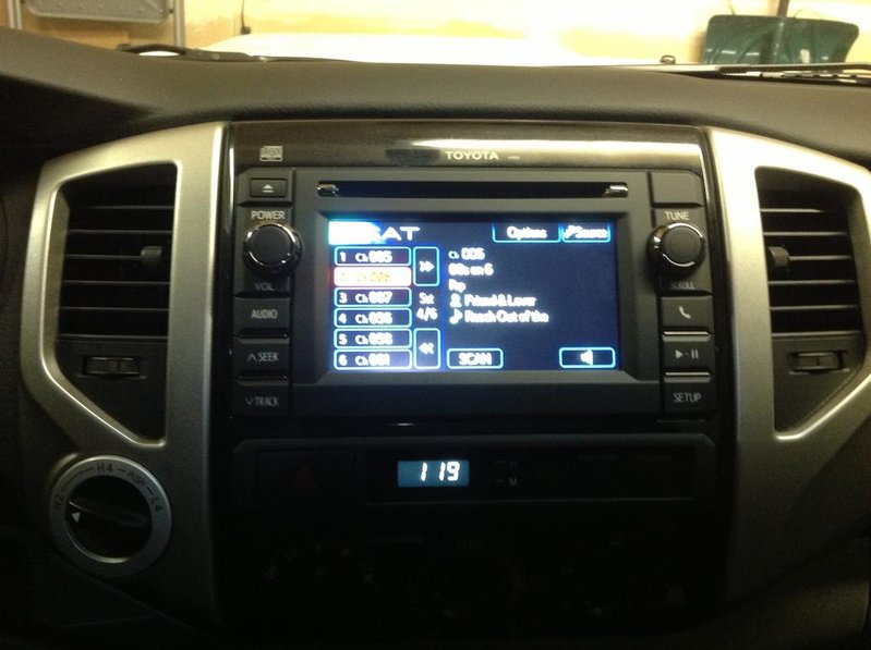

    All done enjoying SiriusXM again!
