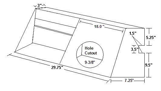

    Just build a box, I did....I'll submit photos later. Found the original dimensions on Toyota Nation, but changed it up to fit my sub (for airspace) and amp/crossovers.

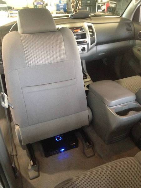

    I ran my power wire in through the fire wall then through the center console to the amp under the passenger seat. I ran all the speaker wires through the passenger door sill. Click my link below for pics.

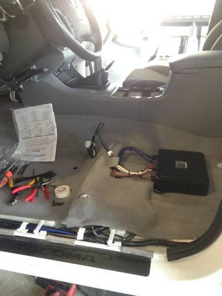

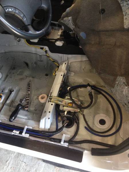

    Ran my power wire through the grommet on the drivers side upper fire wall, through the factory cable route and under the drivers seat. Most direct route and kept the signal and speaker wiring away from the power wire.
    Routed the signal cabling and speaker wire along factory wire paths wherever possible and created a proper ground (bare sheetmetal) with a bolt and nut attached from underneath.
    Take your time and plan for a good days worth of work if you are doing it correctly and not rushing.

    Nice work and pics Looking4vr. I put my amp under the passenger seat to make sure if it hampered the seat in any way, it would be the seat used occasionally. I was too lazt to pull the carpet up, so I ran my power through the center console and cut a 1" slit in the carpet to pass the power/ground wires. The speaker wires all went to the passenger door jamb:
