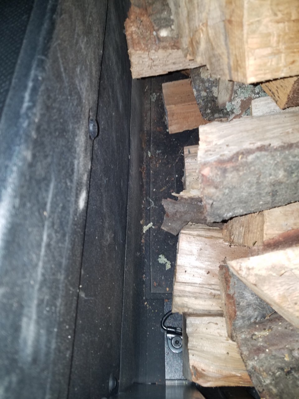

    Thanks to @Doublenickel for the recommendation and his install over here. :thumbsup:
    Super excited about Gapshield! No longer do I need to clean bark, oak leaves, and acorns out of the tailgate gap. The best price I found was at Caliraisedled here. Official video can be found on the Ecoological website here. They recommend installing the product at temps above 68, and also warming up the Gapshield prior to installing. Also, for obvious reasons, they don't recommend blasting it with a pressure washer (underside, at least).

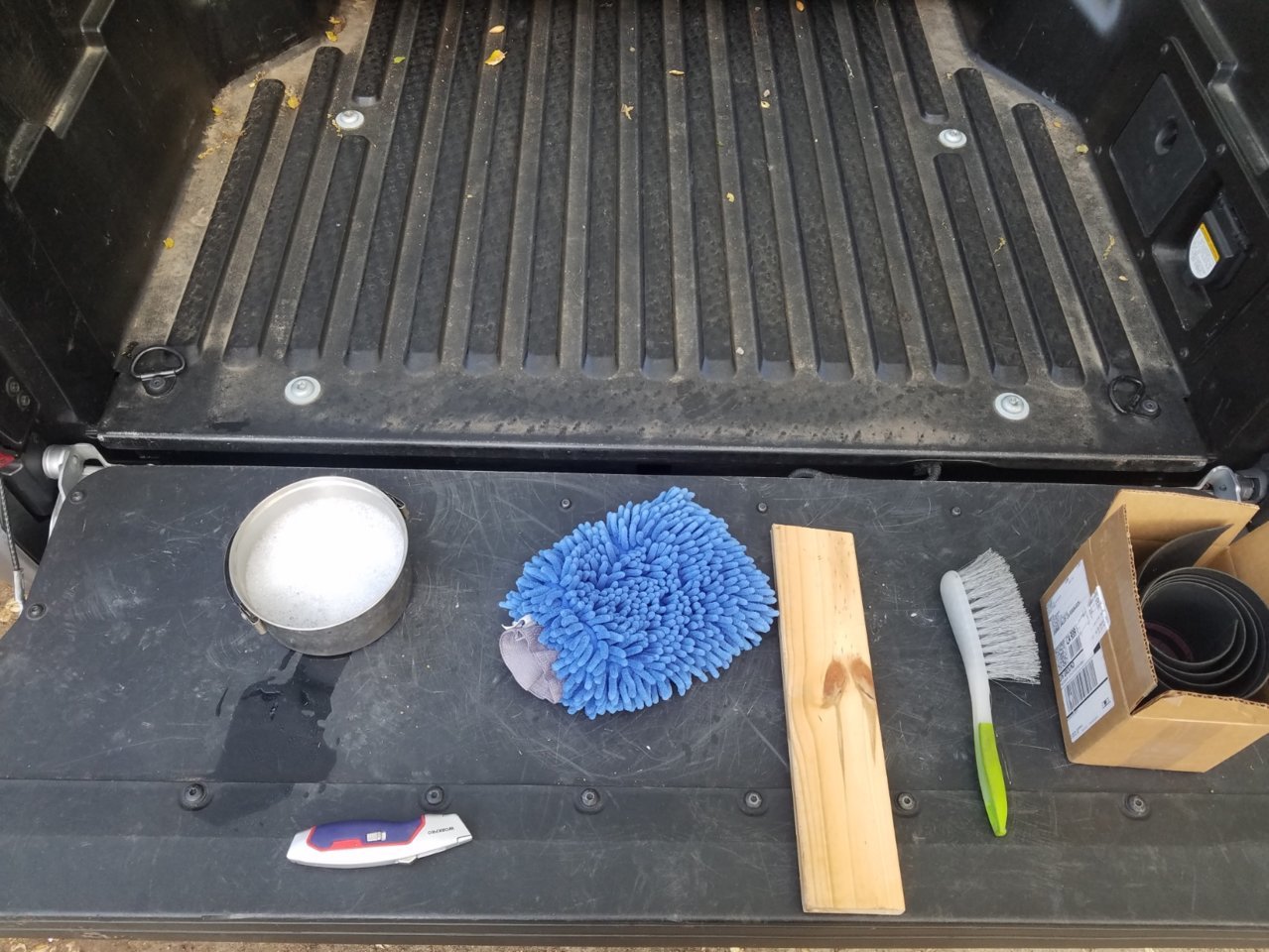

    I used Jesus soap to wash the bed (great for everything including keeping fleas off pets).

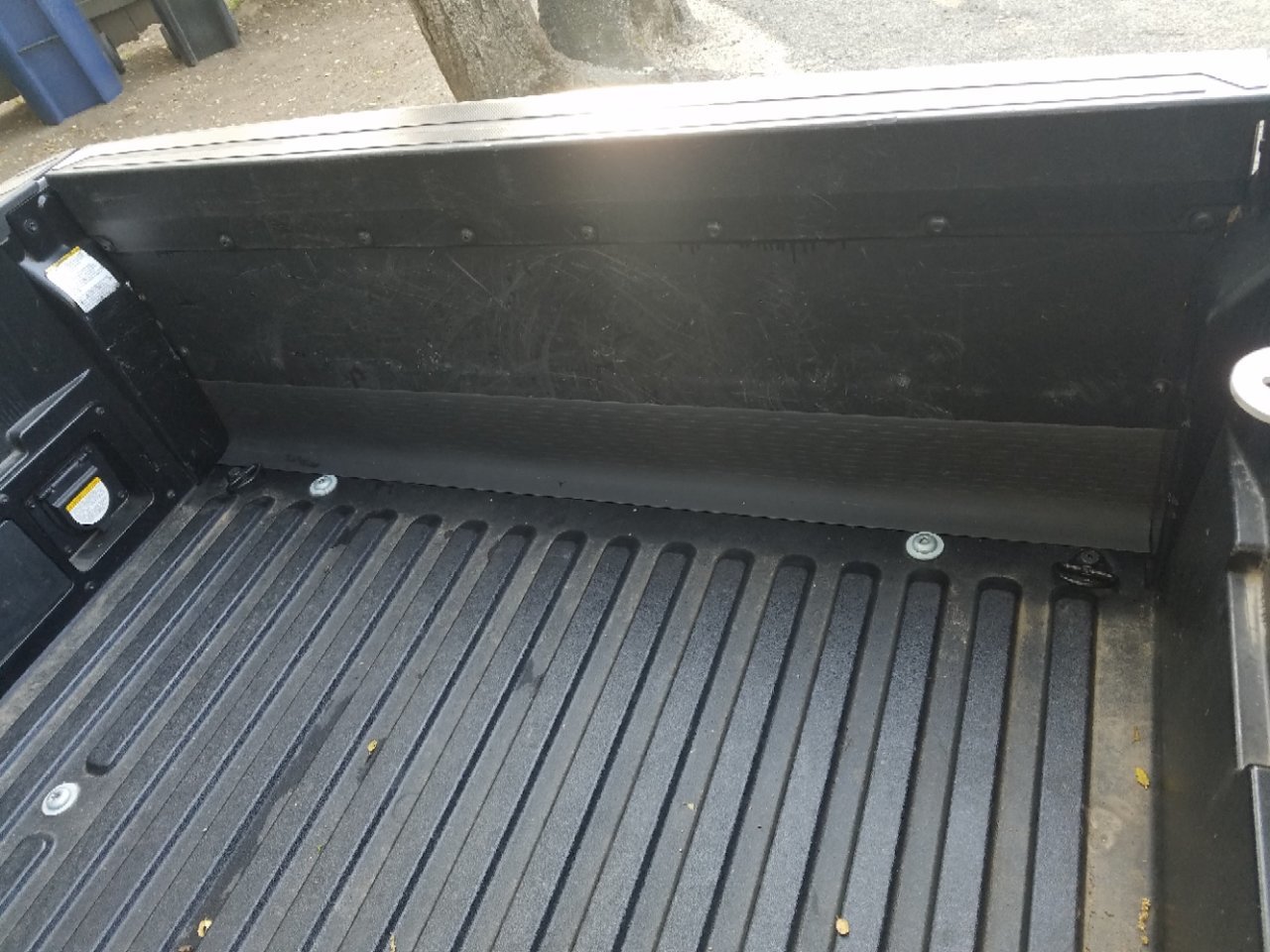

    Here's how the bed looked before the wash:
    All cleaned up. By the way, I have the PakRax State48overland tailgate panel found over here.

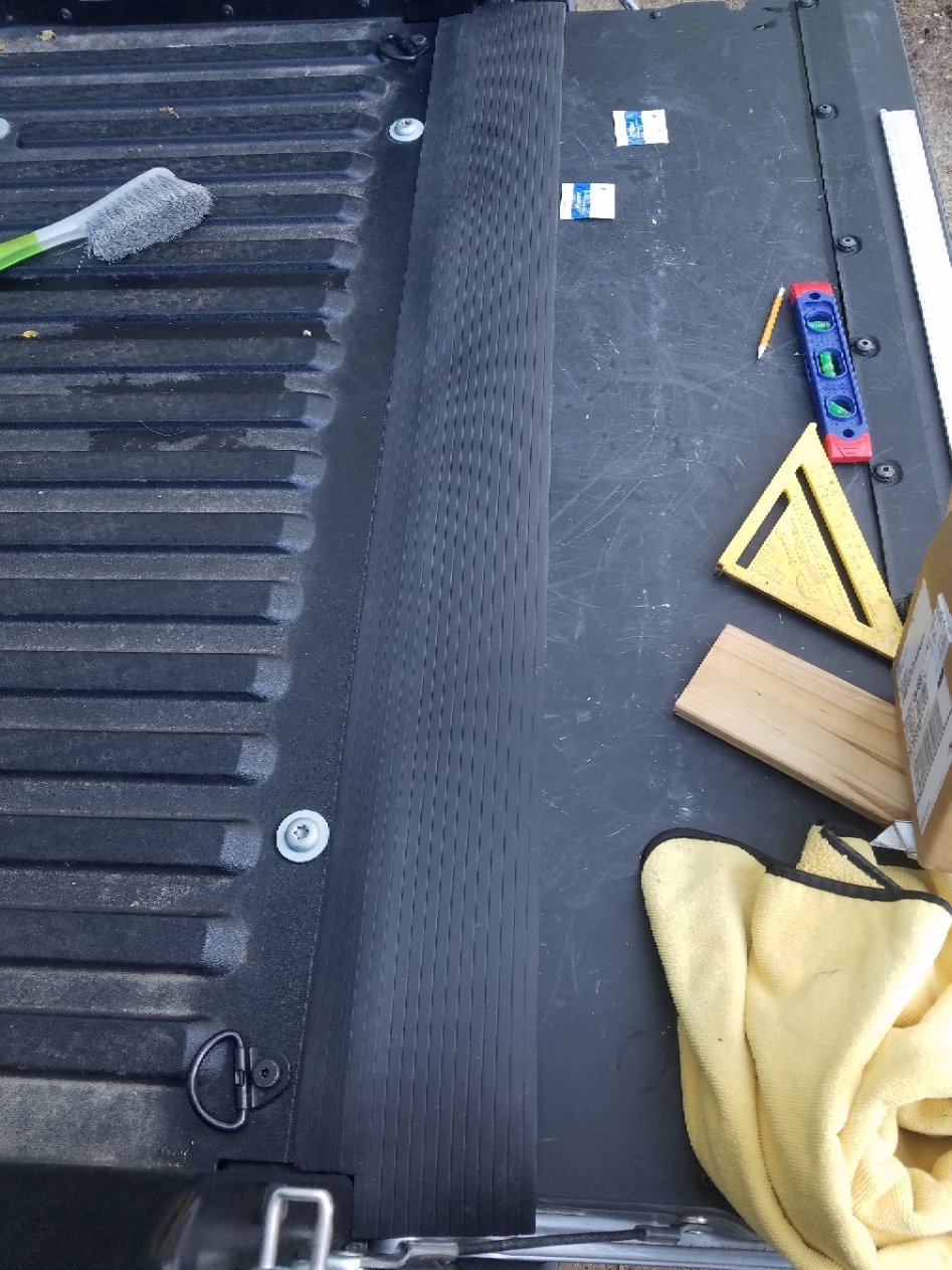

    Cut a test strip to fit:

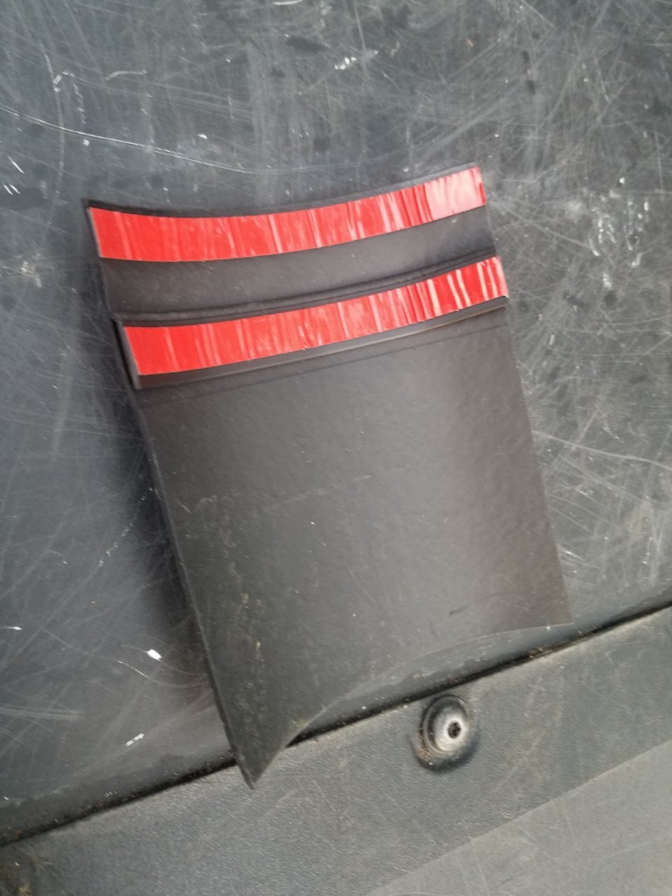

    Here's how it looks on the back:

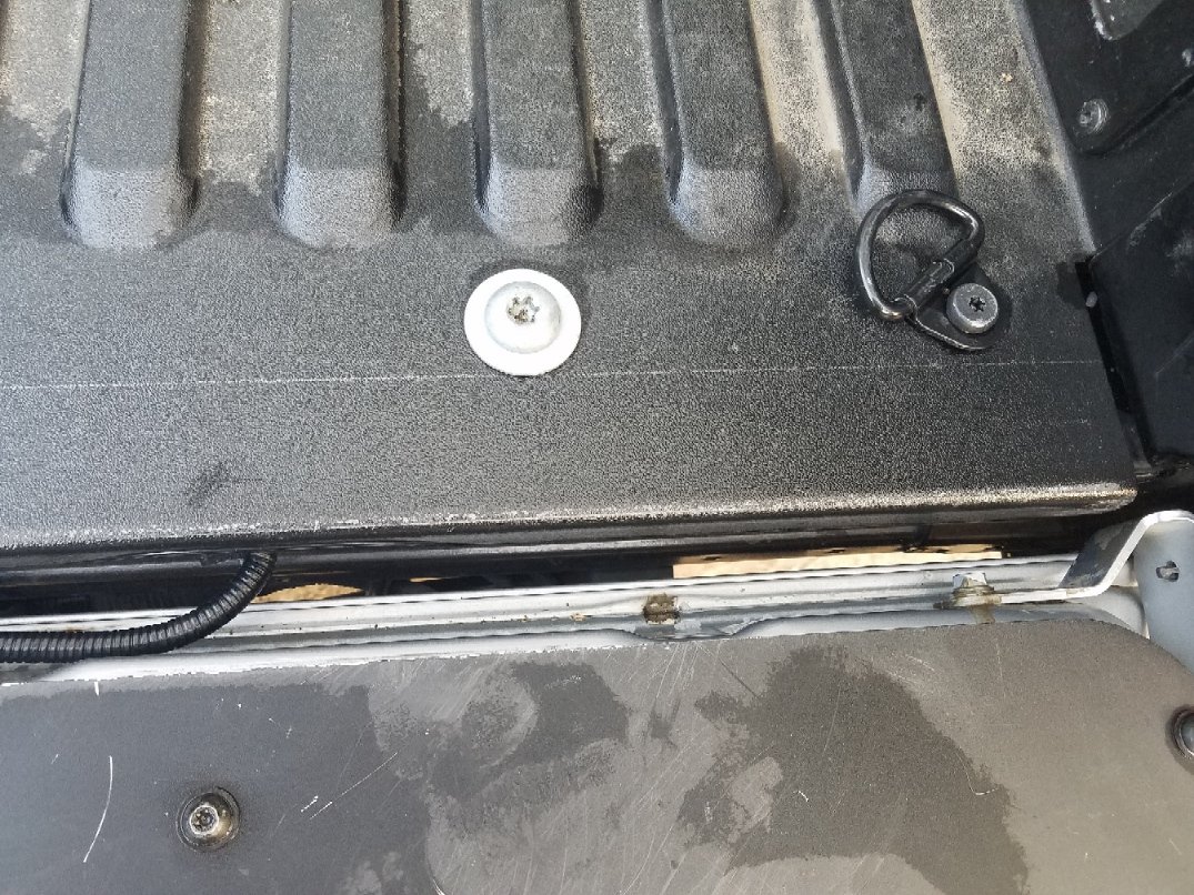

    Draw a pencil line at the silver washers:

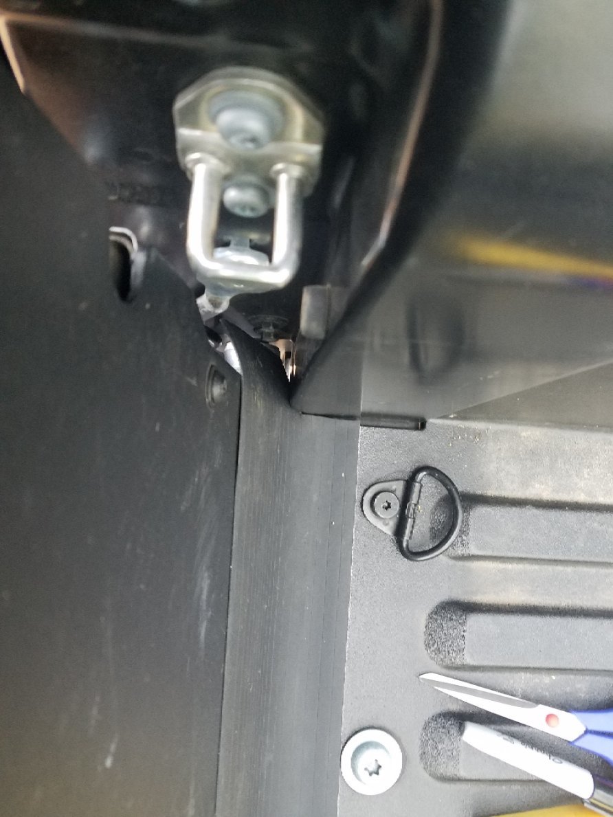

    Using a sharpie, utility knife and a cutting board, notch the 1st corner about 5 lines down and 1.25" over:

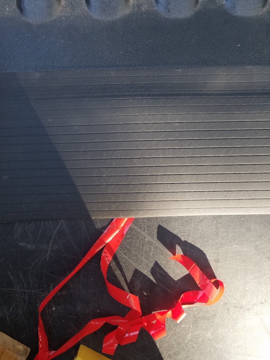

    Cut the Gapshield to length, notch the other corner (same as the other one), test fit to make sure it lays flat. Total overall length was 55-1/2":

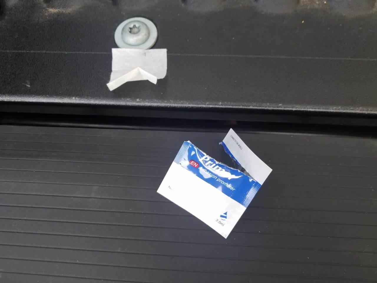

    Dry the bed, and prep with supplied primer:

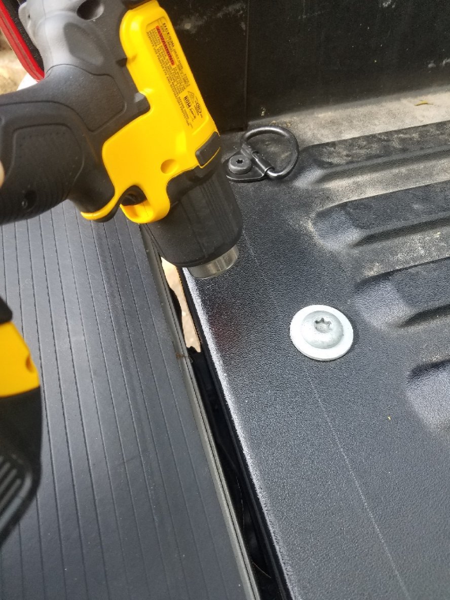

    Heat the surface for good measure if it's cold out:

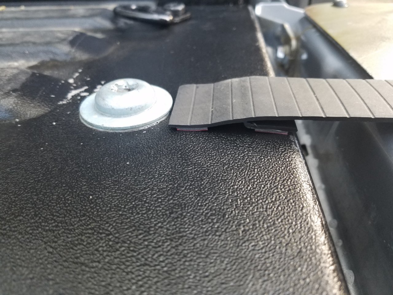

    Start by pulling off the backing tape and lining up the Gapshield with the pencil line:
    Continue pulling tape while pressing down on both sides as you go. Press 10 seconds for complete adhesion.

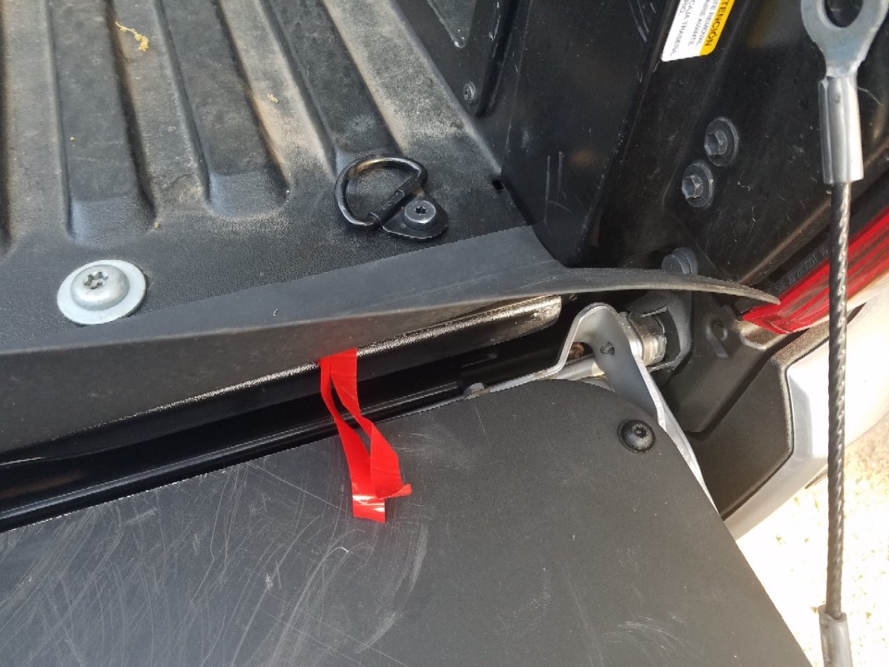

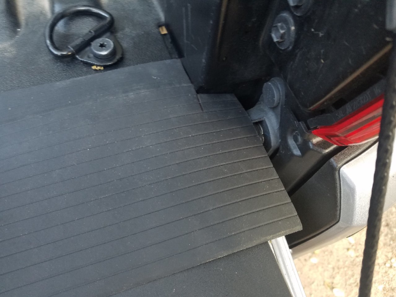

    Check edges for fit. Make sure they clear the bolts and tailgate cable:
    Trim excess where necessary:
    Crack open a cold beverage, and enjoy your new Gapshield! :cheers:
