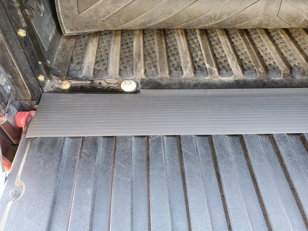

    For anyone on the fence because you have bed stiffeners, the shield works great (at least with Total Chaos). Thanks for writeup, OP.

    Good to know- I hadn’t considered if my bed stiffeners were in the way!

    Me neither until I looked at it and panic set in. The distance is just right where you can cut a part out and use the 2nd horizontal line in the shield as a score line. That takes out the forward most adhesive strip in that area but still preserves the rear most, which is the one the instructions make to be the more important of the two.

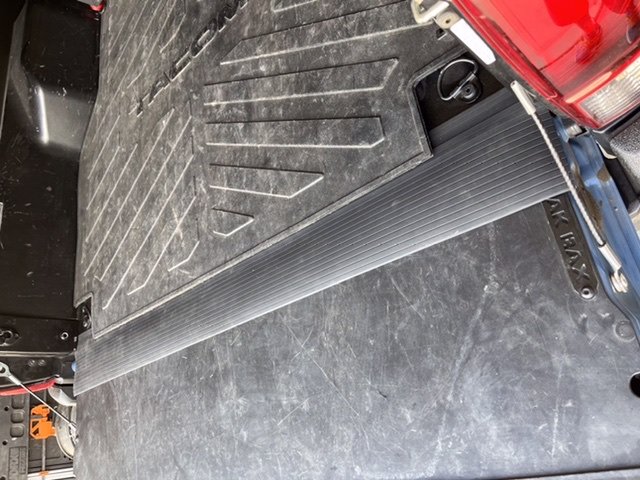

    Thanks for the write-up Ryan. Just put mine in and I’m very pleased. 208DE292-D235-4BCF-812F-A03601AA5490.jpg
