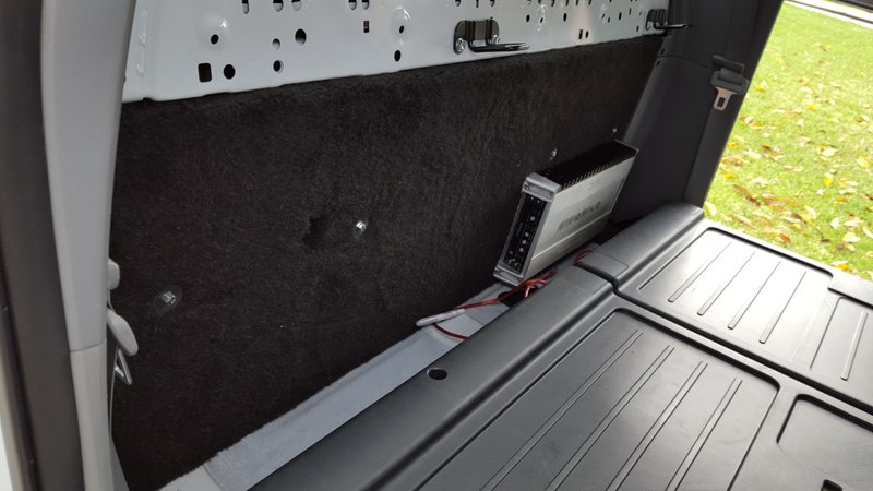

    Check my build log to see what i did for my amp, the way im making it is so i can slide my soon to be built box out and just disconnect the speaker wire if i need seats.

    I got my box from supercrewsound.com It's very high quality! They sell other configurations as well.

    That 3 inch deep amp has barely enough room, good luck fitting a type r and box back there

    This is my current setup. I'm considering taking your idea and just removing the rear seat and putting a quick connect on the existing subs so I can swap them when needed. Pardon the princess hat in the background, the subs are currently in the back of my wife's explorer.

    You need .85 cubes internal for each driver. Is that available using at least .75" material (consider bracing as well)?

    Take the amp off and put it behind seats with all wiring, and then put that thing on the under seat storage with the seat bottoms flipped up. Then all you need is but disconnect the speaker wire and slide out then drop seats.
