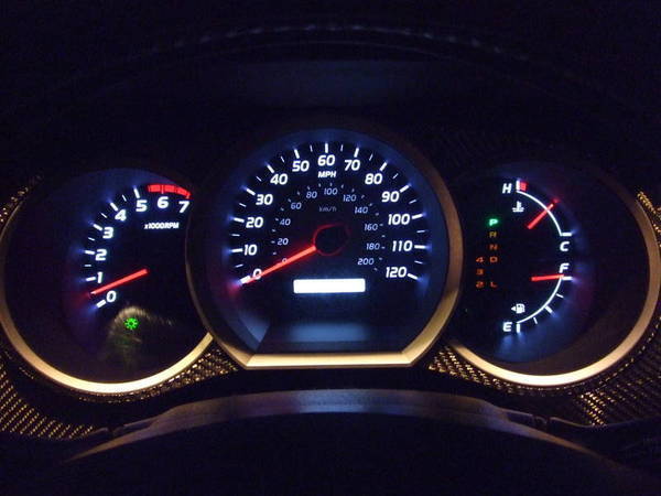

    so im doing this project with my dad. the other day we did everything as instructed but we only changed 1 light cuz its all we had time for, put everything back together and i had 1 blue light and the rest were orange so we knew we were doing everything right. Today we replaced all the bulbs and now to my surprise once we placed the cluster back in the truck and tried out the lights they dont turn on. Ive checked to make sure everything is plugged in and i messed around with my dimmer and nothing seems to work. We took it back out but we cant think of whats wrong. The weird thing is everything else in the instrument cluster works, the other lights and such. Anyone have any ideas on what went wrong and how to fix it?

    Soo clean...What would it cost to have this done at a shop?

    this was fairly easy to do. this was my first experience with soldering on a circuit card. http://www.oznium.com/plcc-2 this is where i got the LED's from. here is the directions i followed. not real descriptive on the actual soldering part but i figured it out. just a little solder on either side. the removal for the whole dash is in the link at the begining of the article. hope this helps.

    It has been a while since I first successfully put in my blue LEDs for my instrument cluster. I now have an issue with the lights on the gas gauge and temp not lighting up. Everything else is still blue cept for the right side and so my guess is that the leds are still connected correctly because the rest of my panel is working. Do I just need to solder on new LEDS for the ones that dont light up anymore because they have gone out? Just wanted to clarify before I go in for surgery =] Thanks!
