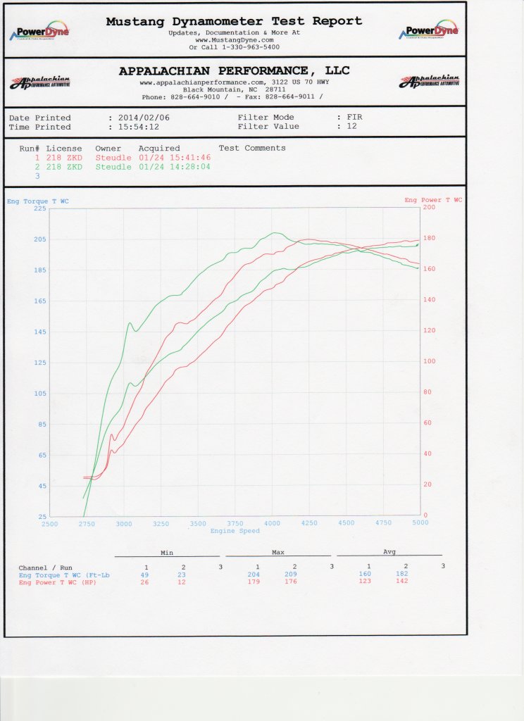

    Dynos run on:
    2005 Manual Shift Tacoma 4×4:
    ToyotaDynoStickShift-2014-1-24-1strun-ov_9e50df5ba754144ad29a68204a67247454111bb1.jpg

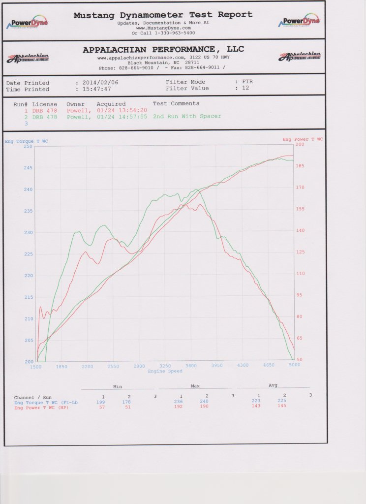

    2011 Automatic Tacoma 4×4
    ToyotaDynoAuto-2014-1-24-firstrun-overla_8135d149946884026a2a609cd9b55cd0cfe89485.jpg

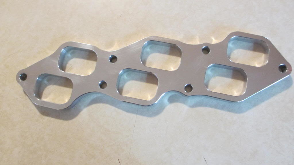

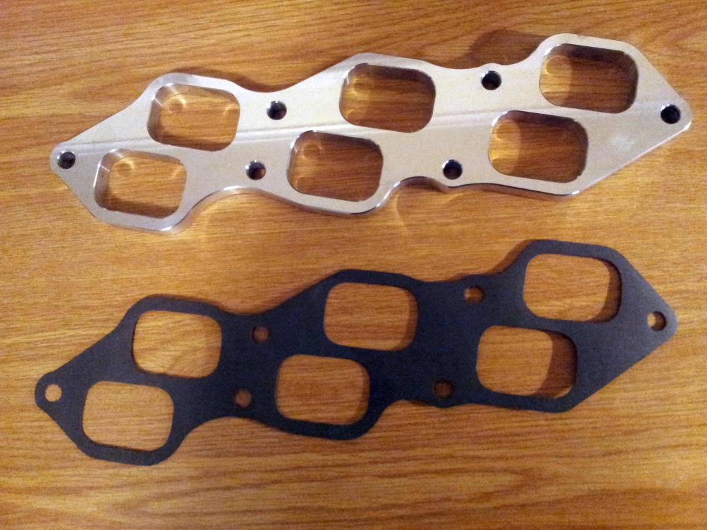

    These are the Toyota IMS:

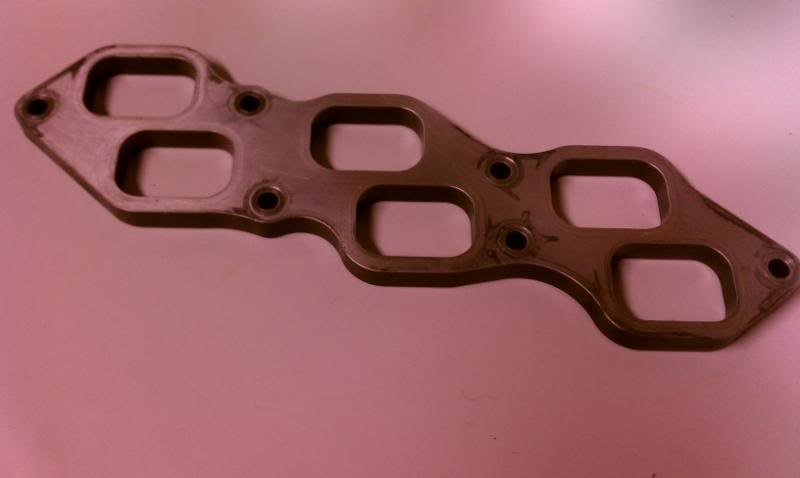

    These two pictures here, are of the first, and prototype manifold spacer that was made for the 1GR motor. I came with the idea a few years ago to a friend of mine. He is a member on here as well, and goes by Coupe. He is an engineer. I told him what I had in mind. Specs and all. This was the product of that.
    Due to my close relationship with NST (Non Stop Tuning.com), we worked a deal, and they have been selling them.

    Peak power 8HP is up high in the rpm at 5600, its 32 hp 23 torque in the lowend 2500-4800.

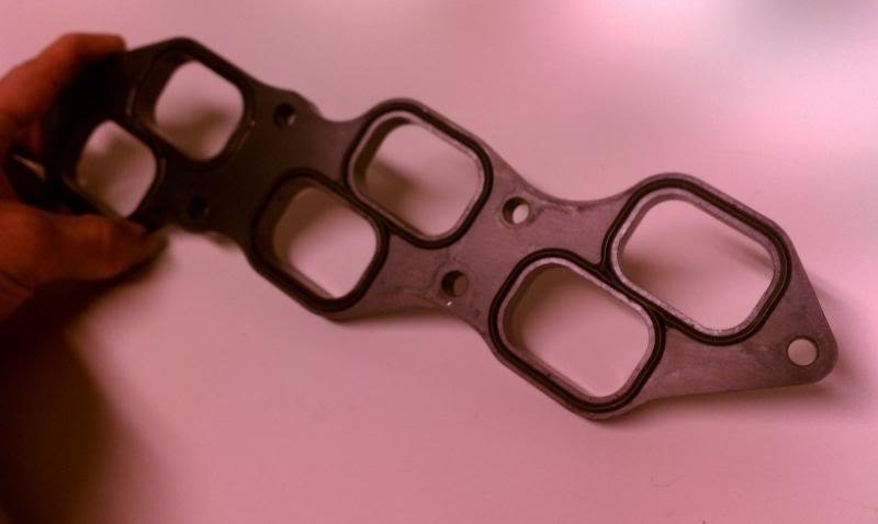

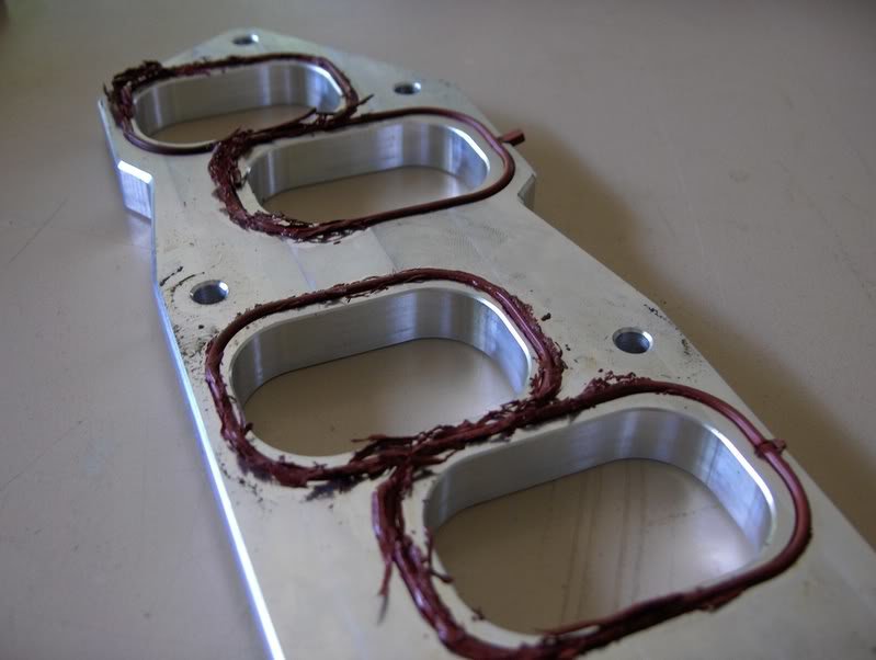

    I will most likely go the route of a flat paper style gasket and not do channels and rubber O-rings. In this picture you can see what can happen to Oring style gaskets if not properly machined as in the case of a guy who made Nissan IMS about 5 years ago.

    Eww. ouch.
