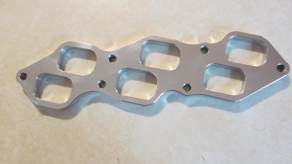

    Here are a couple glamour shots for you guys! Testing coming soon!

    Oooooooh! Shiny!
