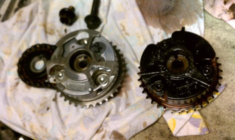

    Off topic yes, but what has to be done so that I can get my truck running properly. That way I can full length dyno run.
    USDM Tacoma intake cam gear on left, and JDM 4Runner intake cam on right.
