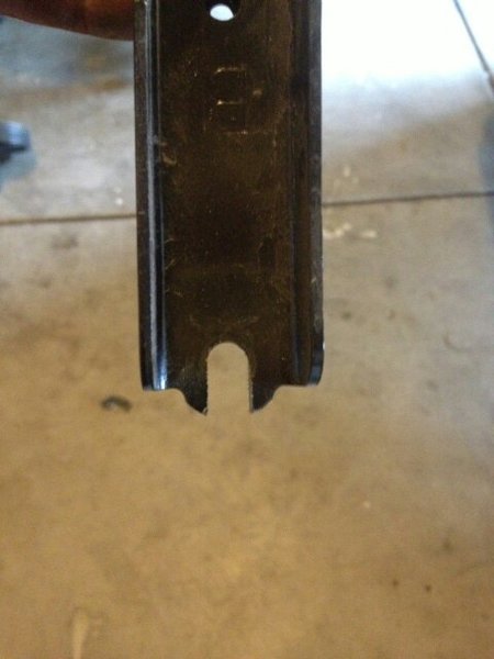

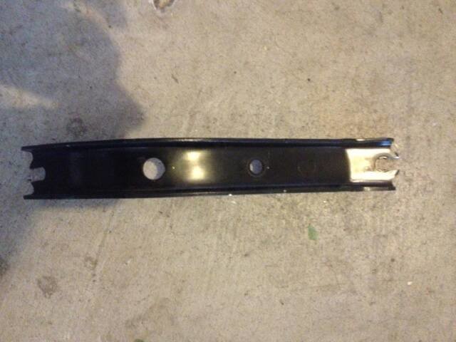

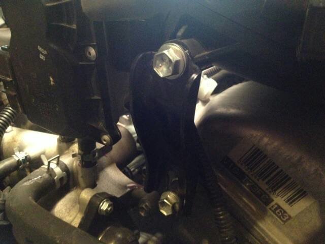

    So that buzzing sound is gone. i decided to try another round at putting back the mounting brackets or rather pinning them with the factory bolt. so i had a friend pull up on the intake manifold while i put the bolts into place, tightened them all down. No more buzz. so if anyone decideds to leave the intake manifold engine mount bolts out, you may get a little buzz and trust me its a little annoying. -- just a friendly fyi

    Here is what one member did using a dremel to be able to use the stock brackets and then bolt everything down tight.
