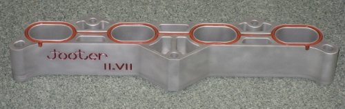

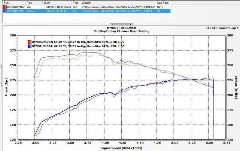

    Hi Jeff,
    I can only show you numbers for the 2.7 spacer. The comparison starts at 1,400rpm, and the red line is with the spacer and blue line is without.
    6b920d4e-139d-44b4-b563-1798b8418b14_zps_29037c40fc7fba41d6149d5635e5c124d90c223f.jpg
    The results weren't earth shattering, but still pretty decent for just a simple passive bolt on part. The difference between the 2.7 spacer and the 4.0 spacer is that that it's two inches thick which is like having four of the 4.0 spacers stacked on top of each other.
    This graph demonstrates that principle of lengthening the intake manifold runners to lower the torque curve is a sound one. Making the runners 12% longer and slightly enlarging the total manifold volume lowered the peak torque by 250 rpm while fattening up the curve a little. So intake manifold spacers do work. It's just a question of how much.

    No offense, but your graph is absolutely useless for anything besides the 2.7L 4 banger. Once you change engines, any dyno results get thrown out the window. What works on one engine might not work on another. Your dyno shows that the principle is plausable on the engine it was tested on, any other inferences are guesses at best. You don't have enough data to make the blanket statement that manifold spacers work.

    Jeff asked to be shown some actual spacer dyno results, and those are the only ones I have. The graph demonstrates the physical principle that long runners do actually lower the peak torque as well as improve the profile of the curve.

    Yes, but this is a thread for intake manifold spacers for the 4.0L, not the 4 banger. All your graph shows is that the length of the runner can have some impact on the torque curve. A vehicle that was properly set up to begin with will not be as influenced by manifold spacers and results can vary greatly.

    The only chart I have is for the 2.7 because that's the spacer I made. A prototype was dyno tested to find out whether or not it would actually work well enough to sell. It does, so the first production run begins this weekend. The chart demonstrates that the principle of lengthening intake runners lowering peak torque is a mechanically sound one. I just needed to know exactly how much improvement it would make.
