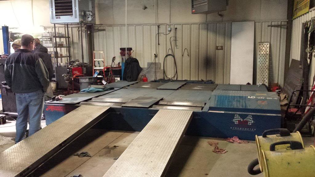

    The results are in! Positive results! Do not misinterpret the Max HP/Torque, these spacers are not designed for max power up high. You need to look at the results in the 1500-4000 ranges. The Dyno was a Mustang Dynamometer.
    Two very nice members donated time and drove here from 2 hours+ away each to dyno their trucks today. 1. 2005 Manual Shift Tacoma, and 2. Automatic 2011 Tacoma. (correct me if I'm wrong on that guys) We ran both trucks with a spacer, and without a spacer. Both showed gains. Like I stated first, we are not going for numbers up high in the RPM range but in the low/midrange useable power range. Here are a couple pics, vids, and of course dynos!
    click the truck pic for the video
    Thanks guys! Things went well and I was glad to meet you guys, hope to hang out again some time!
