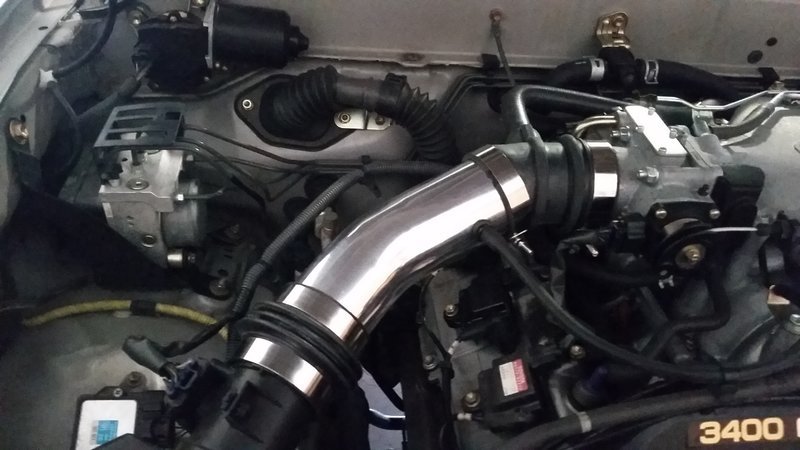

    theres a thread not to old that shows how to replace with aluminum tubing.

  14. Aug 10, 2017 at 2:39 PM
    ecgreen
    ecgreen overeducated redneck
    Sep 1, 2015
    #163187
    1,480
    Sean
    2015 4x4 4-banger Access
    Junkyard
    COMAtized99 likes this.
