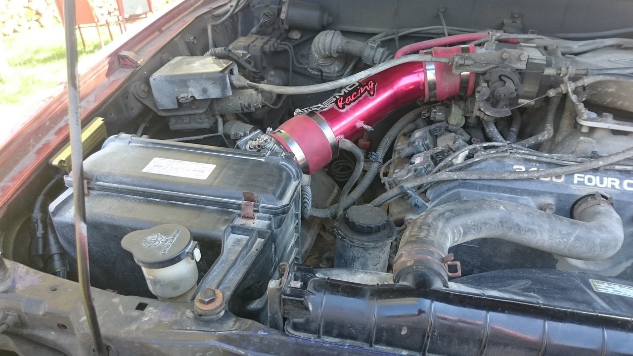

    Since the spectre flex couplers are $30ea it wouldn't be so bad if I could find a cheaper alternative

    edit: my math was a little off, I just rechecked and had 90.48...not so bad

    For reference the OEM part for the 3.4L V6 is 17881-62130 and costs $95 at Camelbak toyota

    I replaced mine with an OEM one off E-bay. Paid about $80.00 or so. My old one was losing pieces every time you touched it. I like the stock look and it has all the ports and such for the silencer and J-channel water catch thing. Plus - it fits. Amazon has them as well.

    I must have gotten a Super Good Deal 3 were less then $100.00 then it was a few years ago time flies

    i thought it was in that other thread but its not. i used a $60 ebay intake. had to cut a few inches off it.

    just the regular $5 silicone couplers should be fine imo. thats what most of the aftermarket ones come with

    its actually cosmo racing. more convenient than buying regular tubing because it has all your vent tubes prewelded on.
    NOTE: 95-98 uses inline maf. but im pretty sure ive seen people use newer style with the factory housing

    my filter would get clogged with snow in the winter time causing truck to bog. I was gona put all of stock airbox back on but my stock tube was super brittle.

    no the exposed pod filter on the "cai" well. i guess i cant say it wasnt cold at that point

    ah gotcha. I'm not a big fan of how exposed they are even with a shield for that reason
