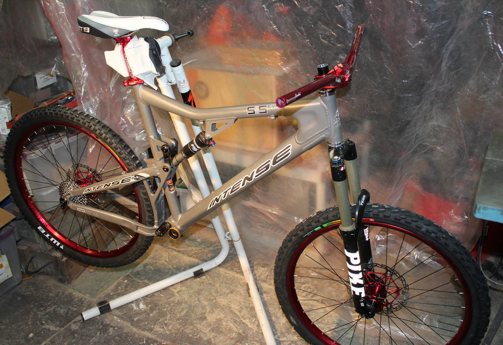

    So its nice to see a lot of Taco owners into Mtn Biking. While there are good Mtn Bike sites out there, I spend most of my time here, so I thought I'd share with y'all. I've been collecting parts for a while and only recently have started the assembly.

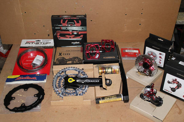

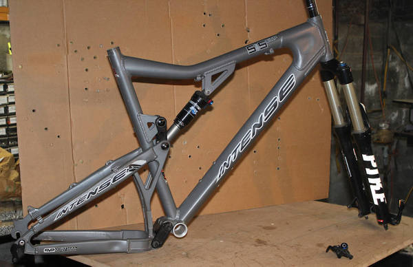

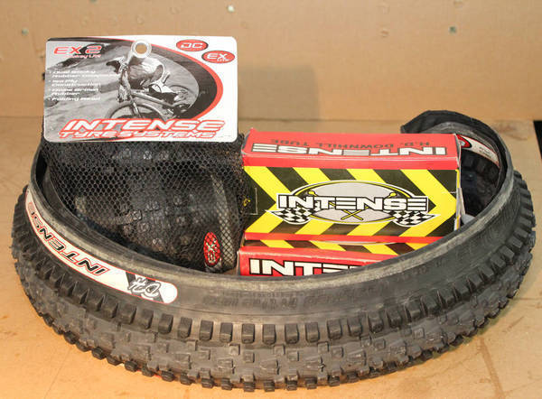

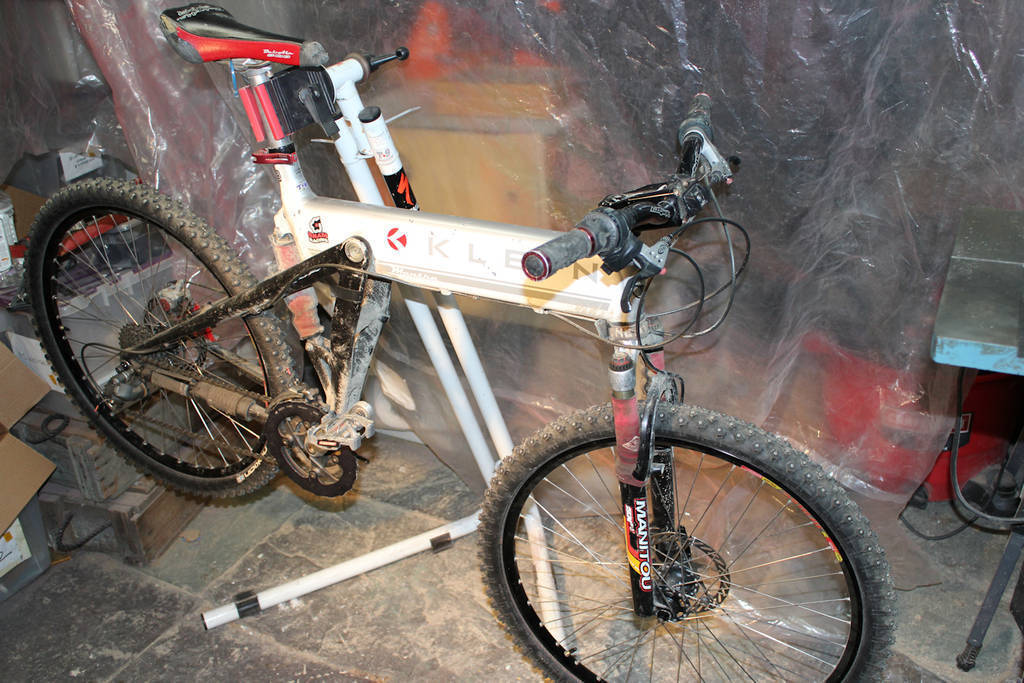

    Started with a used frame/fork from a local mechanic.
    Intense tires and tubes

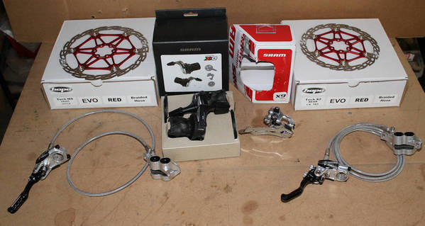

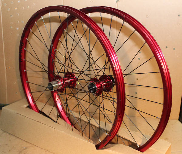

    Azonic Outlaw wheelset

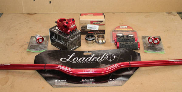

    Loaded Handlebars & Stem, Race Face Stainless DH headset & Hope goodies

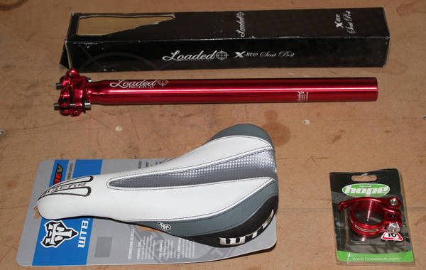

    Seat & Seatpost
    Sram X0 drivetrain with Race Face cranks & Crank Bros pedals
    Hope Tech M4 brakes with floating rotors and braided lines

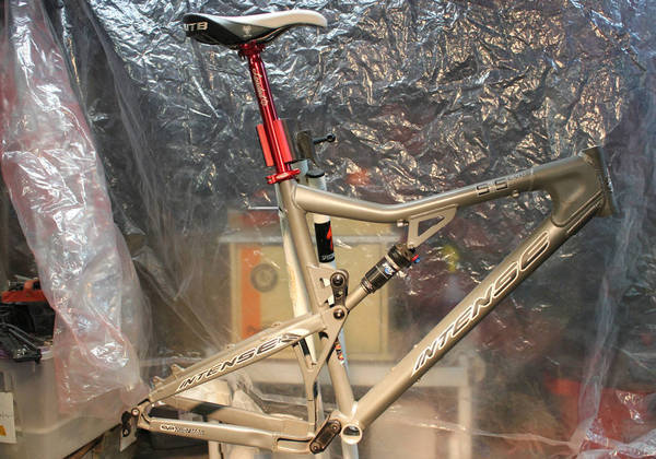

    Started Build 12/31/11

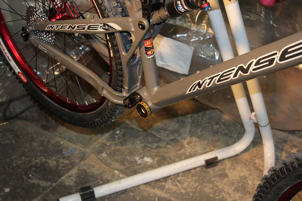

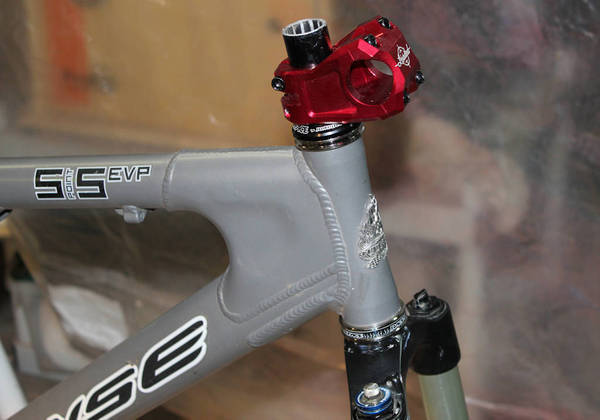

    Pressing in bottom S/S cup
    Both cups seated

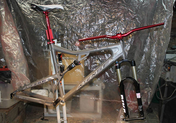

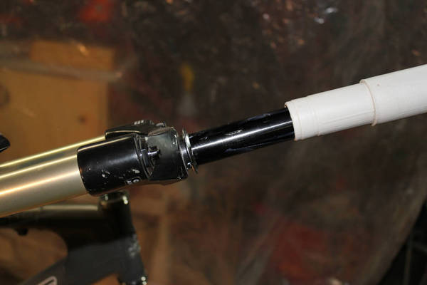

    Installing race on forks with plastic tube

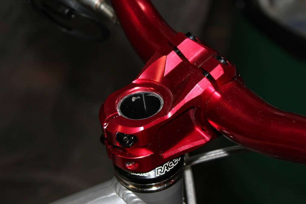

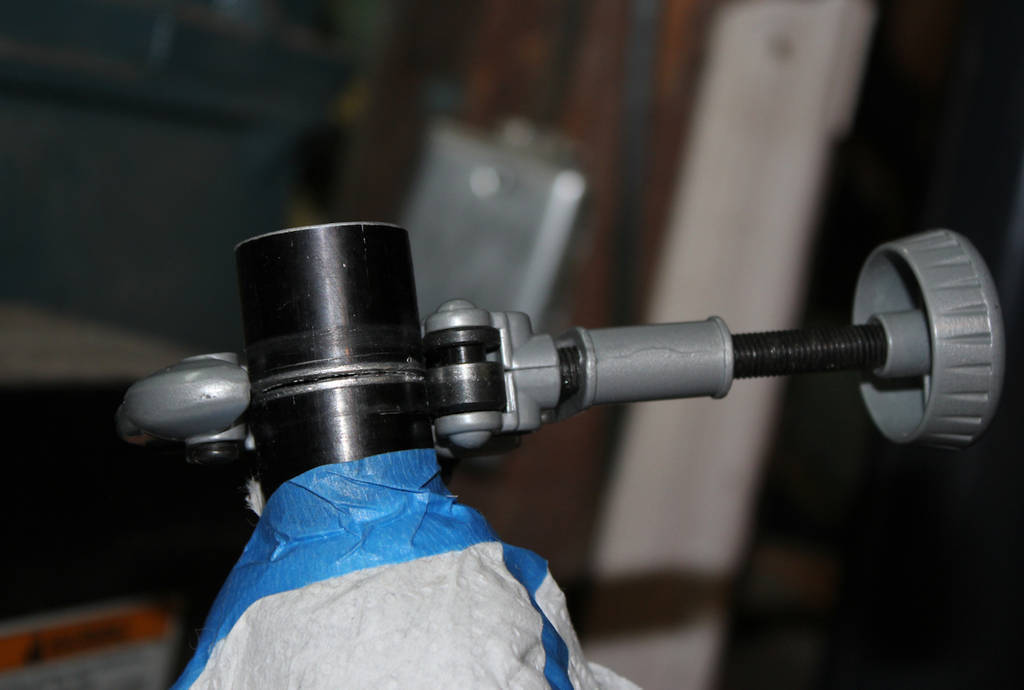

    Loaded Stem (will trim steerer tube very last)
    Loaded Handlebars in place

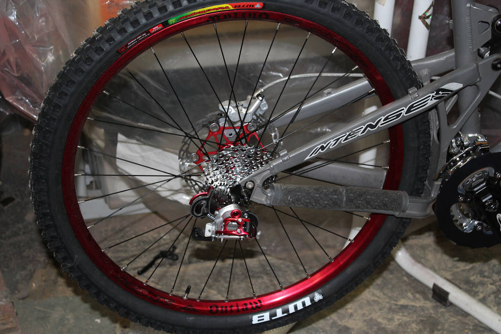

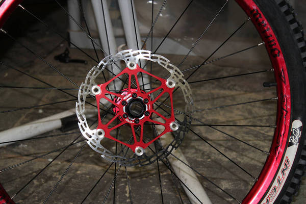

    Installed tires & rotors
    Race Face External BB installed

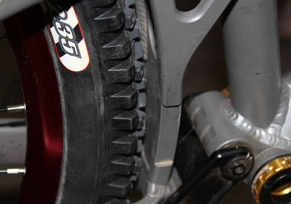

    Wheels in place, went with front 20mm Maxle and std QR in rear

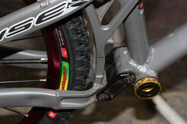

    But the 2.35 tires have very little mud clearance

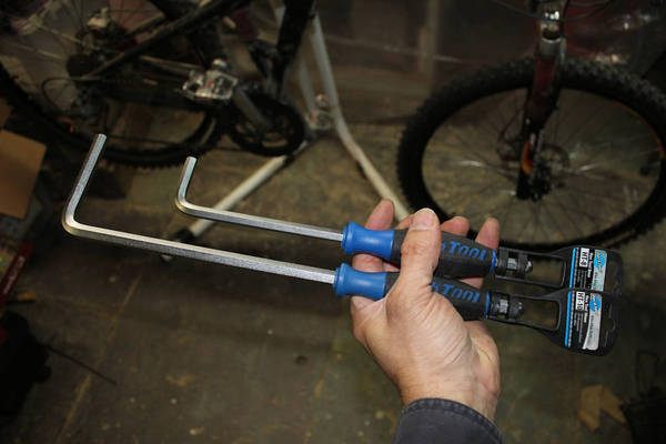

    New 2.10 Velociraptors on order as well as new wrenches to install rest of the Race Face crankset.
    01.11.12
    New tires arrived and I installed them this weekend. Better clearance!
    Also got some big ass crank arm wrenches to finish up the Race Face install.

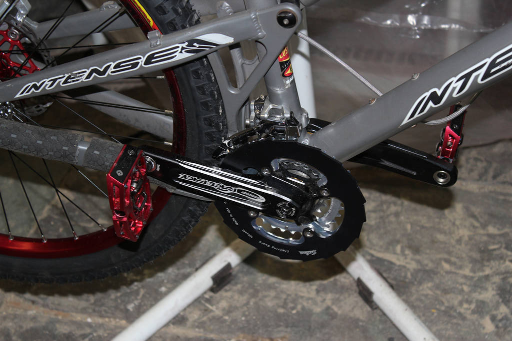

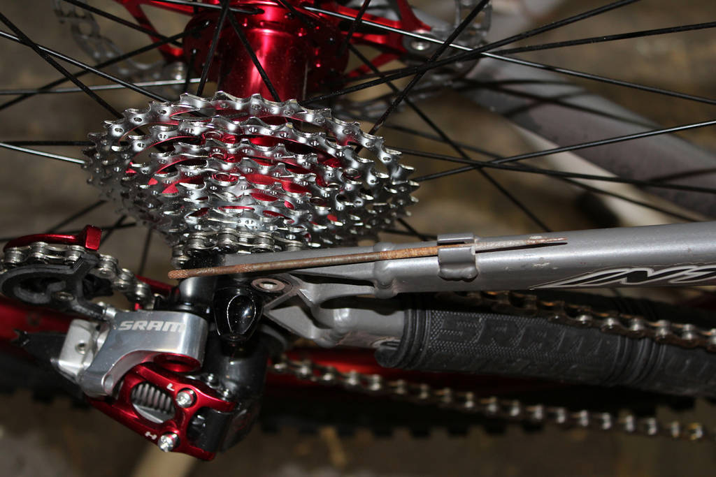

    Cranks, bash guard, rear derailleur and brakes installed
    Sram XO rear derailleur
    Race Face cranks with Salsa bash guard and Crank bros pedals

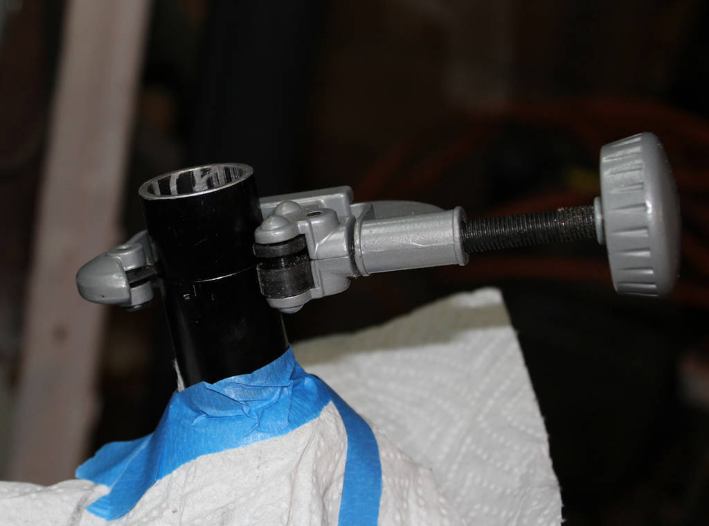

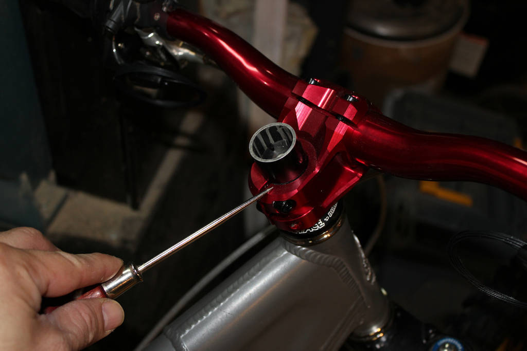

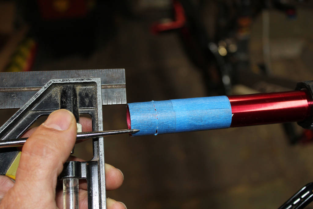

    Marking the steerer tube for cutting
    Locating the cut about an 1/8" below scratch line
    Cut progress

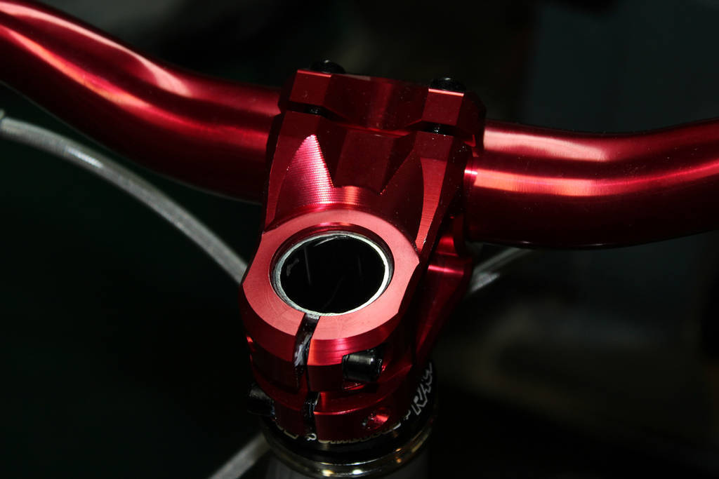

    I deburred the inside and outside of tube and reinstalled stem
    Top of tube sits slightly shallow of top of stem

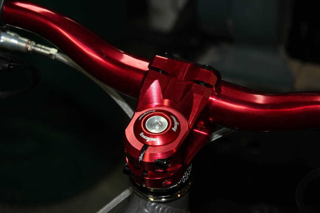

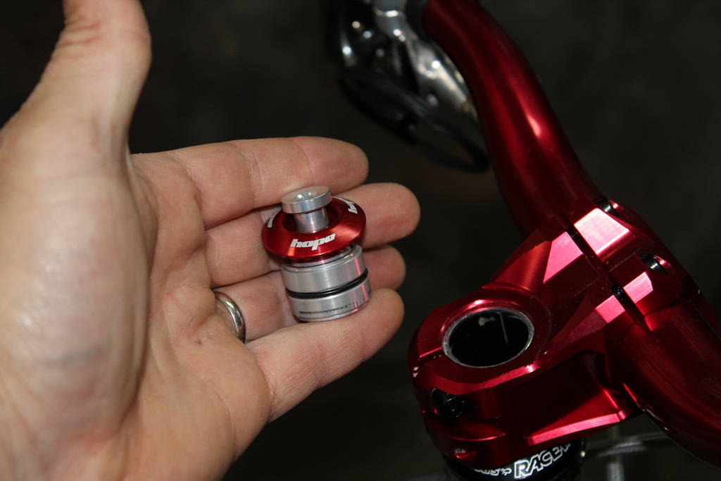

    Hope Head Doctor
    Head Doctor installed

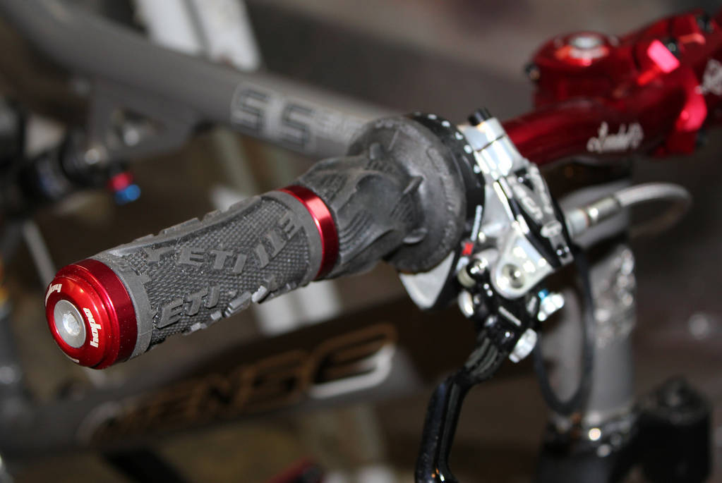

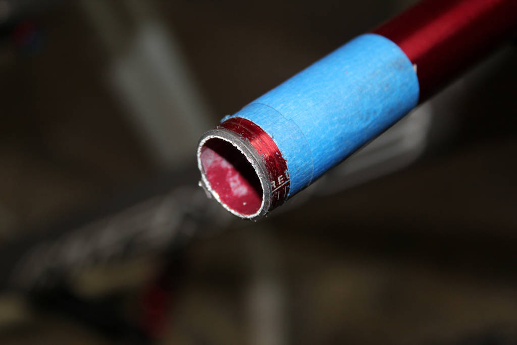

    Bars were a little too long, so I marked the ends for trimming
    End cut before deburring

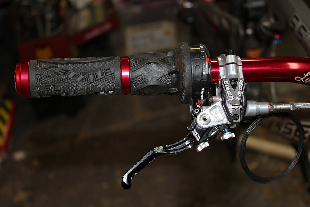

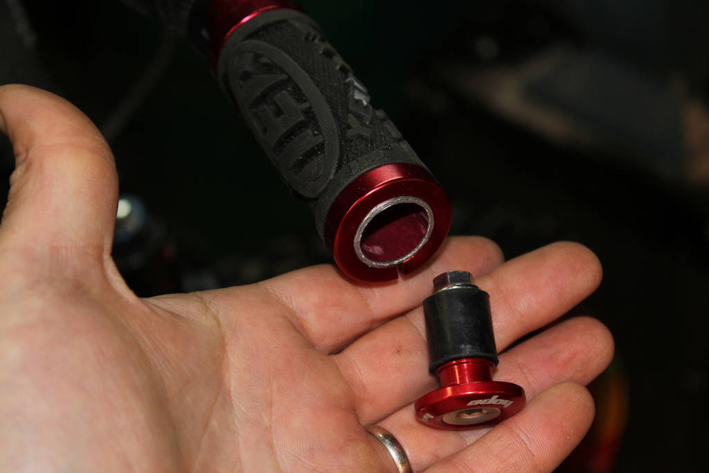

    Deburred end and Hope Grip Doctor
    Grips and Grip Doctor in place
    Hope Tech brake lever installed
    Rock Shox Pike remote lock out

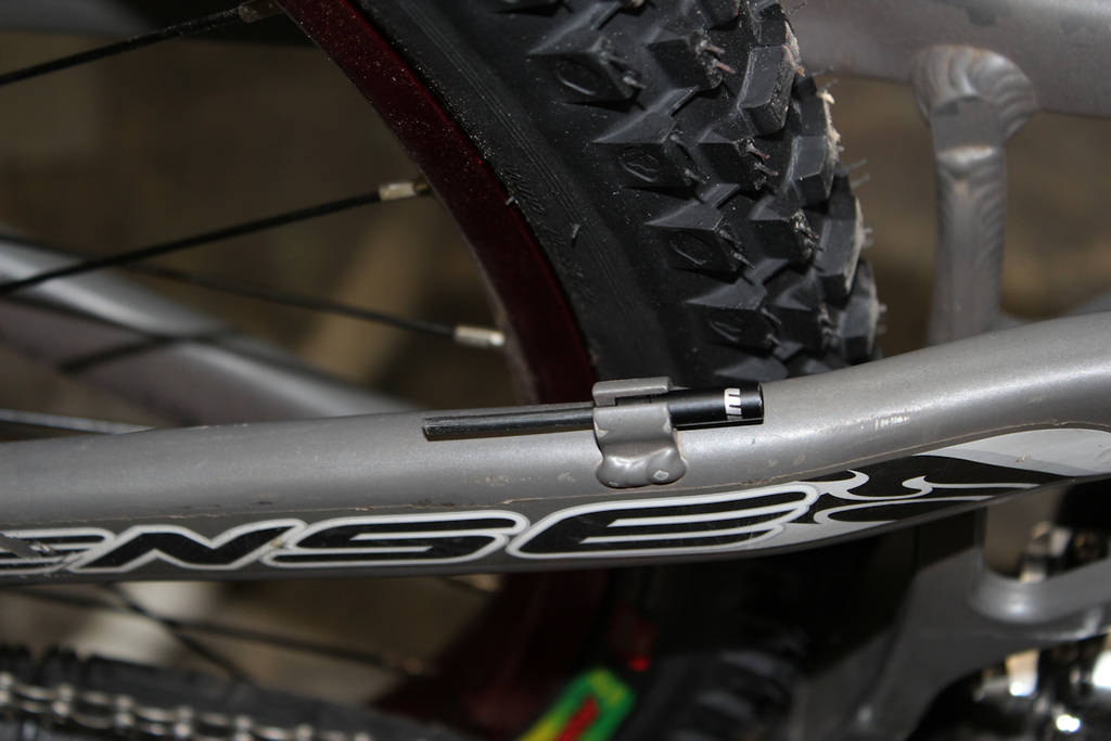

    I had to file the housing mounts to fit the Sram ferrules
    Ferrule test fitting

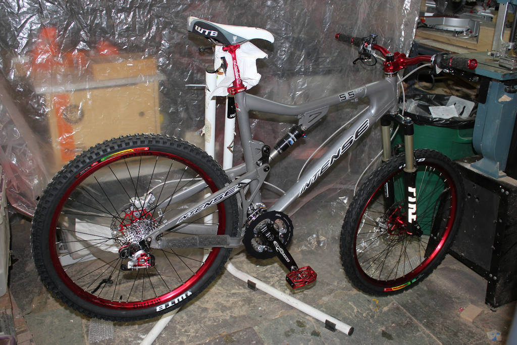

    That's about it so far, I have to route all my cables and set up my brakes. I'm having a bit of an issue right now with my rotors nicking my brake mounting adapters, I may end up taking a little material off the mounting adapters.
    03.21.12
    Finally got around to finishing it up.
    I had issues with the Azonic wheels not lining up true in the frame or forks. With the Maxle front, I finally fabricated a washer to insert on the disc side that fit into the recess of the Pike shocks.
    I installed and routed all the cables.

    After everything was in place, I bleed the Tech levers and M4 Hope brakes then centralized the pistons about the discs.

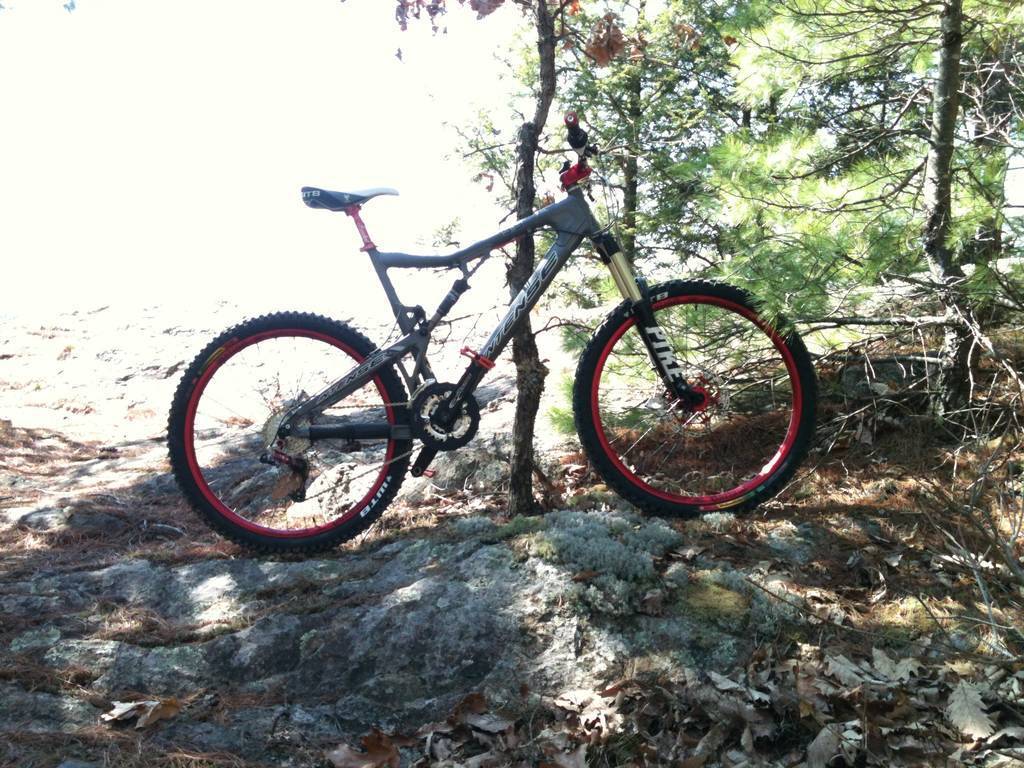

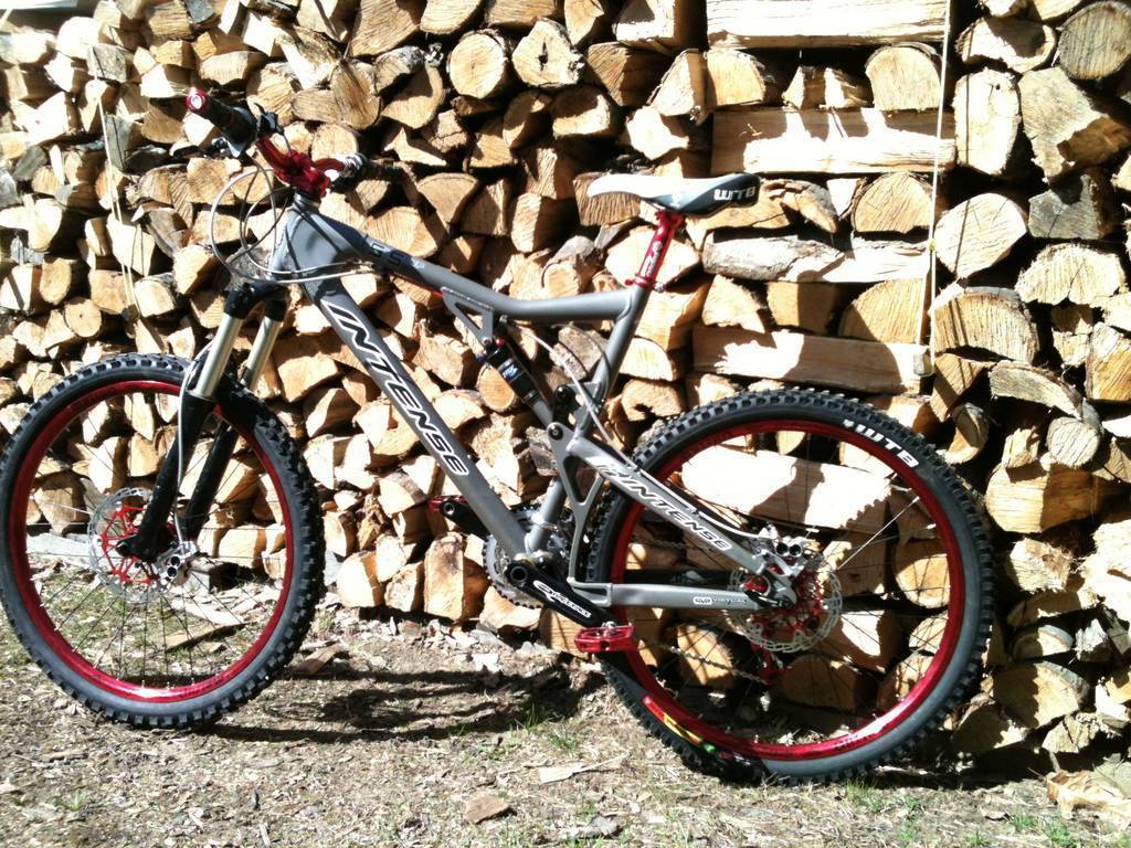

    Finally took the beast out for its virgin ride.
    In the driveway:
    On the trail headed to the local summit:
    On summit:
    Detail of summit with Adirondacks in background:
    I didn't get too crazy this time out as the brakes hadn't bed in yet, but all worked great!
    I locked out both the forks and rear suspension for the climb and let her loose for the decent, plush yet agile !

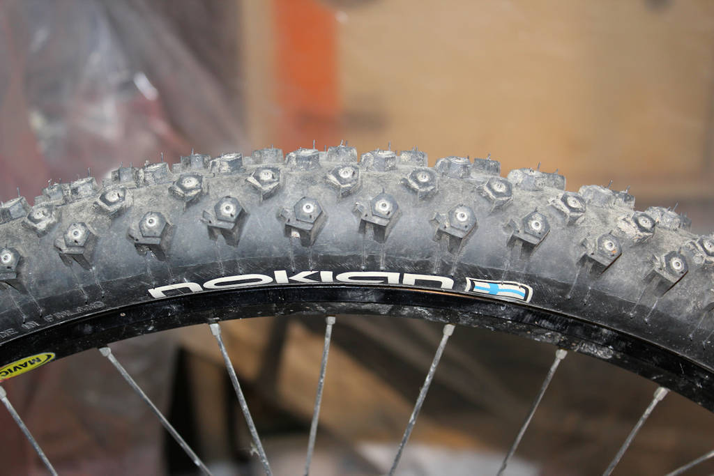

    ^^ I'll have to try the High Rollers out. Those VelociRaptors are new, hadn't run the rear before. But I have had good success with the Smoke/Dart combo as well as Hutchinson's "On the Rocks" rear specific. These were close to those in tread pattern. I change tires out quite a bit for weather and terrain. These are for the soft tight singletrack around here. In the picture..the yellow ones, Hutchinson's Pythons are what I run 95% of the time on my Mantra. This is my current stack, I know I have more tires laying around somewhere. The green ones, Michelin Wild Grippers are wicked fast. I do have a tendency to pick tires with high edge knobs. I steer a lot with the rear tire, digging into the corners .
    These are what I'm running right now for the winter on the Mantra
