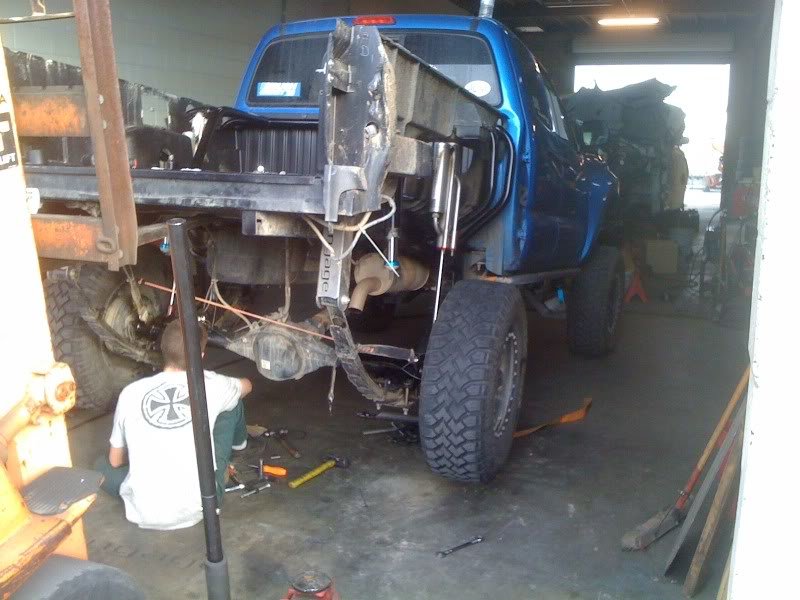

    extreme example of the extra droop a shackle flip can get you!

    How does a shackle flip effect ride quality? After TSB springs and an Icon 3 leaf add a leaf, my rear end is stiff and kicks like a mule with the OME shocks, which are supposed to be pretty mild shocks. Id buy if it fixes my rough rear.

    shackle flip wont effect ride quality itself, but it gives your extra down travel which allows you to mess more with your shock valving. If your rear end is stiff on the street, it is probably because your leaf springs are too stiff and a shackle flip will not change that.

    However, depending on how you position the shackle, and if you get aftermarket shackles - you can get more lift from the shackle and potentially remove a leaf or 2. This should help ride quality, but keep in mind it will also hurt the bed capacity - so if you put additional leafs in to prevent from the rear hitting the bumpstops when you have some mulch in the bed for example...
