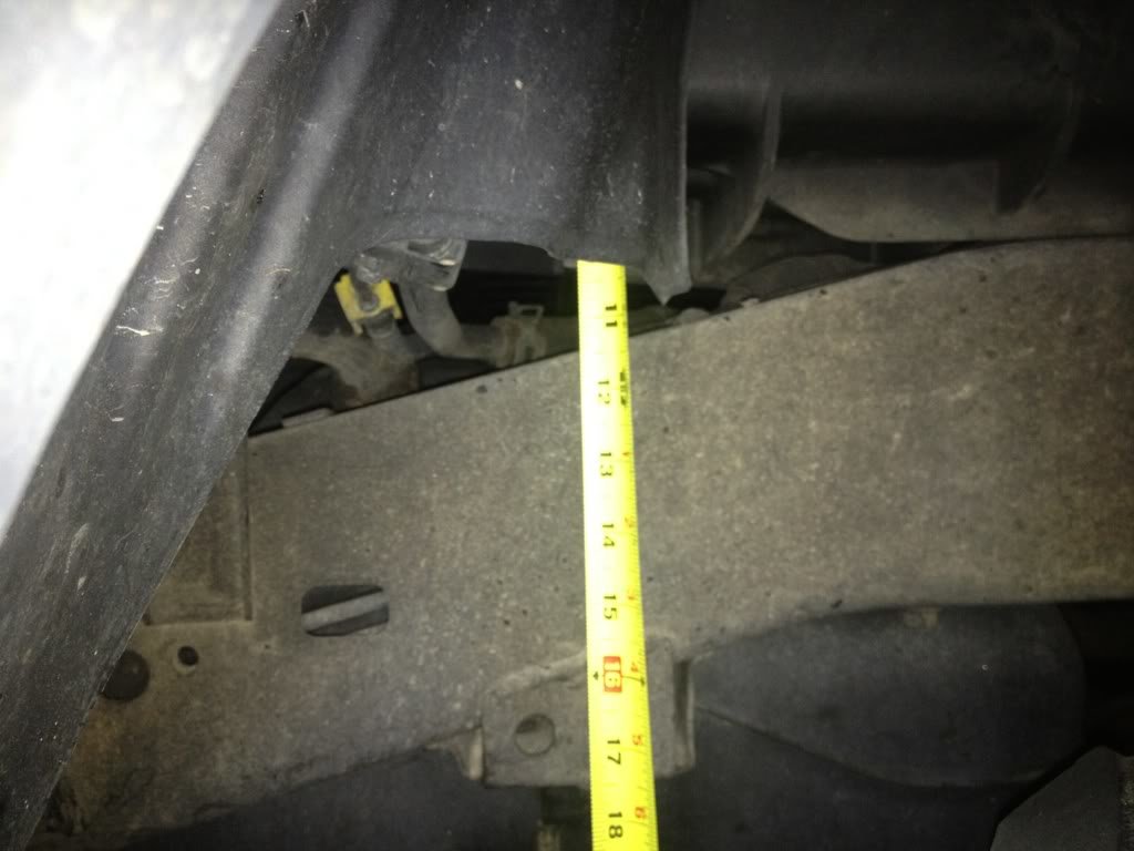

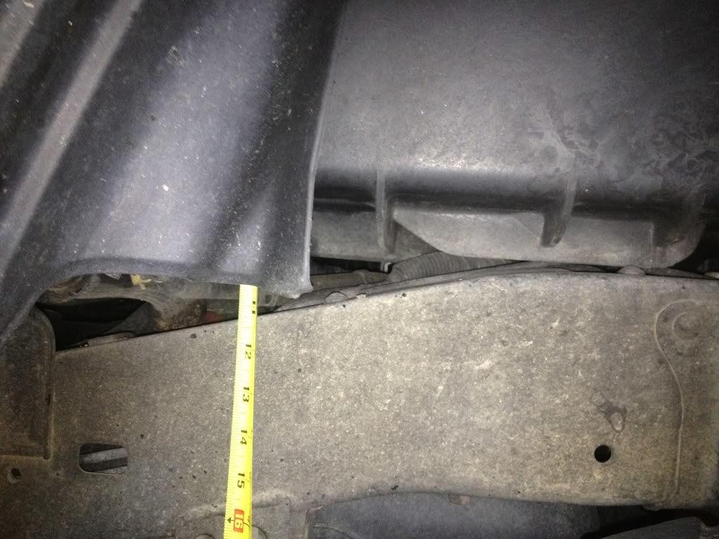

    Looks like it will fit from the pics and measurements.. Were you saying it has to be mounted on it's side? Since the eyelet mount is oriented for pivoting outwards (which is not the motion of our shocks) it would cause the top eyelet mount of the ford bracket to bend right? I believe both eyelets need to have its poivoting axis parallel with the driveline.
    I guess if it fit and mounted completely vertical it could work? Unless a 90 degree eyelet converter is out there too....

    You have to drill the factory holes out a little bigger. Other than that, bolt on.
    The importance of the eyelet orientation is going to vary depending on the angle of the shock compared to axle travel. I'll look closer at it when we install the prototype this weekend.
