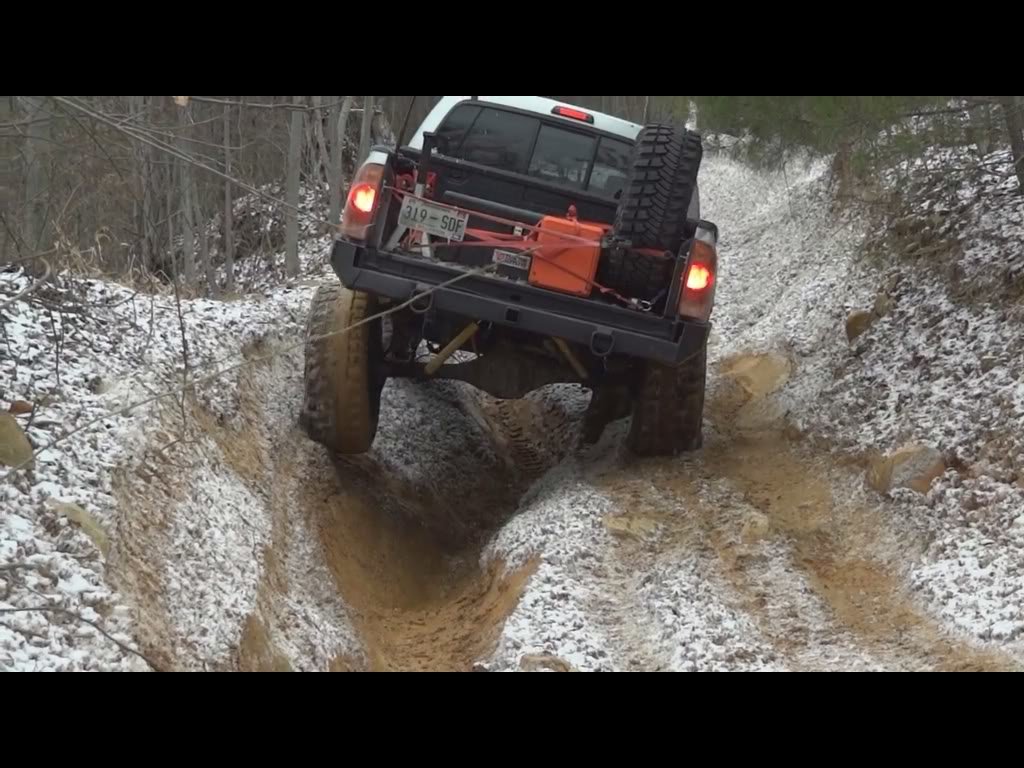

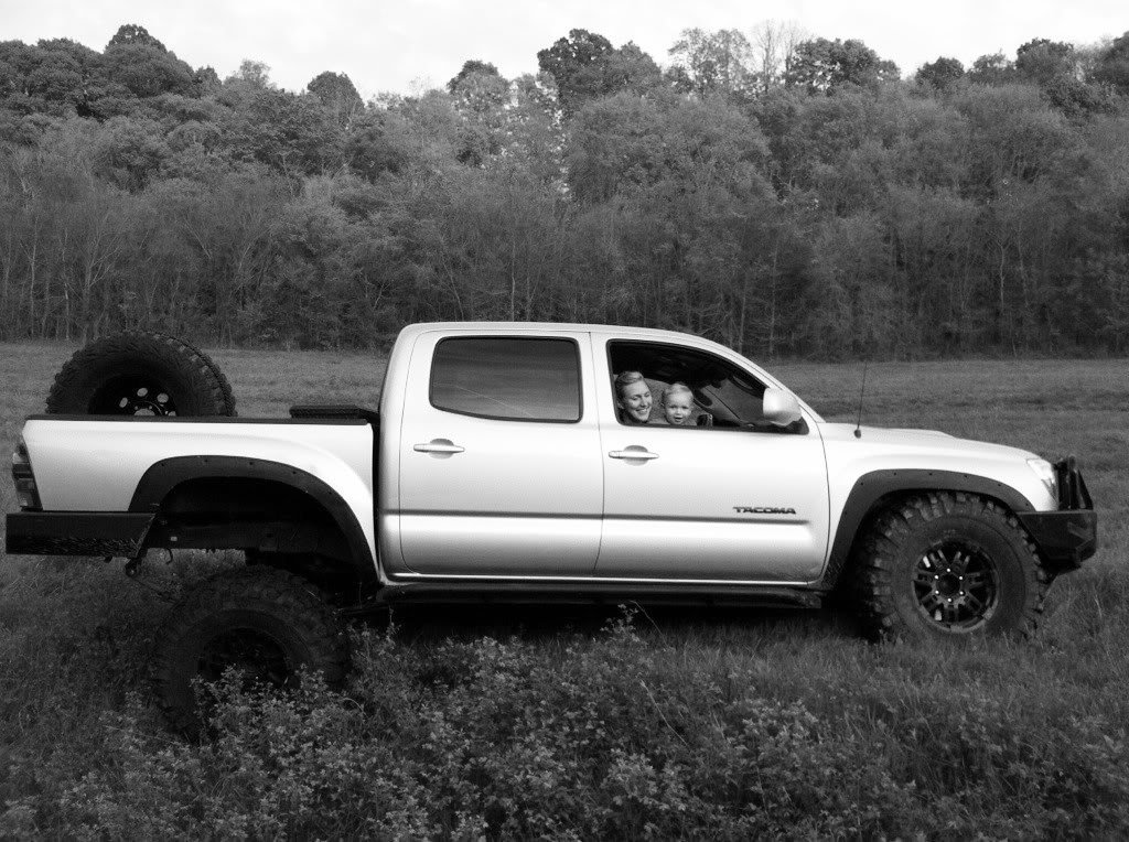

    2234a453_dc41032fd594fca9562d0975c945b39318c00442.jpg7c5adbb4_a77bca41d9e5b9f529210deec7b77b03523ce439.jpg
    A little motivation for installing the flips

    Installation went great! Took us about 6 hours with some breaks in there, so easily doable in a day. There's a few detailed things to watch for so I'll include those in the instructions. 285/75's drop almost completely past the rockers now. Both pics above are with the tire just starting to lift off the ground. It gave ~1/2-5/8" lift on Scott's truck. Every truck will be slightly different, so I'm going to say expect 1/2"-possibly 1" depending on set up.
    I'll start the production run this week and should be ready to start shipping in 2-3 weeks. I'll have final numbers later in the week. More pics in a bit....:spy:

    With running stock length shocks a flip kit is pointless. I went with the stiffest 10" 6100's they make. They ride as good or better than stock. And with 20" of travel it's a good upgrade.
