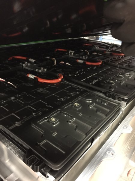

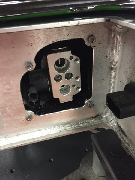

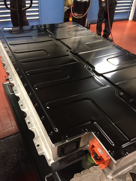

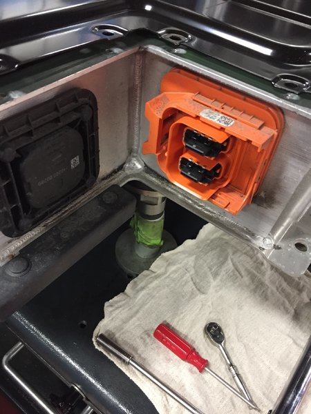

    Batteries aren't as big a problem as you think. I occasionally replace cells in our electric/hybrid cars. The battery packs can be designed in such a way that it is basically the floor of the vehicle. It drops out as an assembly once you evacuate the dedicated a/c system. Total weight of the unit is about 280 lbs.
    Here's a few pics from a car recently that needed one of its 96 cells replaced.
    sealed battery unit/basically the floor. In the pic it looks larger than it is. The measurements are roughly 3 feet by 4.5 feet...weird camera angle I guess
    Showing the 96 cells
    High voltage connection
    A/c connection with expansion valve
