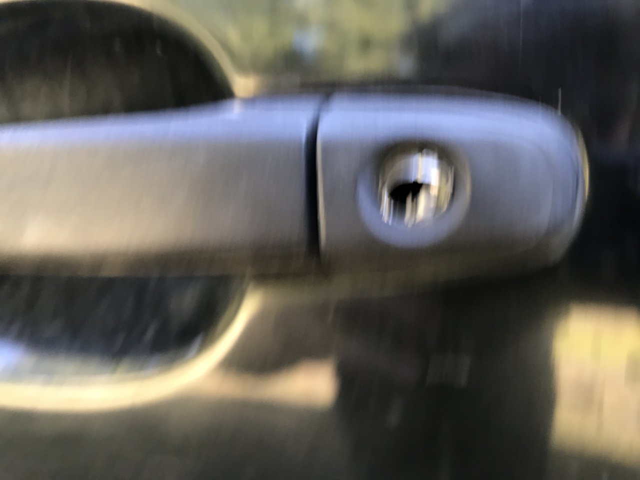

    I didn’t really address this because like a fluke this stuff started working again as it should.
    However, I recently noticed this:
    F6217288-A44B-4323-A871-76245DEF237D.jpg Somebody evidently tried to drill the manual door lock on my driver’s side. I think this happened when my truck was parked at the harbor in Ensenada over night. No success for the wannabe thief but I need to fix this. Having trouble finding the replacement. Anyone know the part number?

    I don’t know if the part numbers are the same for all trucks.
    But here is how you replace it.
    https://www.tacomaworld.com/threads/remove-replace-door-handles-on-reg-access-cabs.41723/

    Yeah, the link shows how to remove the cylinder.
    As far as what part the part number is, I don’t know?
    You’ll likely need the cylinder cut to fit the current key.
    I have no idea of the dealer does this, but I think a locksmith might be cheap.
